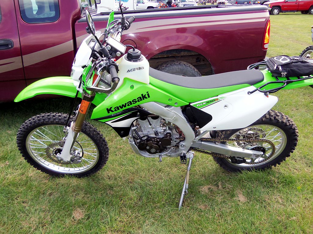

Something like this, maybe?

Well, except for the missing 6th gear, lol.
Mine has a 3.4 gallon Acerbis tank, full Baja Designs dual-sport kit, the seat has been cut down 1", the forks shortened 1", and Devol lowering link in the rear. I only have a 30" inseam, and 38" seat heights don't cut it for me. I can plant the ***** of my feet pretty easily with this set-up.
Here's the thing about the KLX450R. With the gear spacing it has, you have 2 choices. Gear it down for tight trail riding, or gear it up for the highway. There isn't a lot in-between, and you can't have both at the same time. Mine is geared lower than stock for single-track and tight trails, but on the road, it's really unhappy at any speed above 50mph. Sure, it will probably go 75mph as-is, but you'll turn 13k RPMs to do it. With the stock gearing, 1st was good for 30mph, and 5th would probably top 100mph - great for the desert, but not so much for east-coast trails. A decently spaced 6-speed transmission would make this bike so much better.
It's an awesome off-road bike, and I keep as such. I only got it street-legal so that I can connect the trails and ride the organized dual-sport rides. The power it makes is downright addicting.

Very nice. We did you get it? California won't allow you to plate a dirtbike. It's gotta be a factory dualsport. No way to register it and get plates out here.

Thanks. It's a 2008 that I bought new in 2010 as a leftover. In Pennsylvania, there is a process to plate a dirt bike. It's not all that easy, but it can be done. However I learned that all KLX450Rs came with a MSO that says "Motorcycle" instead of "OHV" or "For Offroad Use Only", just like KTMs. When I got my title from the DMV, it also already said "Motorcycle", so all I had to do to get a plate was apply and pay for it. I needed the dual sport kit to pass inspection, and then I was good to go.
