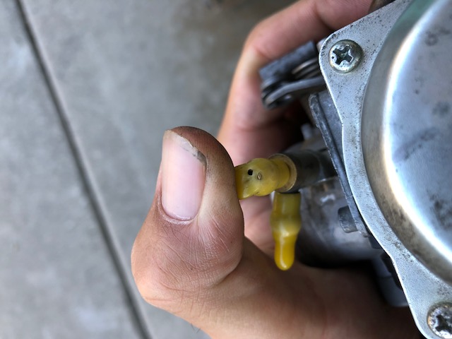

I went back and dissembled the carb and installed a new float. Set it at 17mm. I checked the valves I covered up and it looks like the vinyl was too thin and ripped. I replaced it and threw the carb bike on. Installed the K&N. Gave a test run and the bikes performance increased a ten fold. I no longer had the 8000rpm cap. Bike pulls hard post 6000rpm. Definitely feels like a new bike. I love it.
Thanks again for your support and guidance.
And for reference, I attached an image below of the ripped valve covers.
Til next time!
