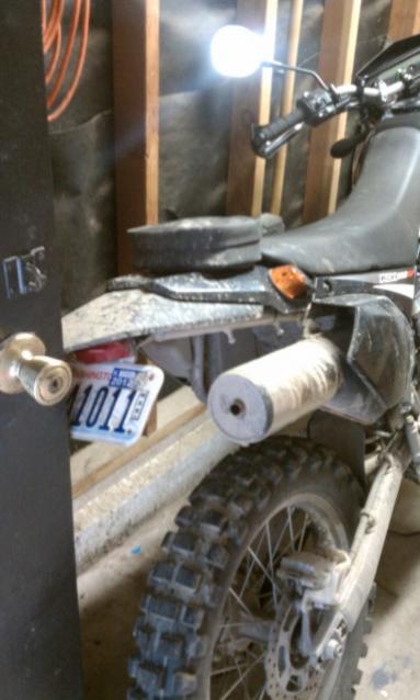

Well for those of you that want to install a kickstarter on your 2009+ bike I have found a problem. I have a kickstarter on my bike. It came that way from the dealer. You can search for the install pics and part numbers on this site to find a couple of great write ups. Those installs were done on the old 2006/2007 model bikes. The footpeg mount is different on those bikes than on the 2009 model as I just found out, the very hard way.
So I bent the hell out of my footpeg mount in a desert race last month. Ordered a new one for my 2009. The new one arrived today from Babbits and is much different. The OEM 2009 peg does not allow the kickstart to travel down. It sits much closer to the engine.
Check out the pic.
So can someone please verify for me that the 2009+ bikes use the close mount foot peg mount? I am going to have to order the 2007 peg (same part # as the klx300) now. I can see in the pics that the dealer installed the 2007 peg mount on my 2009.
Also included a pic of the flush mount Baja Designs blinker I installed to repair another bit of crash damage.
