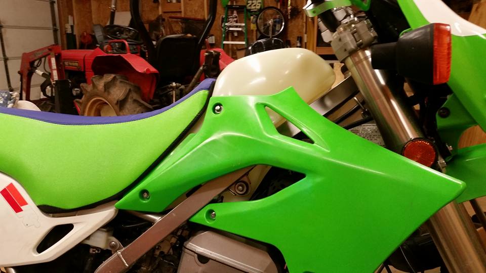

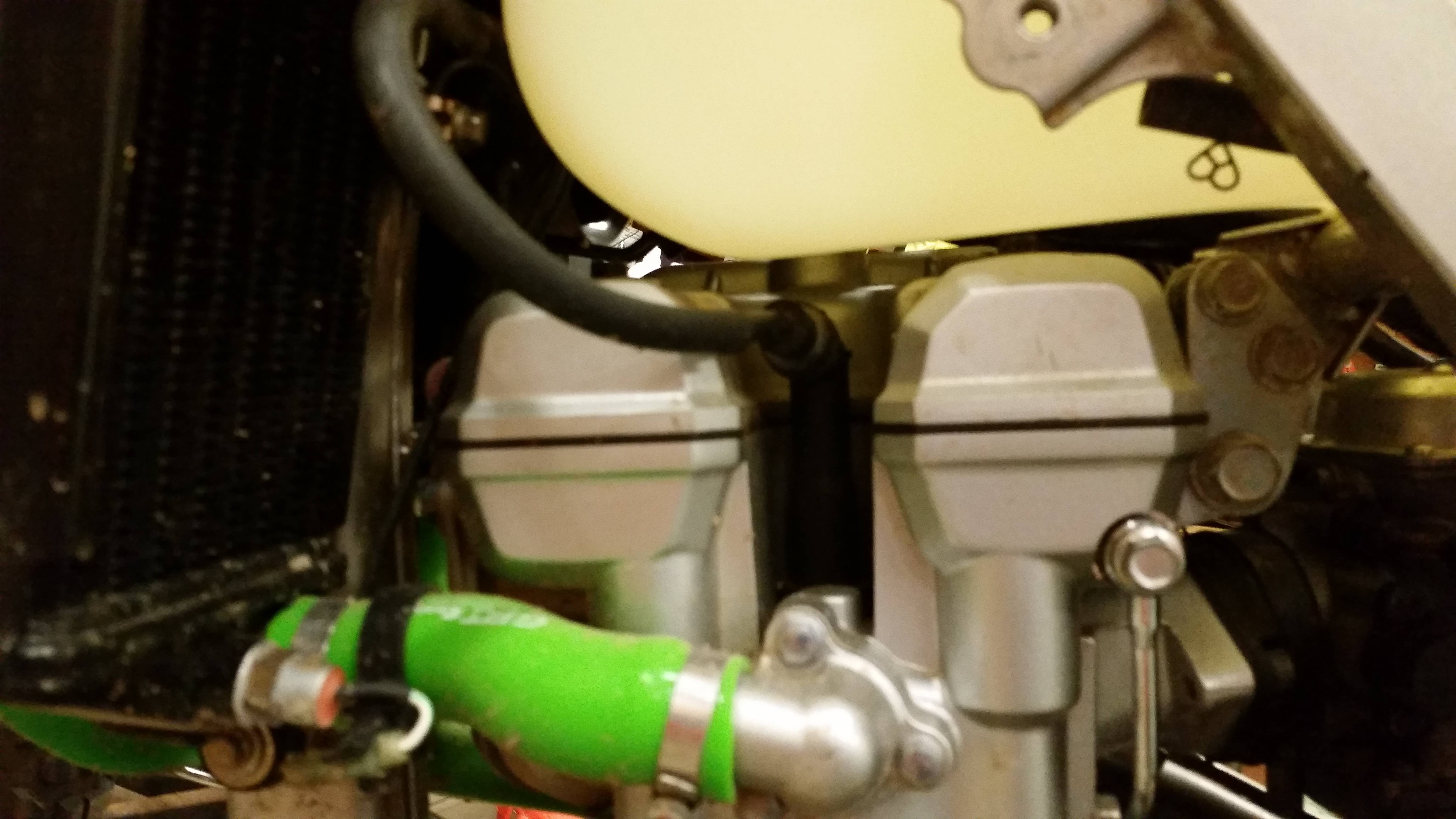

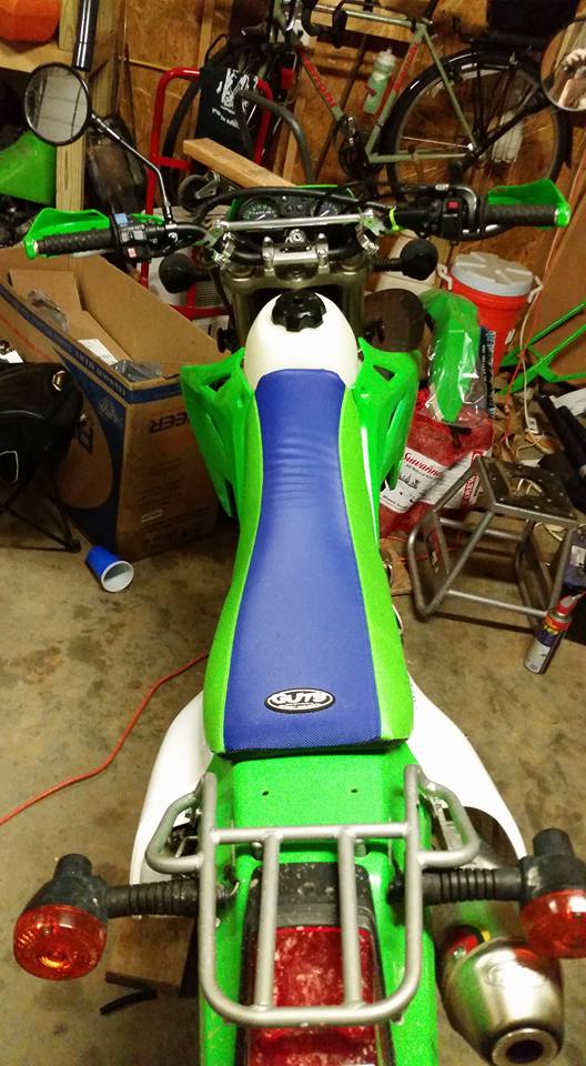

Installed the Clarke tank today:

Old Jul 7, 2016 | 11:14 AM
Dash8's Avatar
Joined: Jul 2015
Posts: 302
From: Milton Ont Canada
Originally Posted by Ruggybuggy
Unfortunately the IMS tank isn't available for the 2008 and older bikes.
Ah. Scratch my post then lol
Looks good tho!
