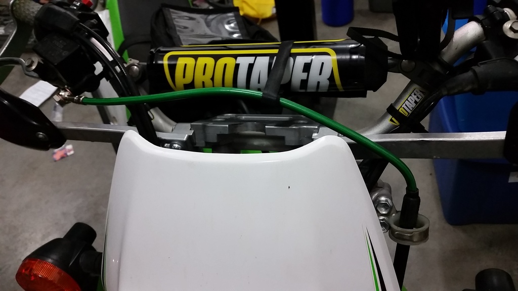

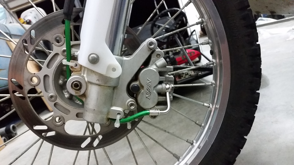

So you have an angle bend on the other end too?

Do I have it backwards?

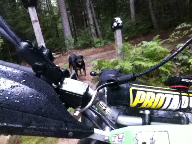

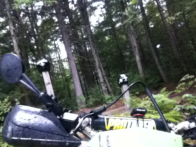

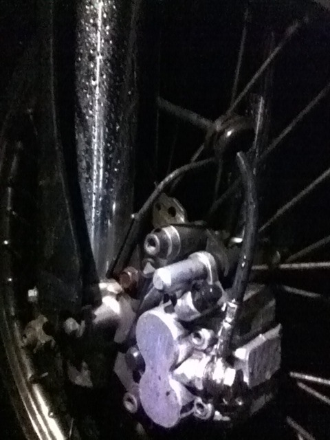

Mine is mounted the opposite of yours drm.

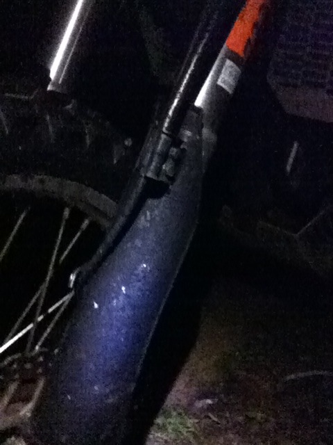

The bottom is mounted exactly like the OEM...sorry no pics, it rained 3" tonight.
That looks very vulnerable to me...a rock could take out the 90º bend too easily.
Rain stopped for a minute, let me see about a pic.
OK, got some crappy pics.
And up into the fork guard tab and into the clamp.

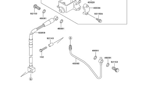

2007 klx250s and 300 parts diagrams are attached
Attached Thumbnails 2006/07 KLX300 Brake lines on a KLX250S?-2007-klx250s.jpg   2006/07 KLX300 Brake lines on a KLX250S?-2007-klx300.jpg
