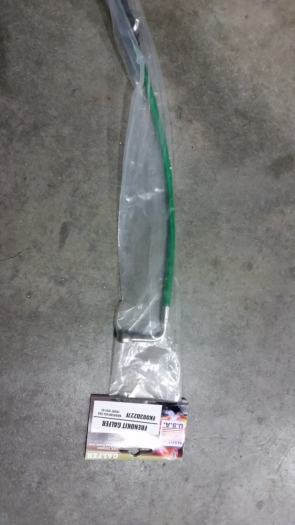

OK, I got mine.
The rear was an exact match.
The front was not. Mine came with a 90º bend at the master cylinder. I mounted it fine, but I'm curious if it is the wrong line. It's way too long, even for a 300, the loop goes way up and over the instrument panel...works great though.
I'm going to call and see if I can replace it for a nominal fee.
Old Aug 25, 2015 | 12:55 AM
drm's Avatar
drm
Joined: Jul 2011
Posts: 552

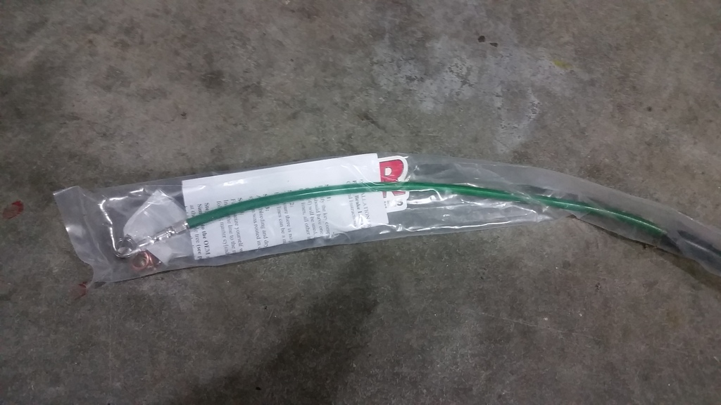

i received mine too but havent tried to mount it. Can you take a pic?
My front has 1 90deg bend for what I assume is for the brake caliper. It is 63" long including the bend.

Old Aug 25, 2015 | 01:22 AM
vlodpg's Avatar
Joined: Sep 2007
Posts: 325
From: Fairfield Cnty CT
Any close up pictures of the mounting?
Old Aug 25, 2015 | 02:39 AM
MaximusPrime's Avatar
Joined: Mar 2012
Posts: 1,266
From: WMNF, NH, USA
I'll get some pics tomorrow, as well as a measurement. But it's just like drm's.
I mounted it with the 90 pointing upwards, after an initial level mount and gravity bleed with the bottom of the hose disconnected. Once bled through, I pointed the 90 upwards and back towards me. It looks totally stupid. I mounted it with the lower clamp loose and the hose not routed through the fork guard tab, once I routed it properly I realized the length issue.
My real question is does the KLX 300 really use this line? Does it mount in a different spot on the master cylinder than the 2009+ 250? Seems unlikely, but certainly possible...
As seen with others trying to swap brake parts between models.
I made it work, it will last until I get a replacement or it gets caught on something.
You'll see what I mean when I get a picture...

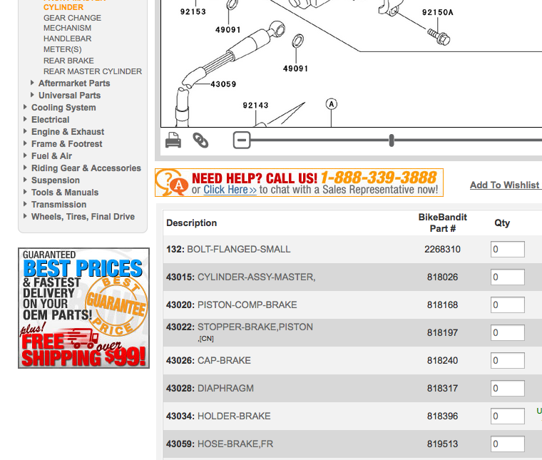

I thought that too, but the casing is on the bottom of the hose and it even has a nice extra rubber piece to fit in the fork guard clamp.
They work great, even if not completely correct.
Curious to see what they say.
I need to find a part diagram that I can take a screen shot of to compare 250 and 300 parts.
Found it. It's the wrong fitting for sure.
Screenshot is from Bikebandit's listing for OEM brake parts for a 2007 KLX 300. Notice the straight fitting?
