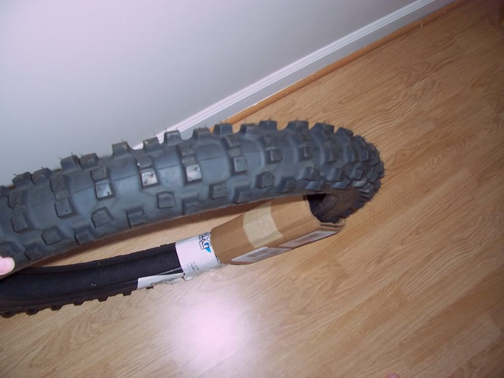

One more thing... Here's the tire I ordered today. The tire in my desired size was back-ordered for quite some time so I'm happy to finally have it being shipped. It's a Pirelli Scorpion XCMH 110-100. A 100-100 is too small and doesn't offer the traction the bike deserves for its weight but a 120 would be a bit to big for a stock KLX when considering street accelleration with a stock 14 tooth front sprocket IMHO.
I've looked over countless tires to find a satisfactory compromise between on/off road tires that are DOT certified. Hopefully this tire will be the best match. Below is a pic of a Pirelli XCMH front tire that I bought awhile ago but was waiting to install for this season although it looks to be a bit too aggressive for the street, only one way to find out... Also, I have included a link to a pic of the 110-100 XCMH rear tire so you can get an idea of the tread pattern. It's not as aggressive as the Trackmaster but also not as close and restrictive a tread patter as the Kenda K270's or the stocker. The stocker is indeed crap.
