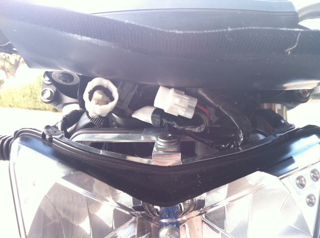

got mine installed
5 min install, 5 min to figure out how to program (kind of hard) only because you have to jump around on the instructions
set mine to -11%
dead on to my gps at all speeds, fast or slow
so im happy works great
took some pics
after removing the headlight shroud only
Just happens the white connector you tap into was just sitting right there

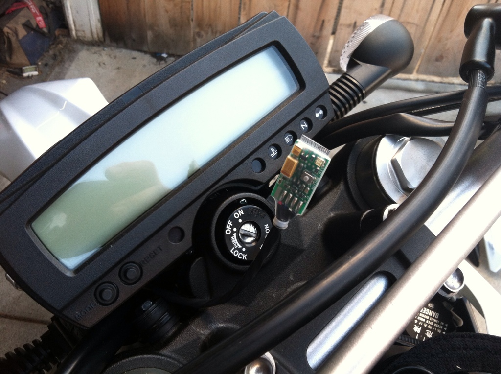

after that you can just close everything back up
I left it loose incase I needed to readjust it
then I tucked it under the black rubber cover over my gauges and I can access it any time

Exactly what I did... sits under the water-proof flap, safe and sound.
