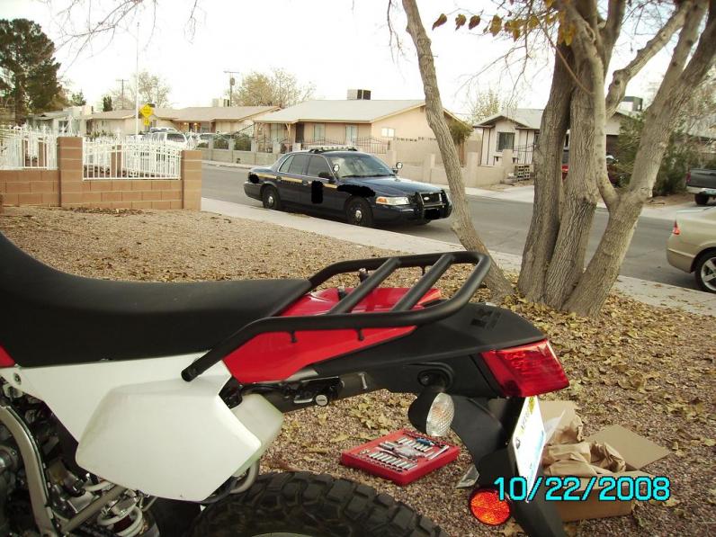

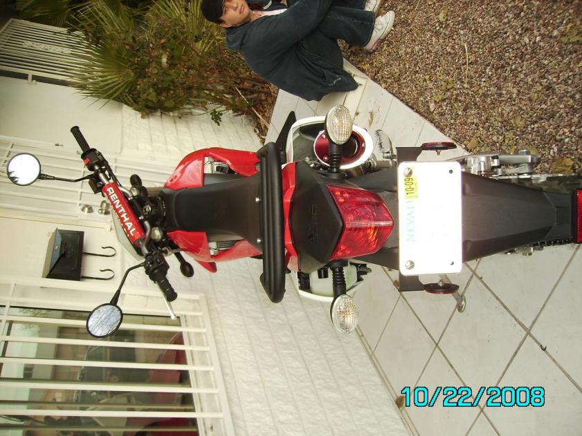

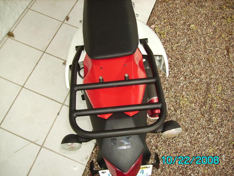

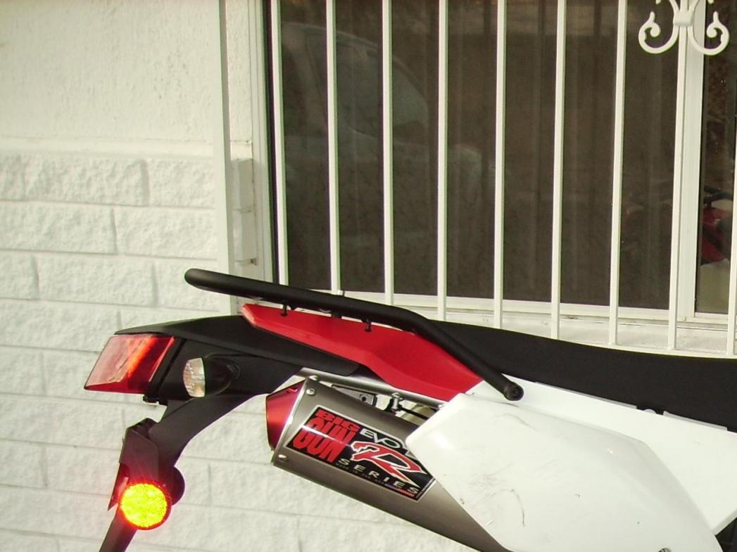

I just put on the rack from ebay seller Sr8dirt. It only took a couple of days to get here, however I have been a little lazy lately and it took me a few days to getting around to put it on. Instal took only about 5 minutes. All you have to do is remove the two seat bolts, slide the rack on, replace the bolts, and add the two bolts to the rear two holes oin the fender. They supplied two approximately 1" spacers to put under the tool bag to raise it. I bought the bike used, and the previous owner removed the tool bag.
Overall, the fit and finish of the rack was very nice, with good welds.
I am tring to figure out how to upload photo's, however I cant figure it out.
On a side note, I also just installed a Big Gun Evo exhaust and a Dynomax jet kit. The bike sounds great and runs 10x better. The only problems are the rear footpeg slightly rubs when folded down, and I need to get a heat shield! Not to say I just burned my pant leg, but.....
Old Jan 3, 2009 | 02:48 PM
john103's Avatar
Joined: Dec 2008
Posts: 26
From: Las Vegas, NV
Okay, I think that I have this whole picture thing...
Attached Thumbnails 09 rack-img_0007.jpg   09 rack-img_0009.jpg   09 rack-img_0010.jpg   09 rack-img_0011.jpg
