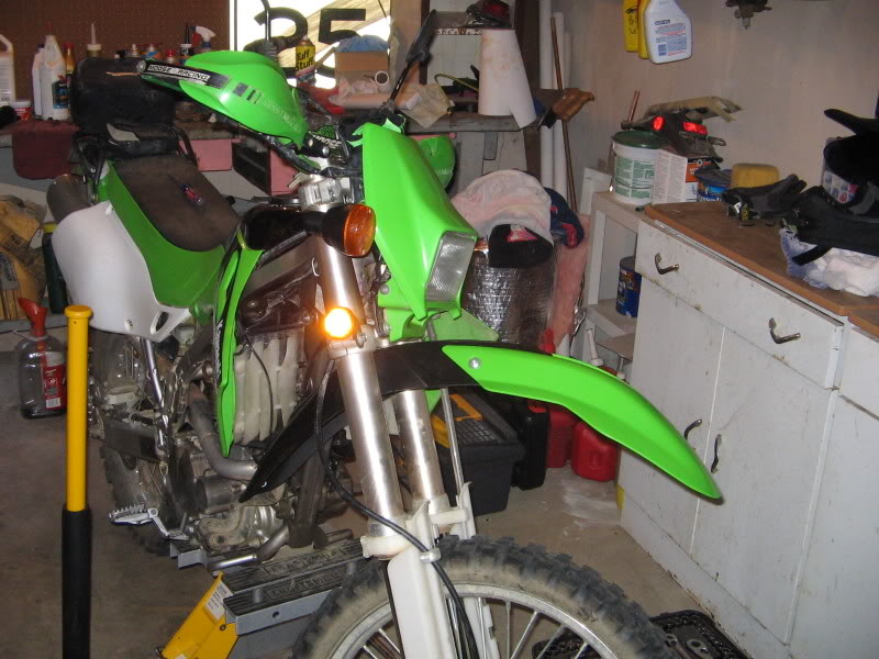

acerbis fender!!!!!

Old Dec 10, 2008 | 09:47 PM
f1rocco's Avatar
Posts: 258
Originally Posted by Yossarian
I thought I read on these forums that due to the softness of the front fender it is very susceptible to movement at higher speeds (more wind). I ride my KLX on the interstate and I experience the same thing at times. Isn't that why there is such a thing as a supermoto front fender, they are made of a harder plastic and don't warp at high speeds?
Yup agreed....
I changed my front fender and never had a wobble since...
Rocco
