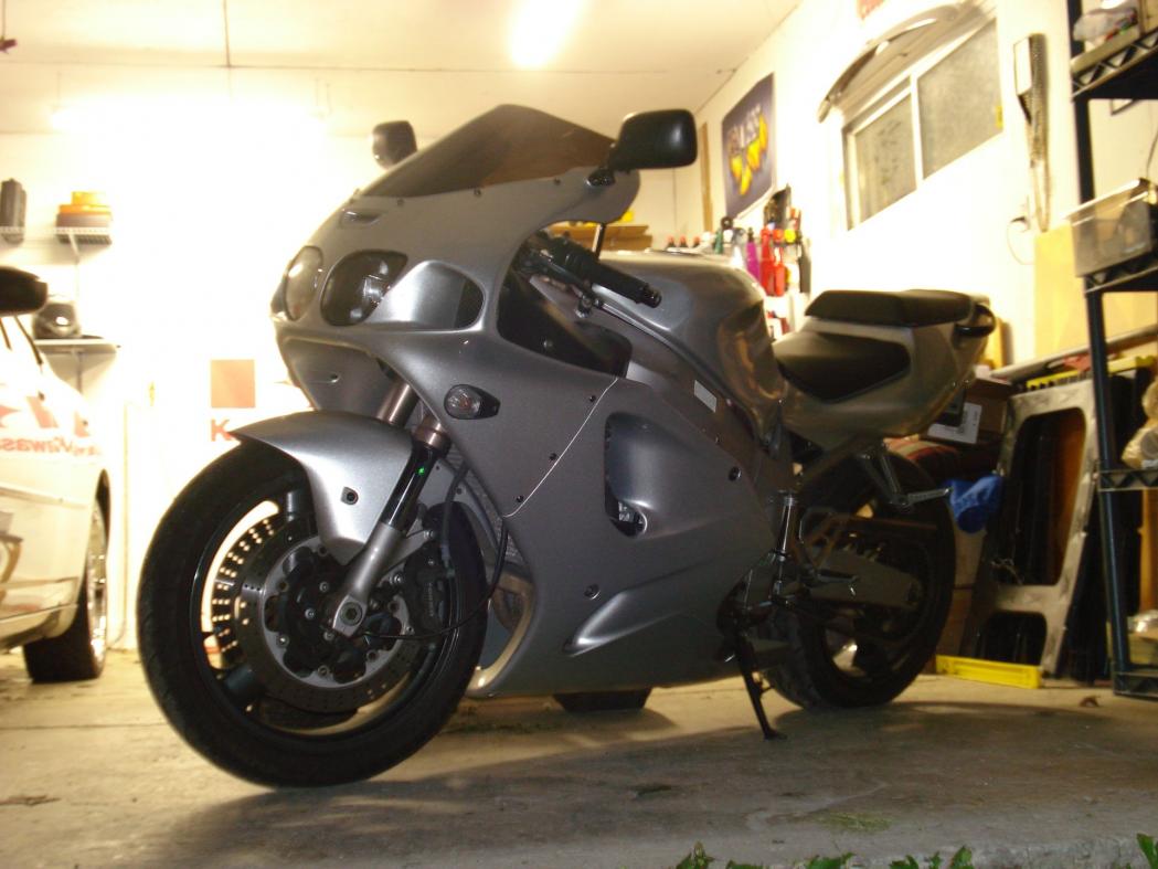

And here she is put together... (pic from last Fall)
