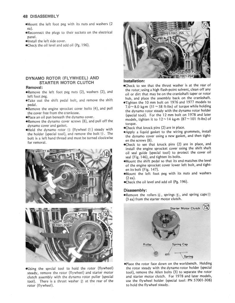

The starter motor looks fine
A few folks have mentioned the starter clutch
Unfortunately, according to my Clymer Manual, to get to the starter clutch, I've got to remove exhaust system, oil pan, clutch assembly, oil pump and secondary shaft
There has got to be a better way!
Old Aug 21, 2009 | 07:45 PM

Old Aug 21, 2009 | 07:47 PM
As you can see, most of what you mentioned can stay on the bike in reference to your suggested checks. Good luck.
