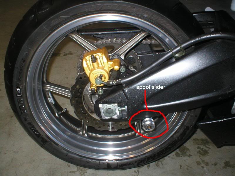

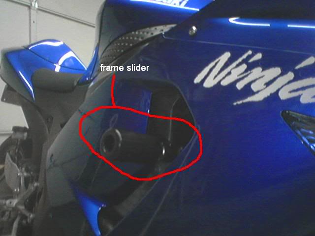

look in my photo gallery at my bike. The front gold ones sticking out (right below my handle bars) are called frame sliders.
spools are on the rear swingarm (mine also gold, i think) are mainly used to lift the bike with a rear stand, but also provide some protection.

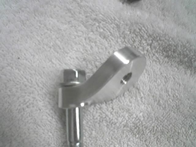

like gr said they are worth every penny....here is an example of what go where
frame slider
spool slider

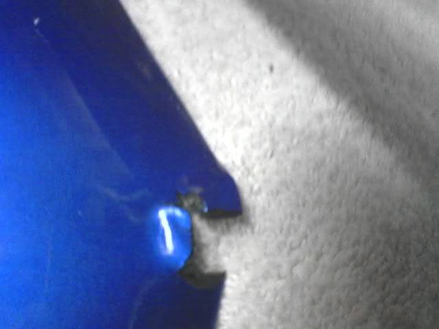

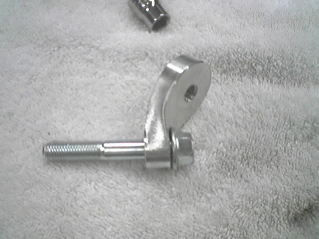

let frogger show you the pics of a 'no cut' slider and youll see what i mean. the ones that solid mount to the frame will protect the bike and on some aplications 05-06 636r's you need to cut the plastics in order for the slider to mount.
see how i had to cut my plastics for the slider and base to solid mount to the frame
Old Jun 18, 2006 | 06:08 AM
frrogger1's Avatar
Posts: 1,033
From: bay area
Default RE: Slider vs Spool - Difference

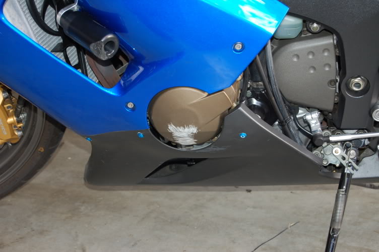

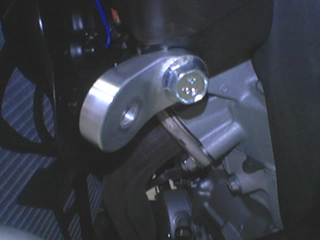

this is what the mo cut bracket looks like after a slide.....note i was only going about 5- 10 mph when i droped it.....i was luck that the slider bracket bent out instead of in or worse snapping off....here are some pics of the no cut slider and the damage the slider caused my fairing
on this last one notice that the slider is not straight
