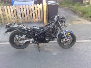

Hia all, i have recently bought 2 80's gpz600r 's with the hopes of making one good one out of 2.
the first i bought is a 1989 f reg which was a non runner, the previous owner bought it as a non runner as a project but abandoned it,the engine turns but does not start, it had been dropped on its left hand side. i gave him £200 for it. from what i can see the exhaust studs have sheared, all the fairings are off but complete and undamaged.the exhaust is there but badly scraped

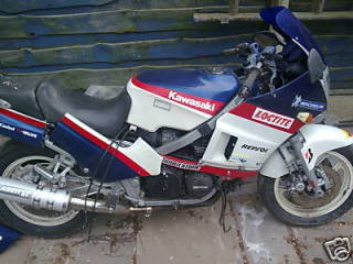

the second one is a 1986 c reg which i bought off ebay for £200 as a non runner mainly as a donor because the exhaust and tyres made it worth its price, this one was a daily commuter at its former home until the engine suffered a problem, the previous owner said the "top end bearing" had gone and he has attemted to repair it but i think he got in a little over his head and he ended up buying a honda (traitor)

i would appreciate any tips and advice you can give me as i would like to get 1 good engine out of the 2 bikes.

I'd probably begin by getting the '89 motor running or finding out why it doesn't. No reason to do surgery if you don't have to, even if you have spare parts.
Then, start disassembling and label everything (what part, what bike, etc.) Compare the parts for fit, condition, etc. Choose your frame, sub-frame, suspension bits, and engine components, depending on how the engine issue comes out. "Measure twice, cut once," (compare the desired parts for function and fit) and reassemble.
