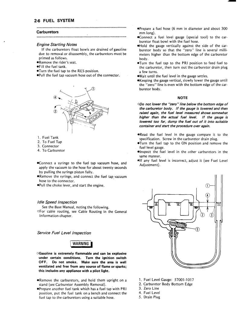

First thought is improper fuel level adjustment. I would back track and check that first.

You had new floats installed. Guessing that with possible improper float height at 4000rpm lets say for 5 miles, maybe one of the floats is not filling properly to maintain that. Cuts out, sputters and you pull over. Does it restart after you end up stopping?
edit: I take it that you do not have your manual just yet to adjust your float height. Give me a few minutes then for pics.

yup, I get that way after 2 days. (Sometimes it is faster to take your bike to the professionals.)
edit: I am not a pro, I just tinker with bikes. good luck though. Service Fuel level is .5 +/-1mm above the bottom edge of the carburator body.

it is its at a bike shop and they cant figure it out hey i fould this would it matter?
Tilt just enough to touch and close the float the float valve, but...
Do NOT compress the float valve spring when measuring (only exception is 95-97 zx6r)
