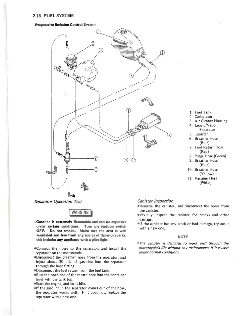

i have three lines off the bottom of the gas tank and none of them are pluged into anything two of them go into a caly emissions set up but there return lines that are unpluged where do i plug them in if i dont have the camy emissions parts there is 2 places i could plug them in but aint sure there off of the top of the carb'sand if i had the emissions part thos get pluged into the top of the carbs my question is can i just plug thos lins on the top that are just hanging there and are fuel return lines any help anyone

there is a line that is a fuel return line that is not hooked up i think i know where it goes but not 100% sure. the manual tell you crap its more of a basic guide than anything i have one same one the factory uses and its not helpfull for nutin and i have ben looking high and low online to find stuff on it but cant so any bit of advise help thanks zbike

Ok, The carb should have a fuel line which goes to the petcok and a vacuum line that also attaches to the petcock.

For the life of me, I can't remember where those lines go. lol...If you have deleted the KLEEN system, 2 of the lines will be vent lines (one being an overflow)
81 miles to a tank of fuel is def a huge problem. Are you sure u r only getting that mileage? If you are basing that on the factory odo, have you checked the acuracy of the odo? It's a 5.4 gallon tank on the B series. That is only 15 mpg. Still have stock air cleaner box and filter? Still have KLEEN system? Factory jetting on carbs? Have you checked caliper drag? bearing drag?
I can look this weekend and see exactly where those three lines go on mine. I have deleted the KLEEN system tho.

84-2003 gpz 900 pic which may help ya out. Good luck.
