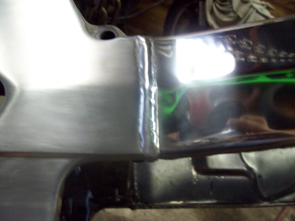

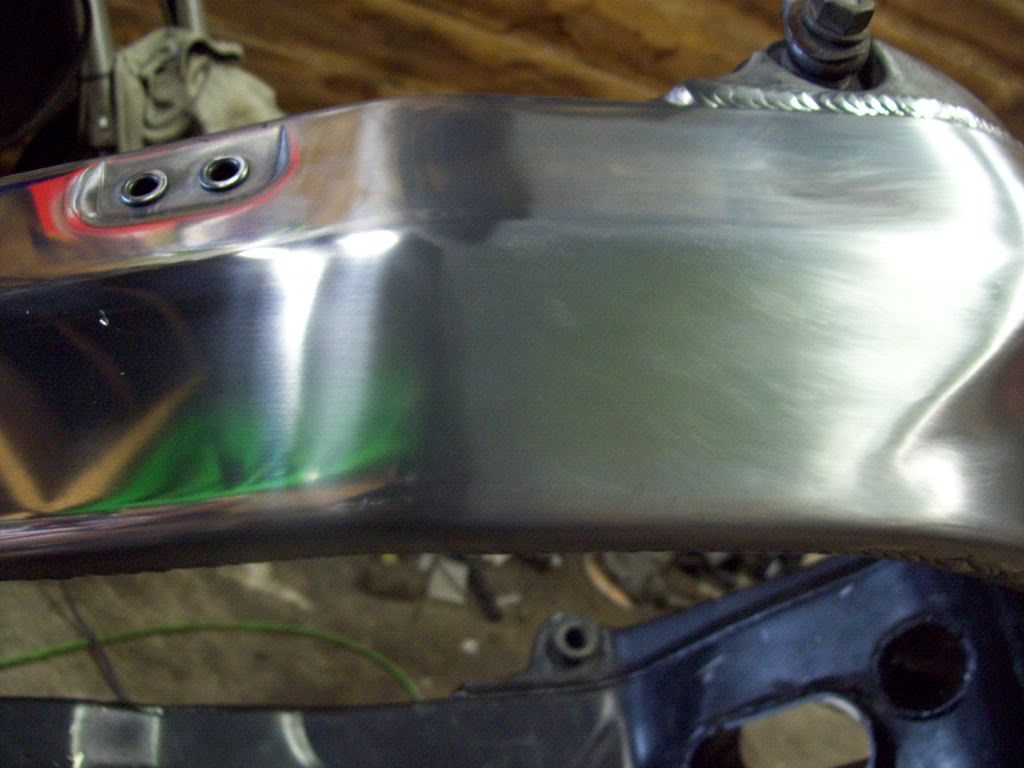

a solid honest month of sanding and polishing. a MONTH.

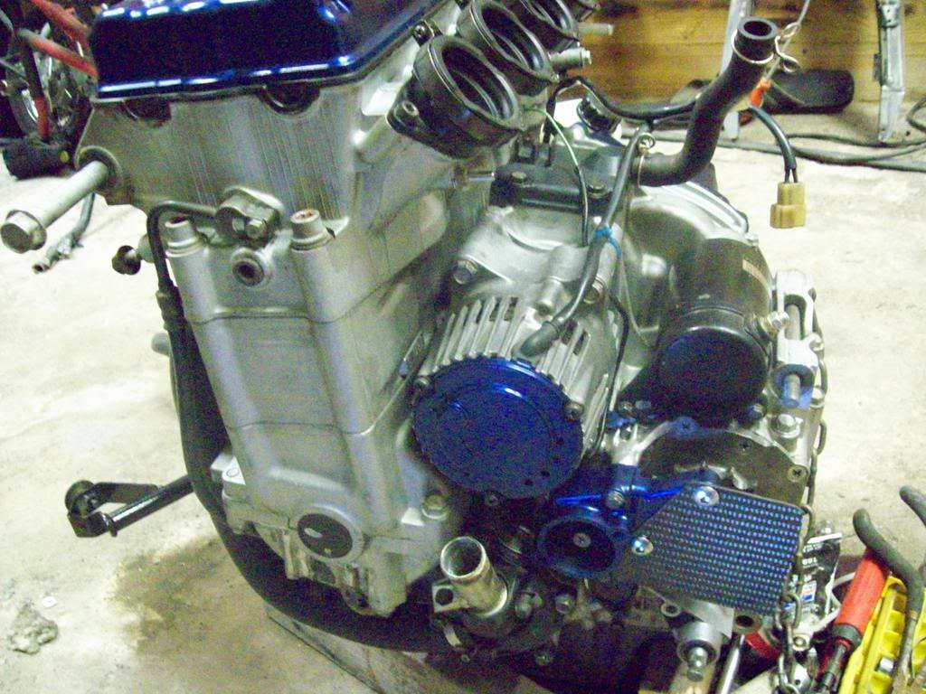

freshened the motor up a bit

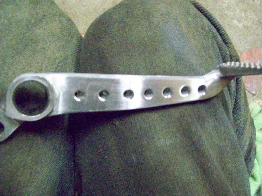

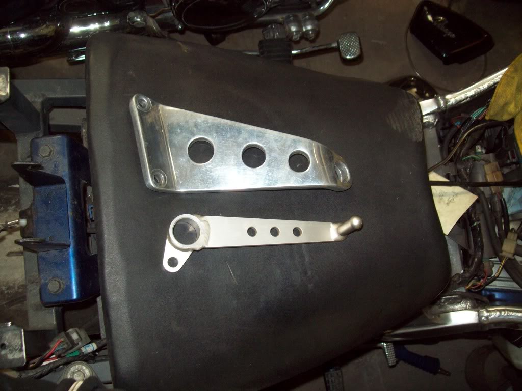

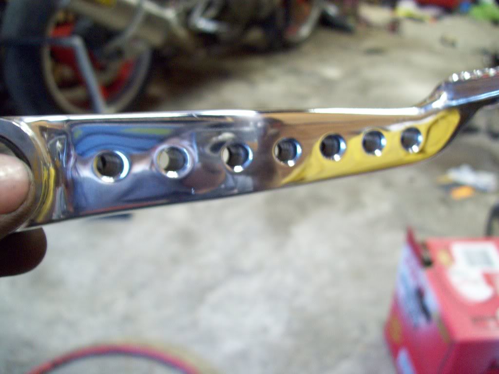

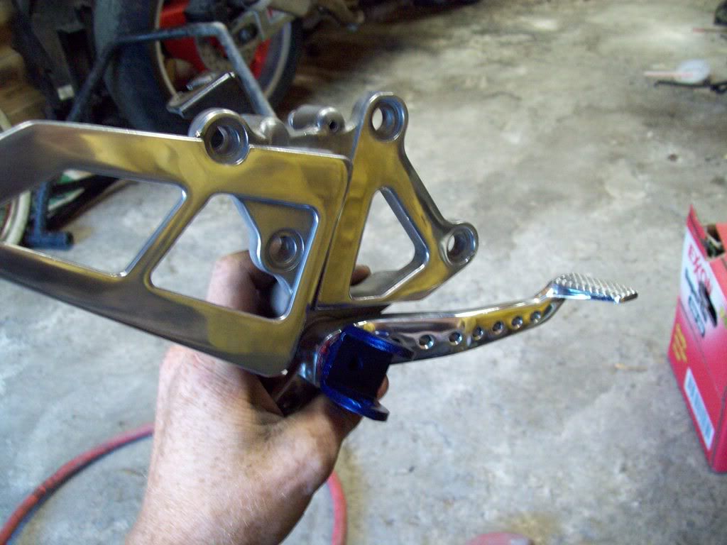

drilled the pedals out on a CNC. made a shifter cuz i never had one.. shifter was a manual lathe deal.
making the shifter.. 6061-T6511 1.00" roundstock turned down to i think .690" or something goofy like that. knurled, grooved and tapped on lathe. think it took like, 15 or 20 minutes.. love getting paid to make parts for my bike. .lol

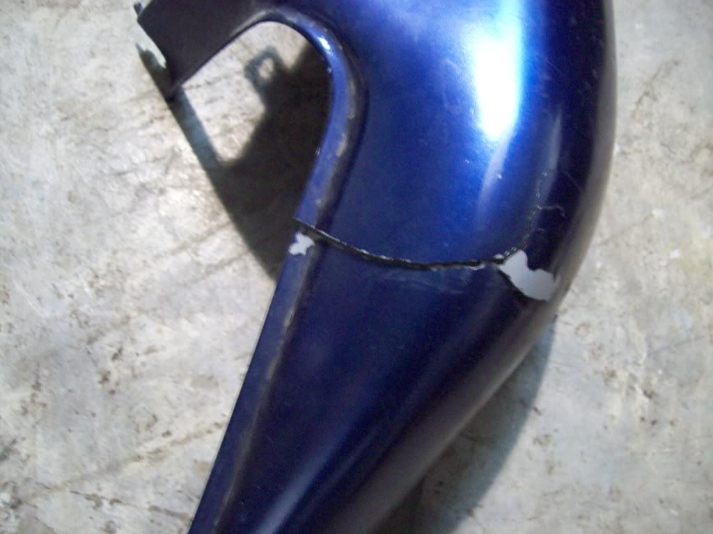

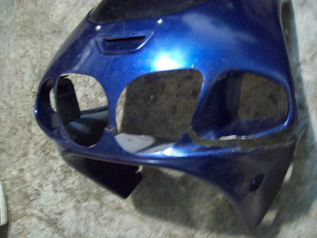

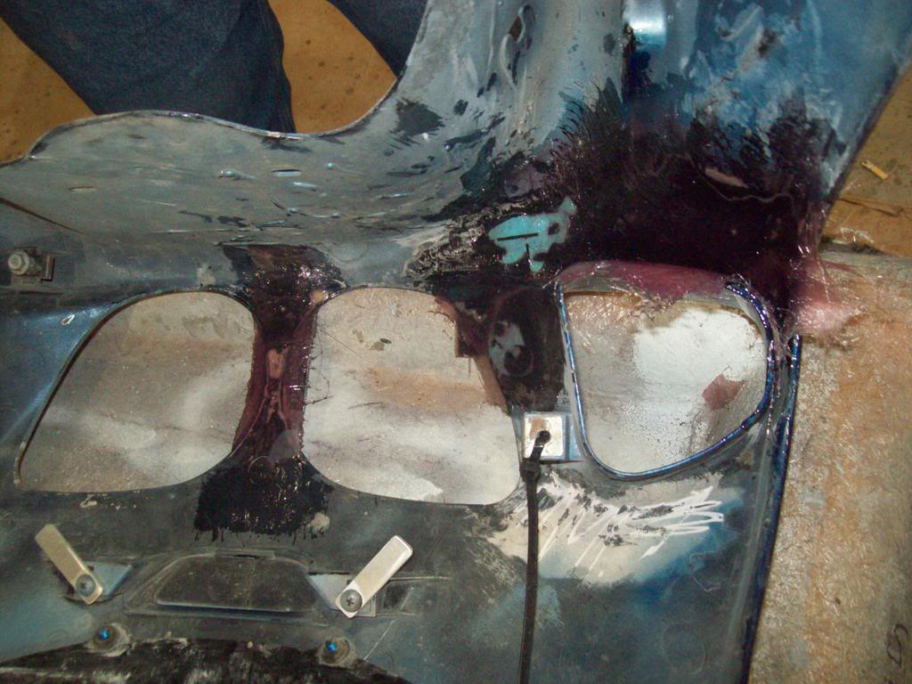

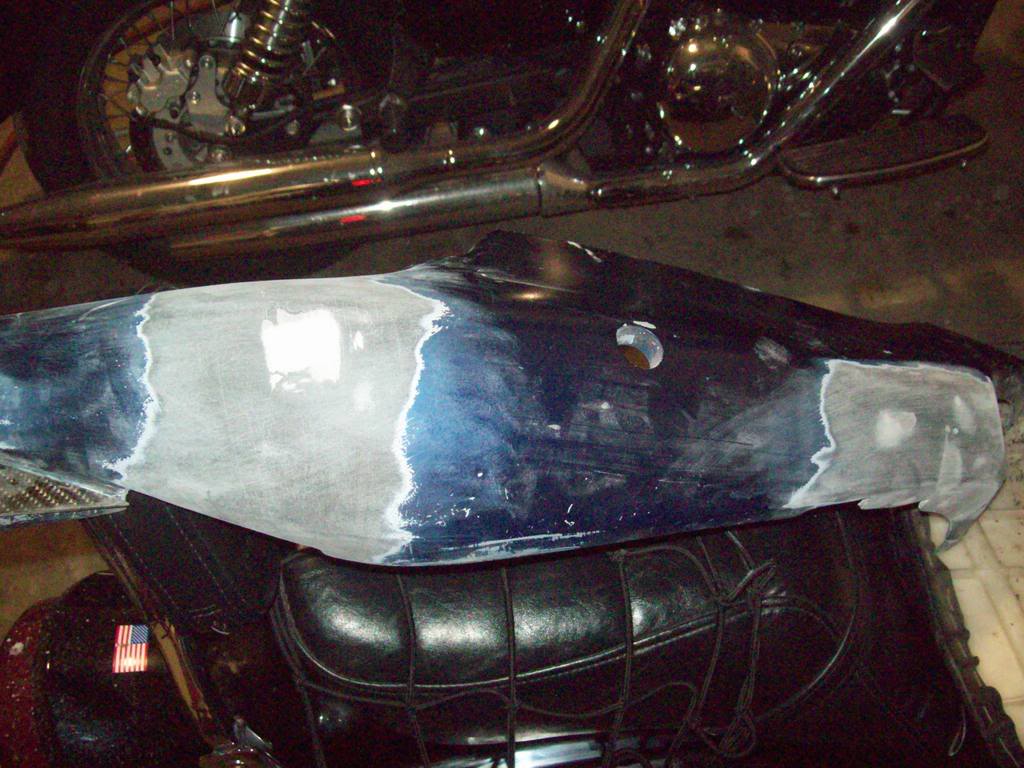

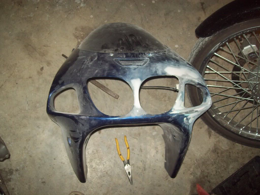

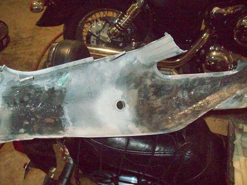

plastics were pretty beat.. massive repairs were done thanks to Rod n Race fiberglass who was, at the time, right next to the shop. pics of mintyness in a while..

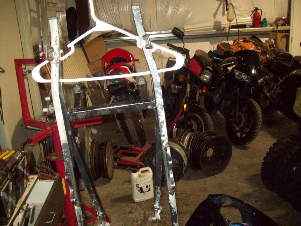

painting subframe

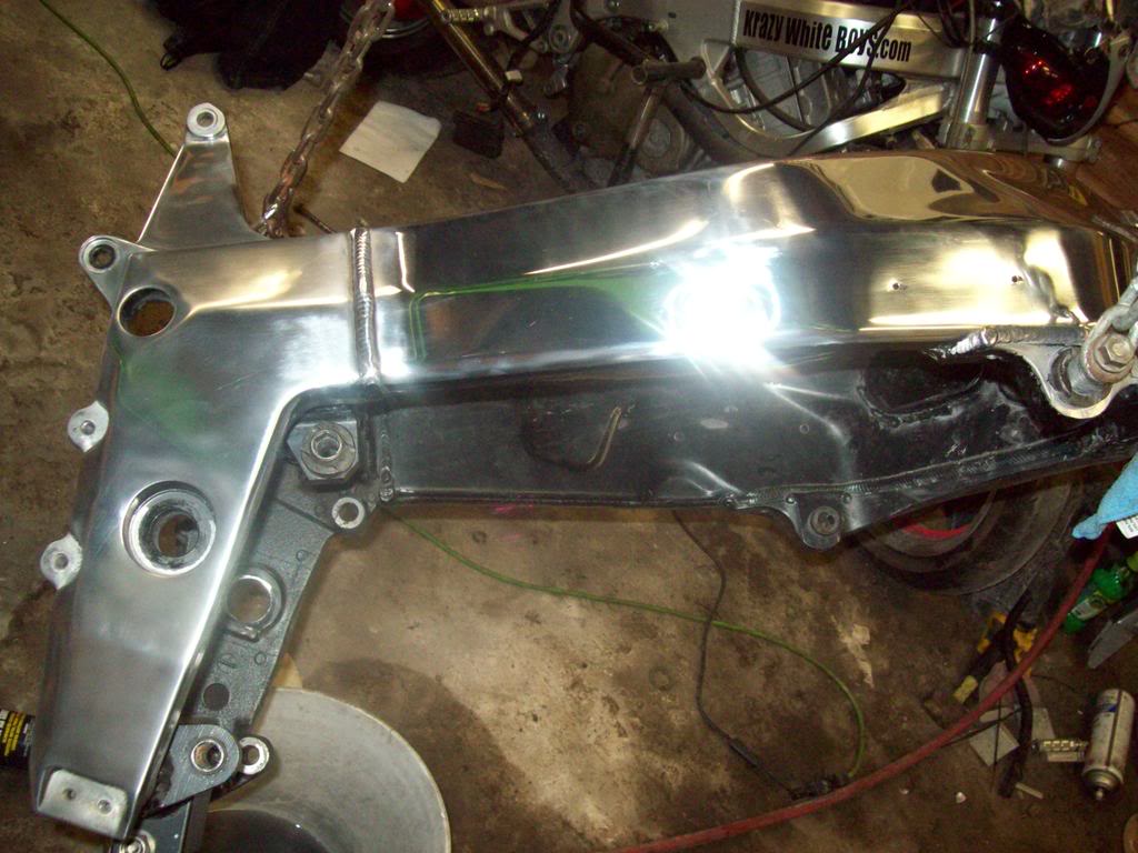

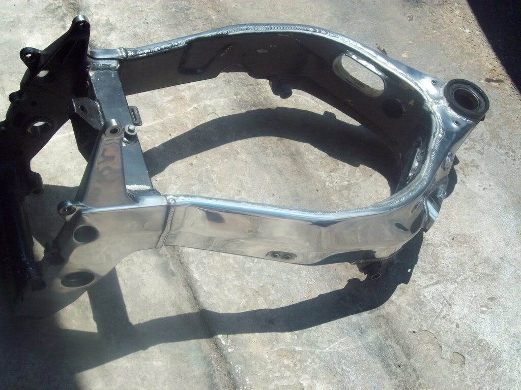

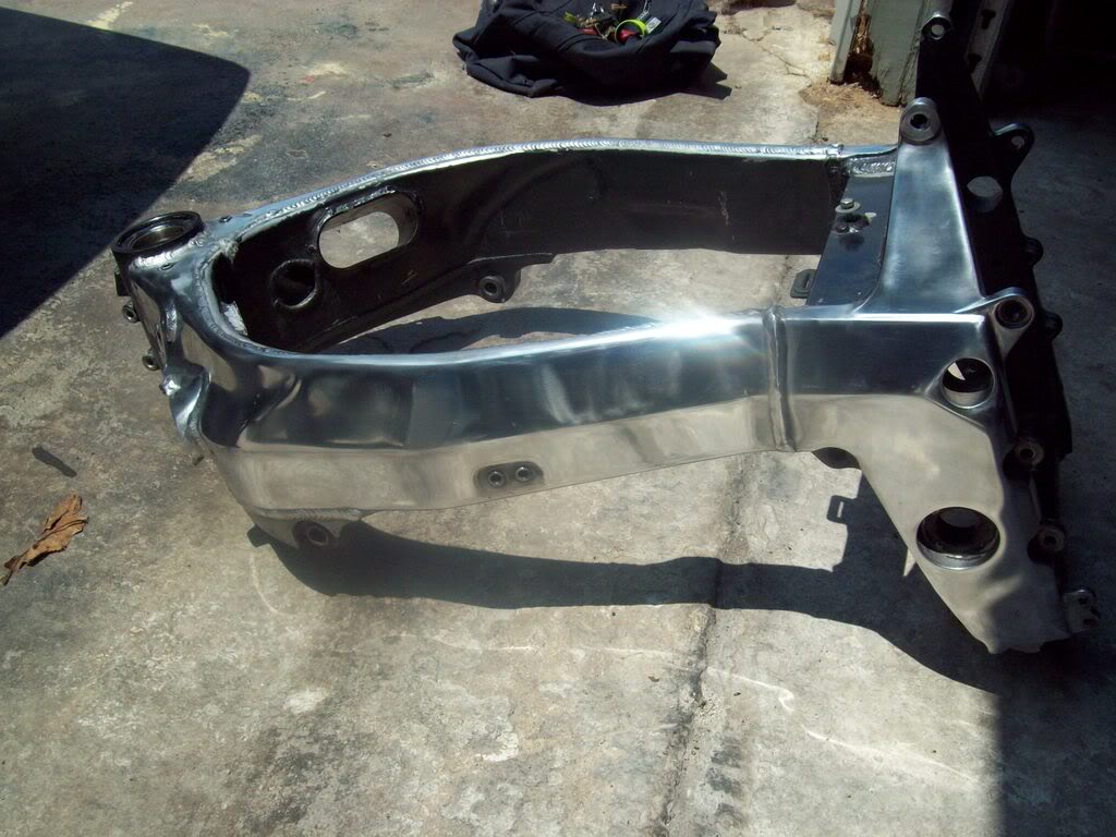

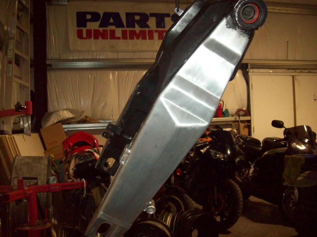

pressing swinger for paint and polish

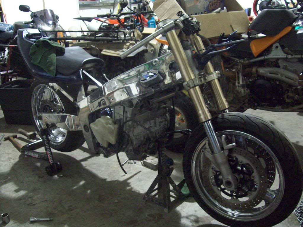

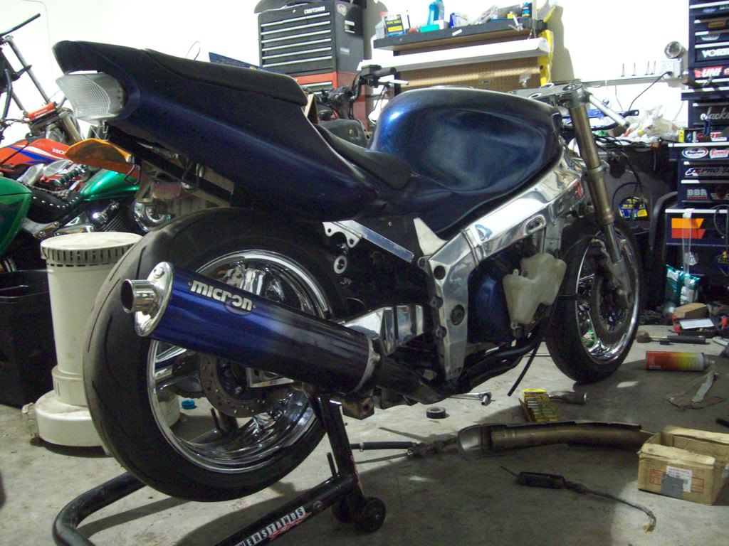

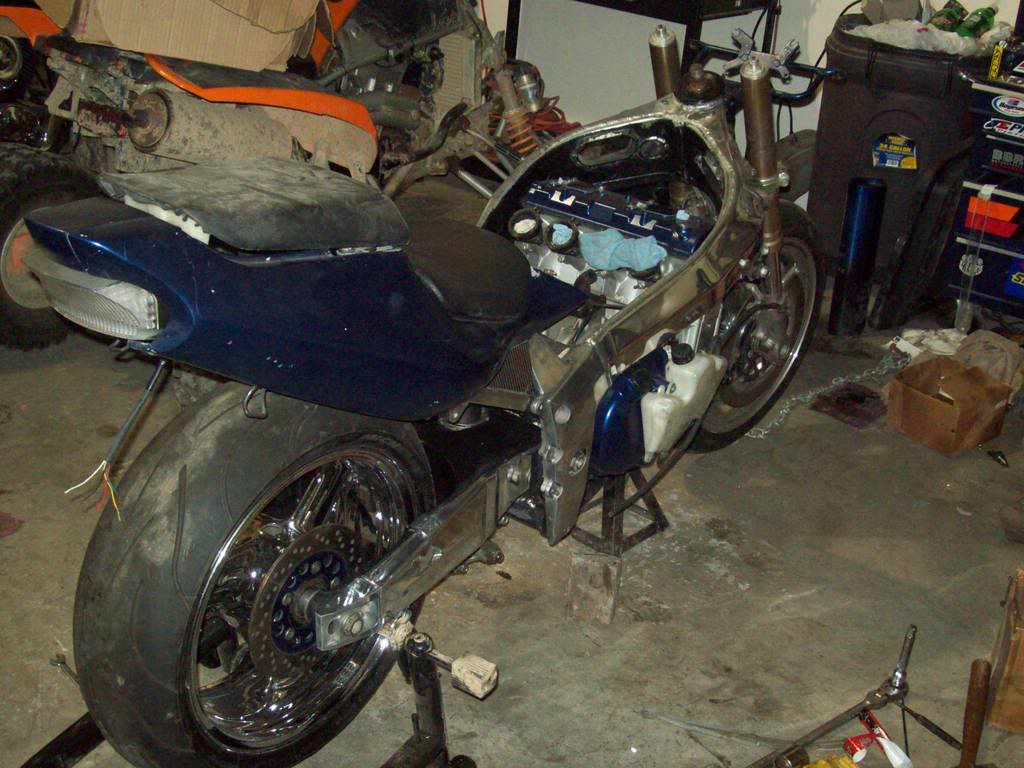

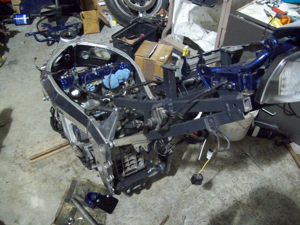

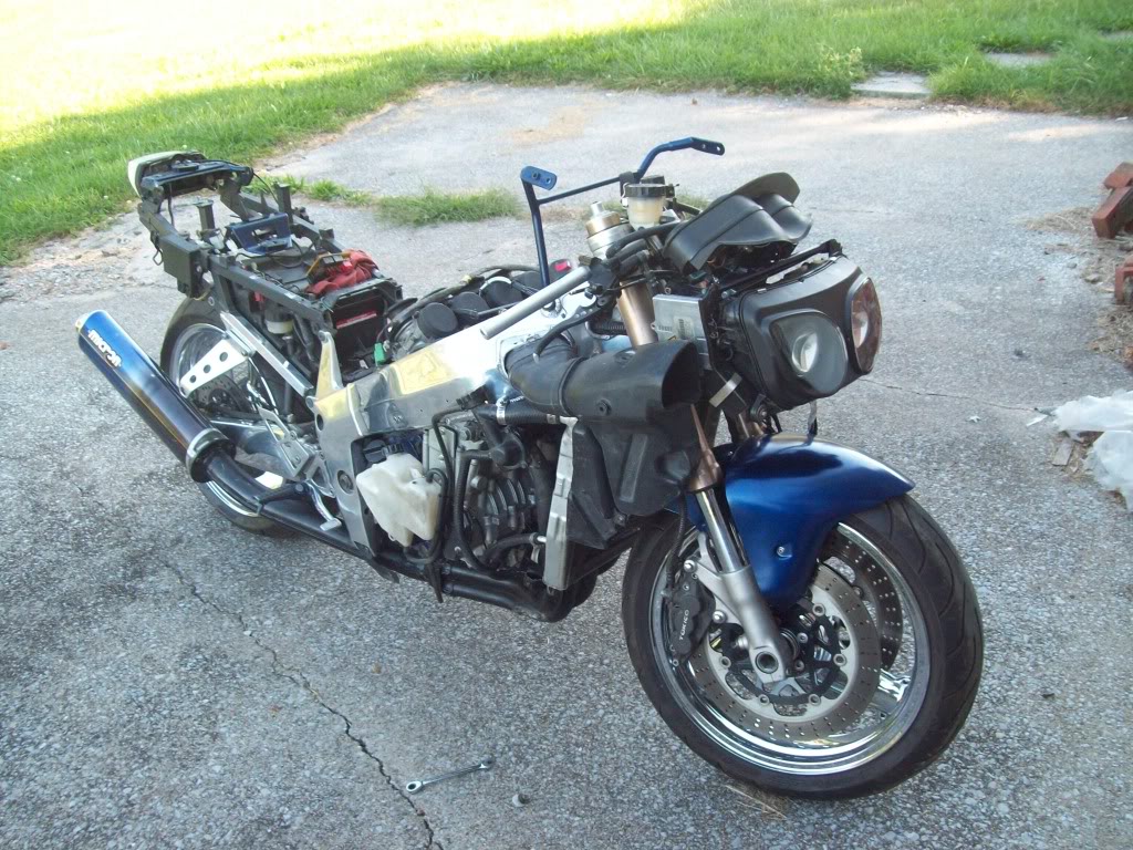

start of assembly
temp subframe fitment to make sure everythings kosher
minty

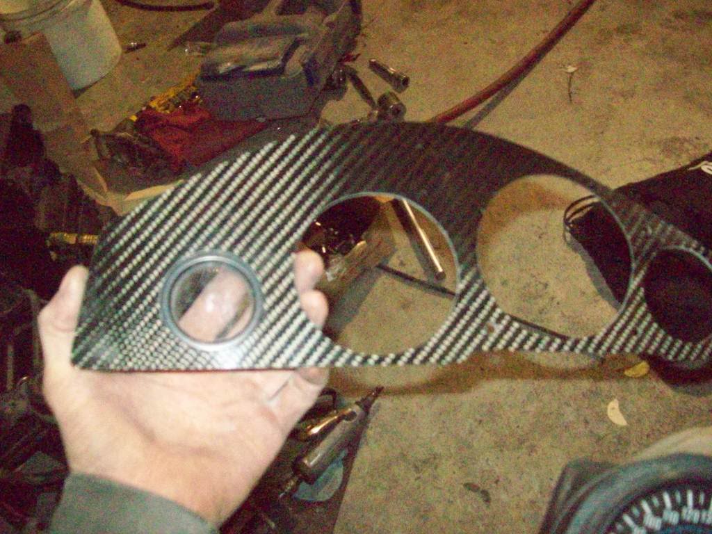

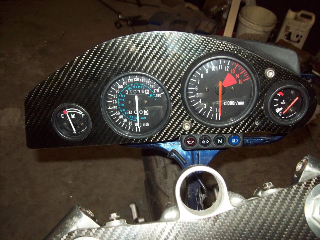

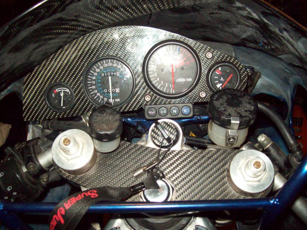

finally got that damn CF dash done..lol

old dash
new dash.. yes.. i probably have the worlds only 7-R with a gas gauge.. lol

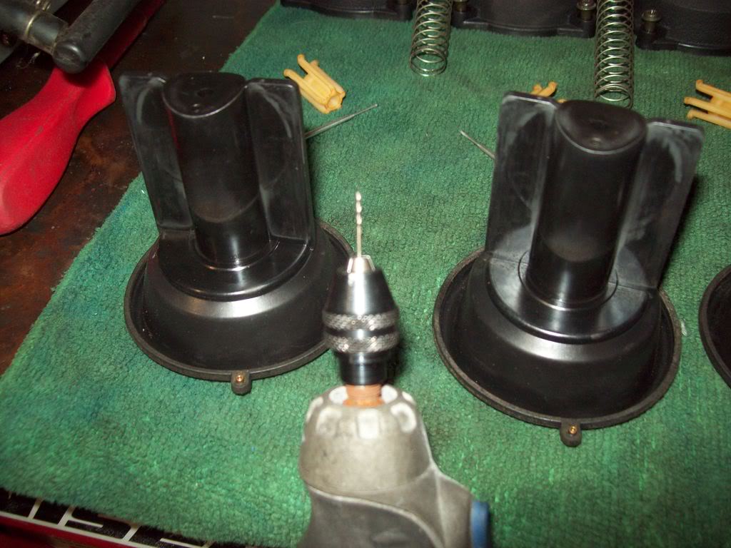

drilling slides. (ancient chinese speesd secret)

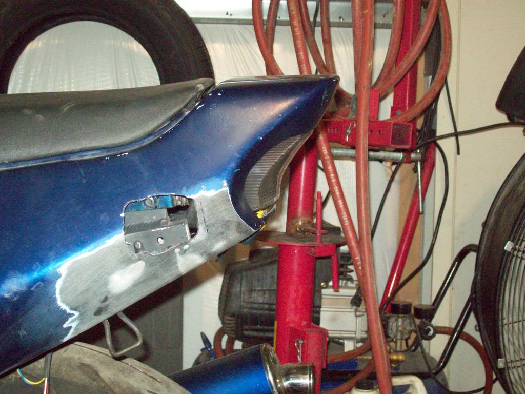

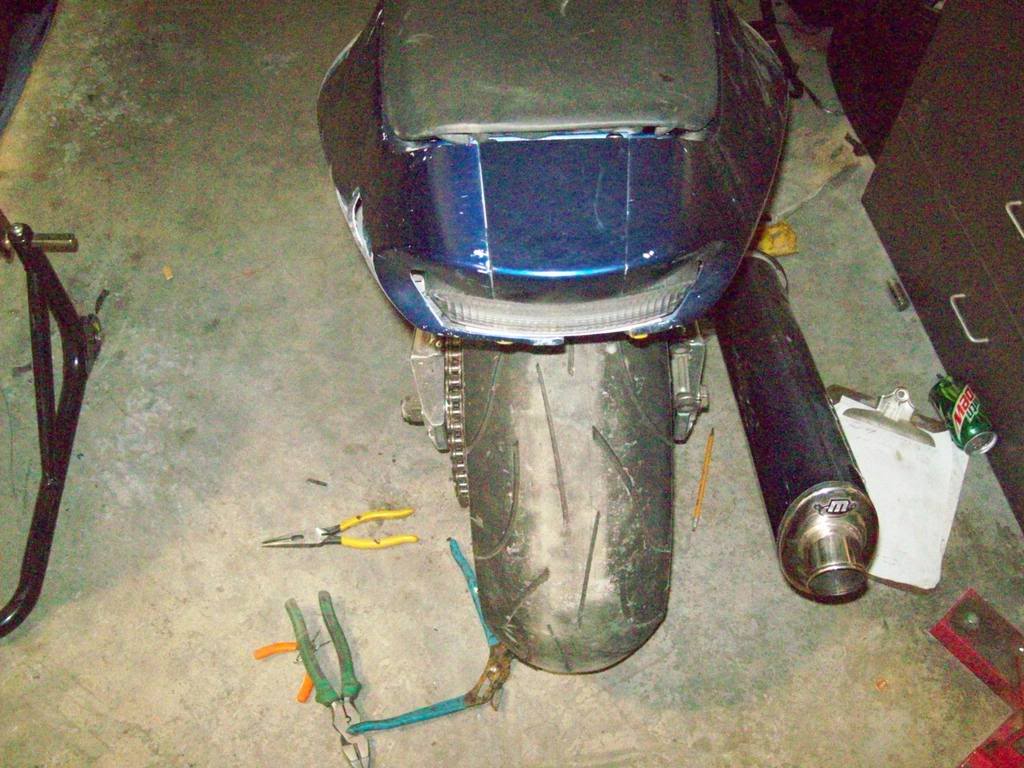

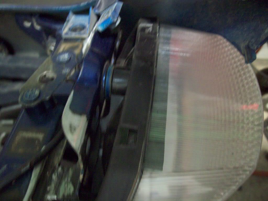

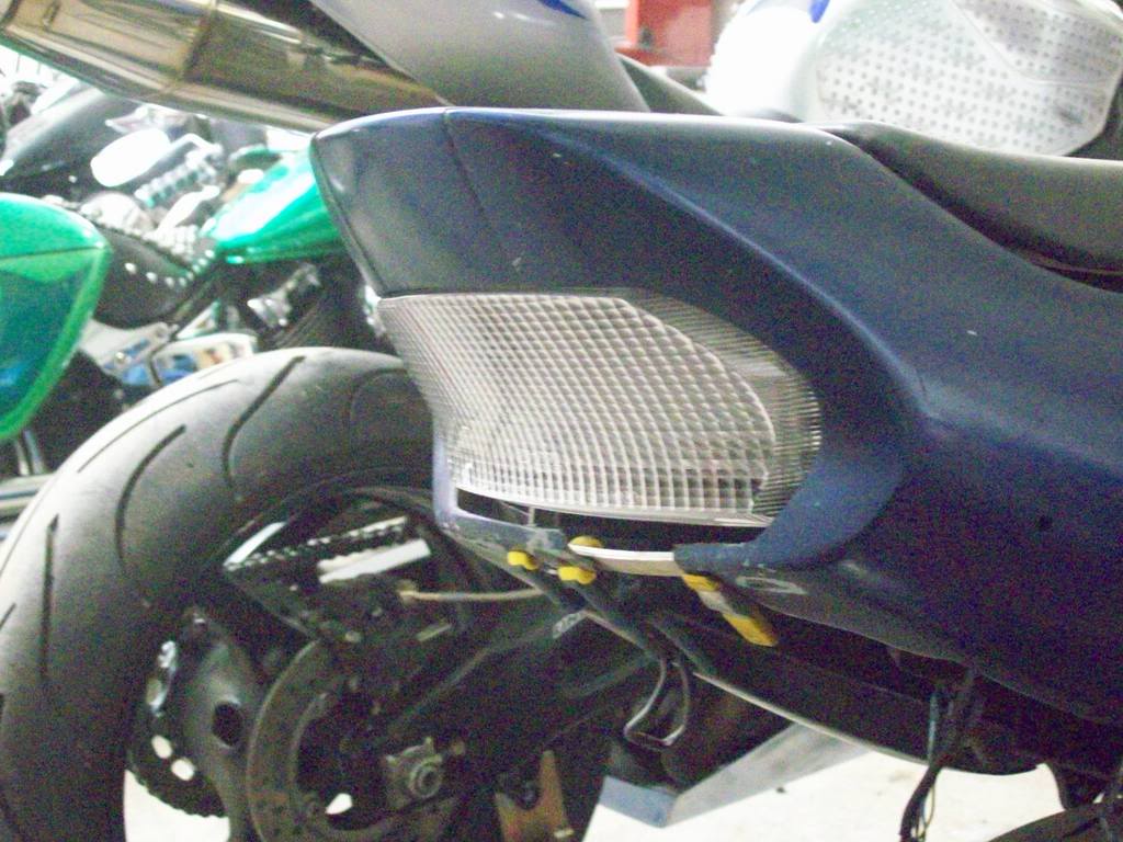

frenched taillight. ever since i did this, i notice on kawasakis how far the taillight sticks out.. nasty!
don't mind that 2" hole in the plastic. that was an experiment that failed.

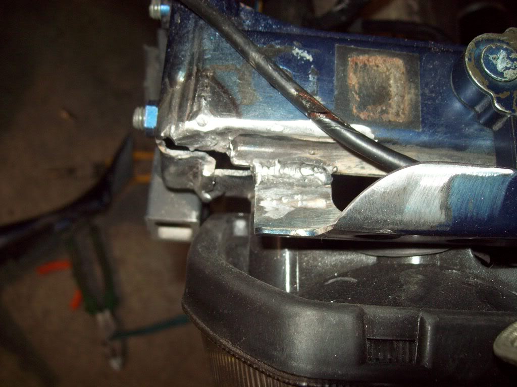

a lil choppy chop weld action. i HATE flux core, but thats all i had at the time.

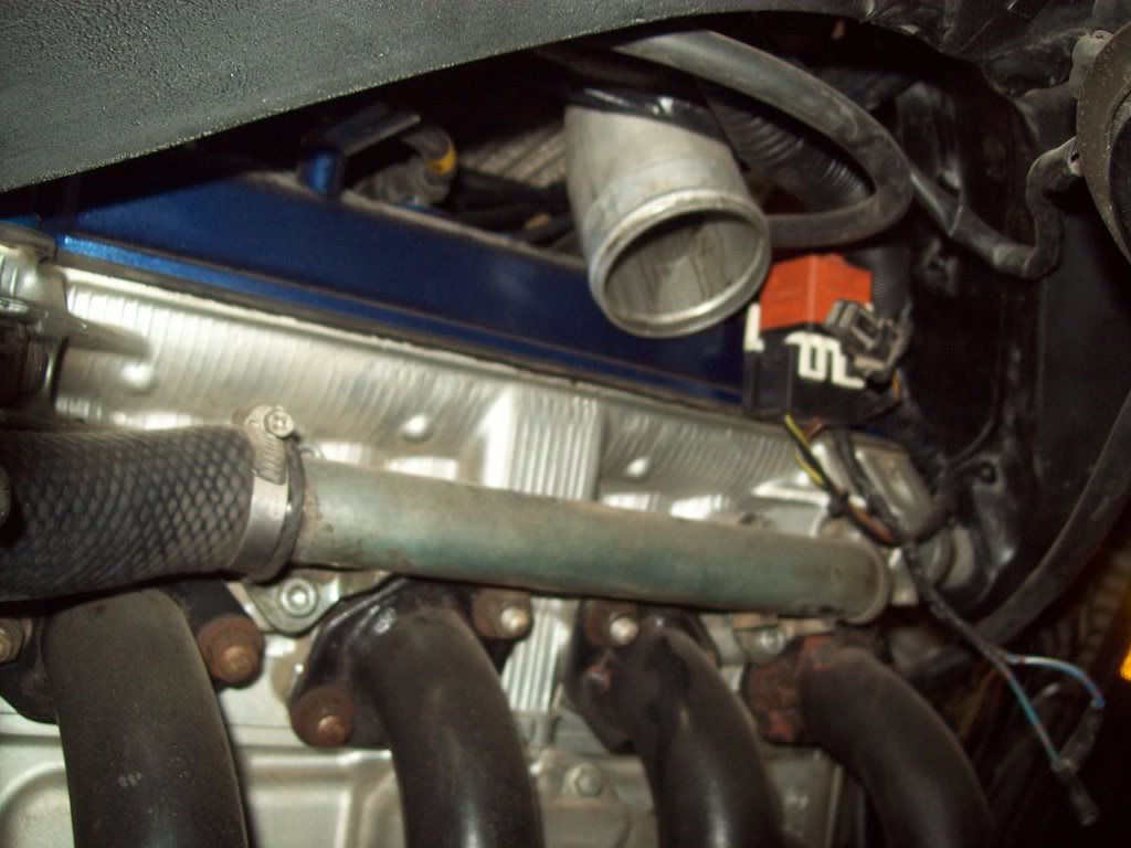

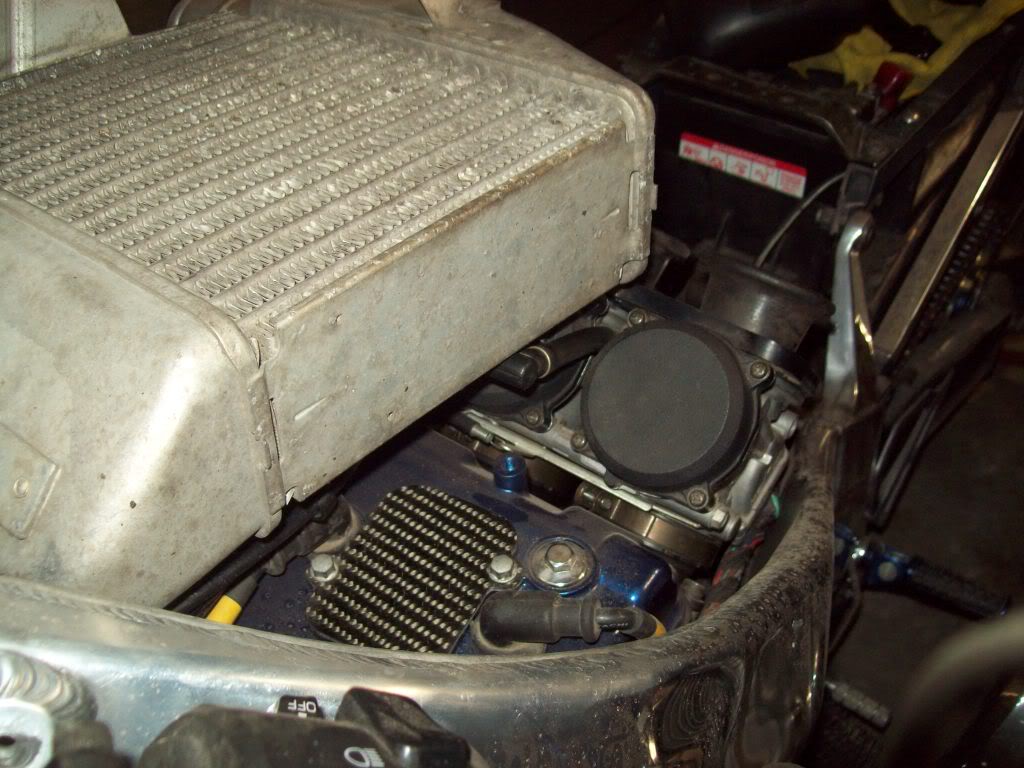

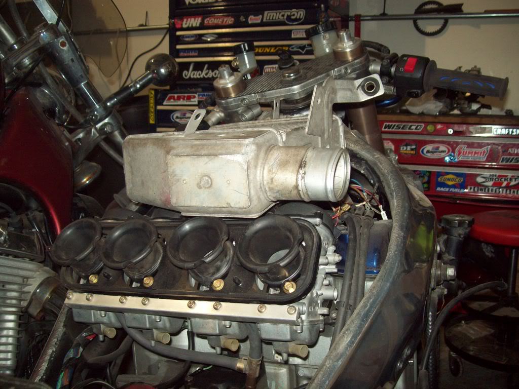

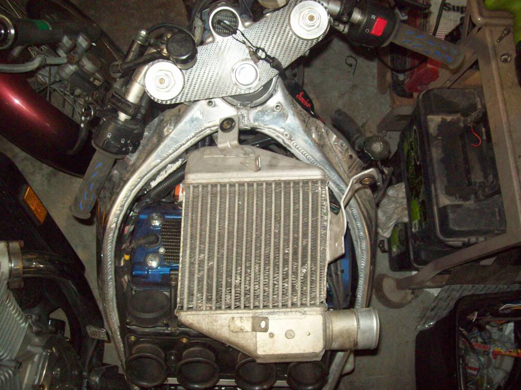

test fitting the intercooler.. seeing what mods i need to make.. don't need to do much!! spin the outlet and form a pan to direct ram-air air thru the core... fab up a lil two piece airbox and a diffuser for hot air.
IC is a 2G DSM side mount from an eclipse

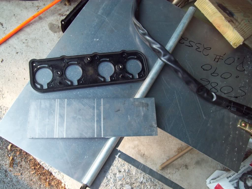

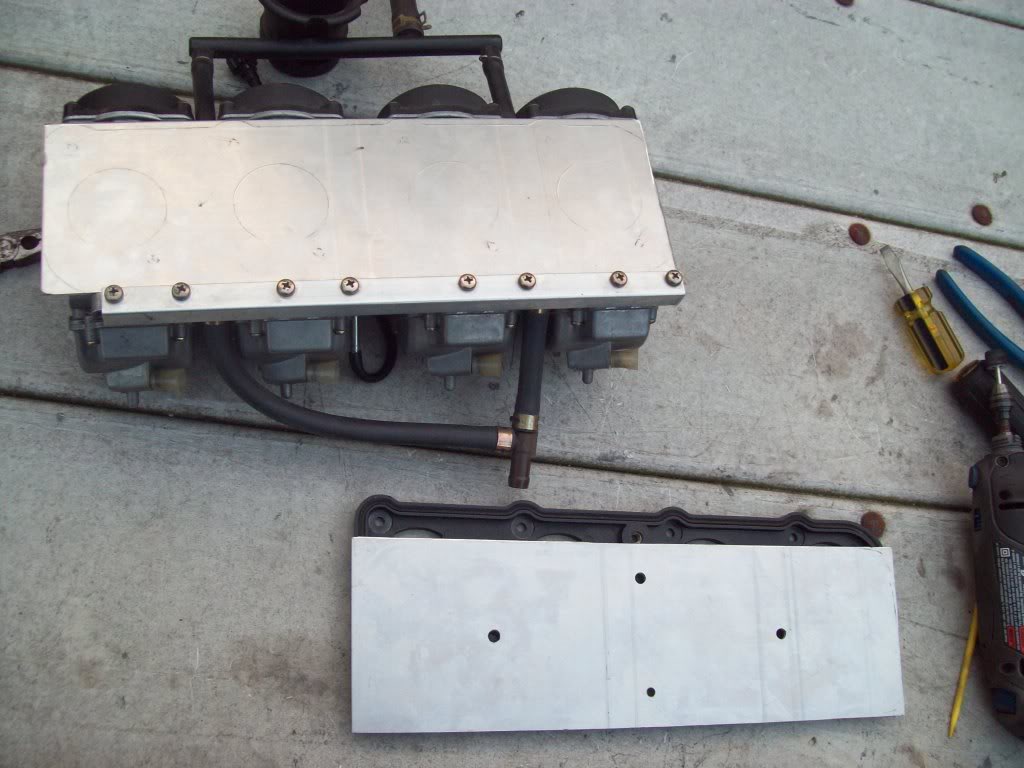

starting to fab the airbox.. the baseplate plasma'd out of .090" 5086

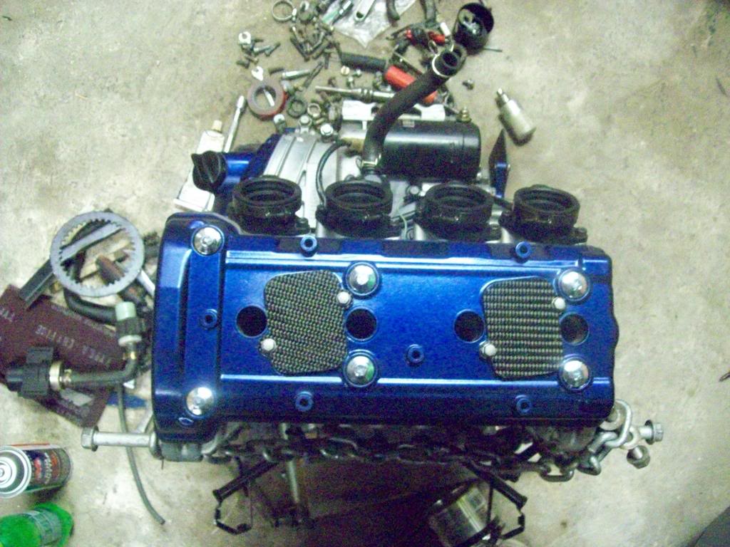

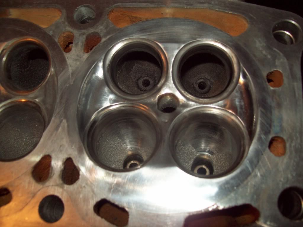

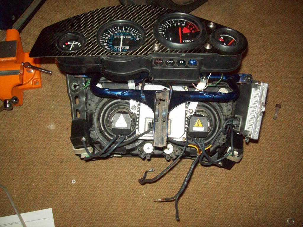

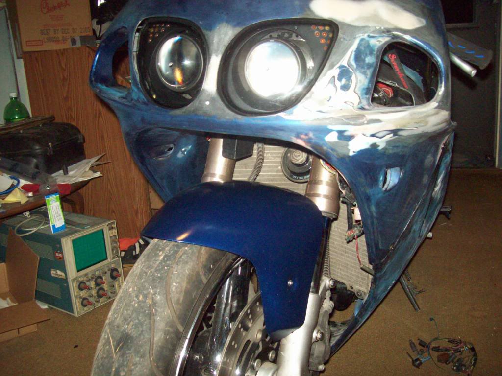

gratuitous head shot teaser.. bowl work on the turbo motor. mild polishing on the intake.. VERY mild.. uber polish on the exhaust.. who cares about laminar flow on the hot side!
muzzy blade. so nice. got this, the M-B HIDs, upper fairing stay, and some misc parts for a steal of a price from my homey in pheonix.

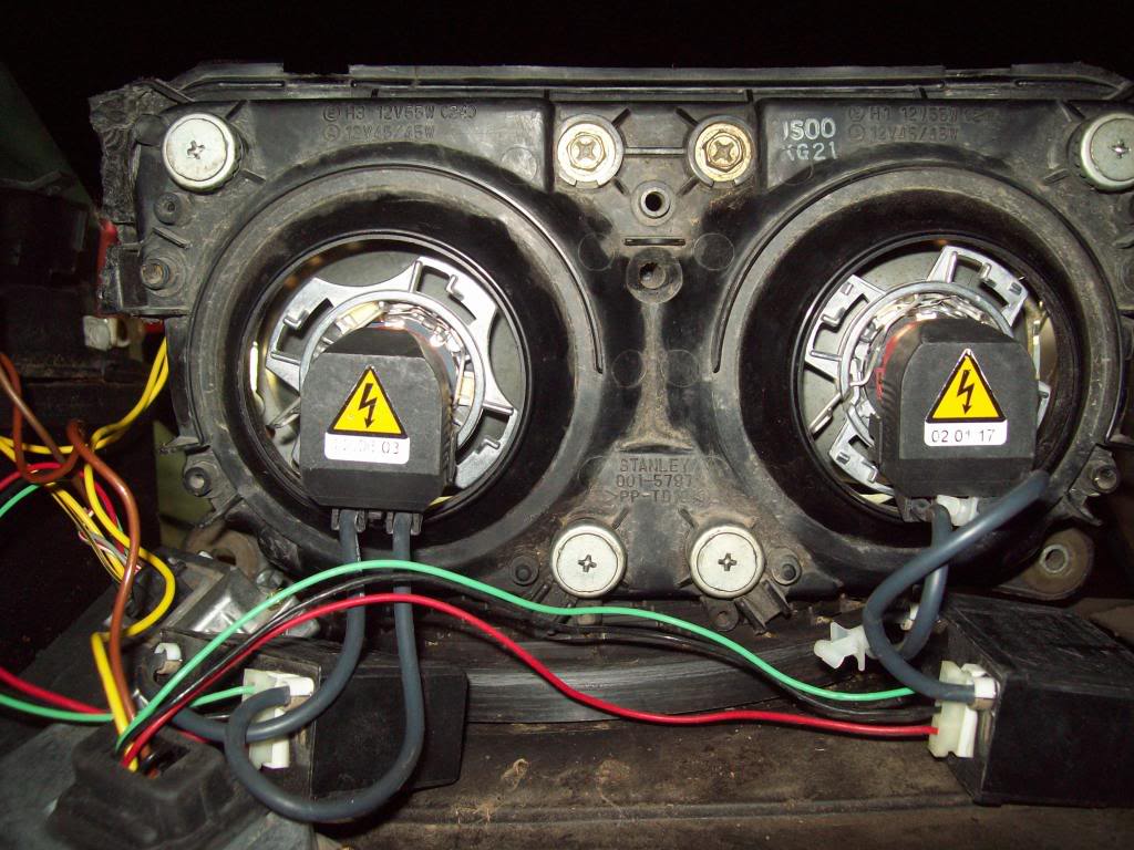

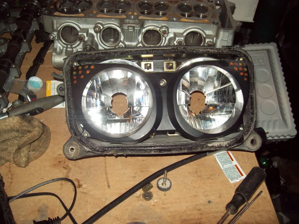

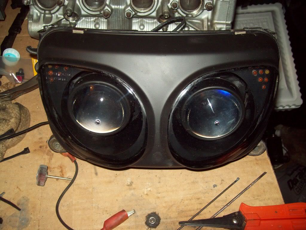

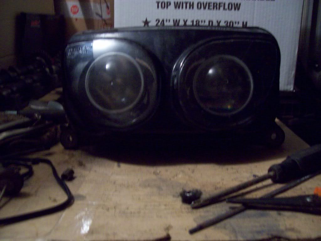

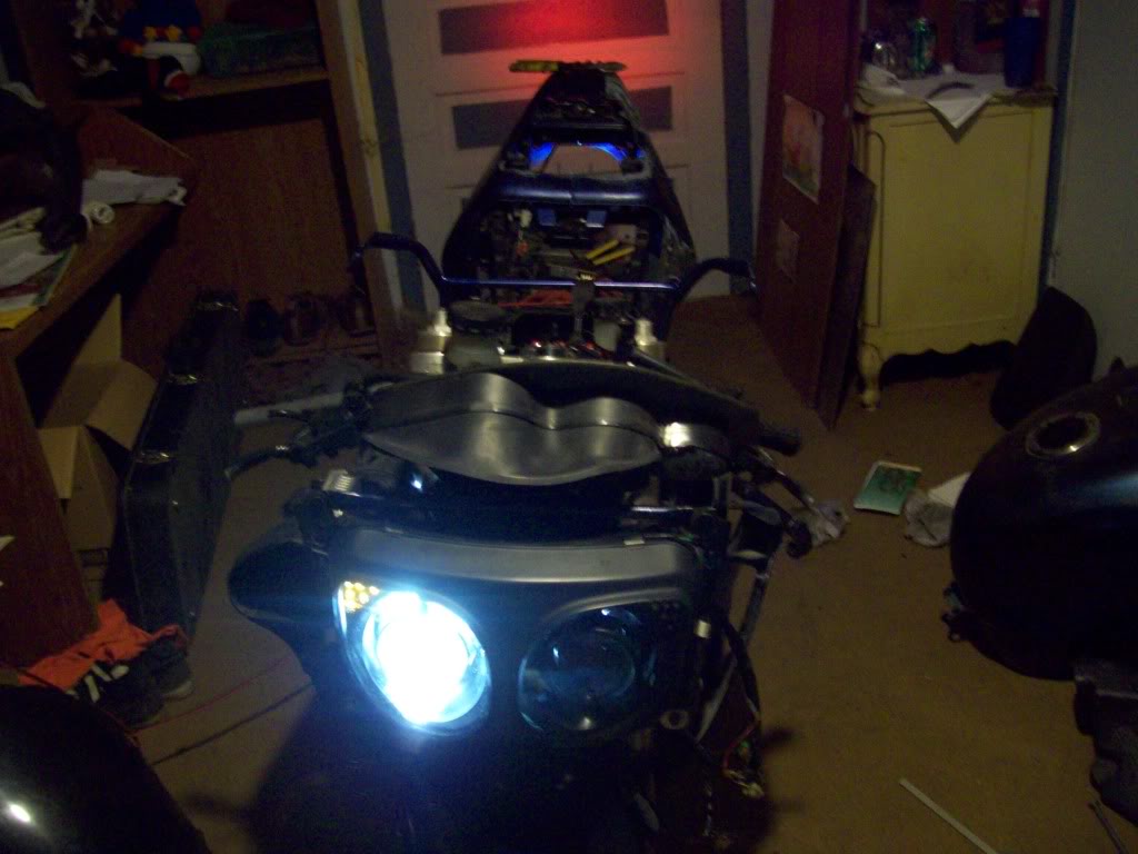

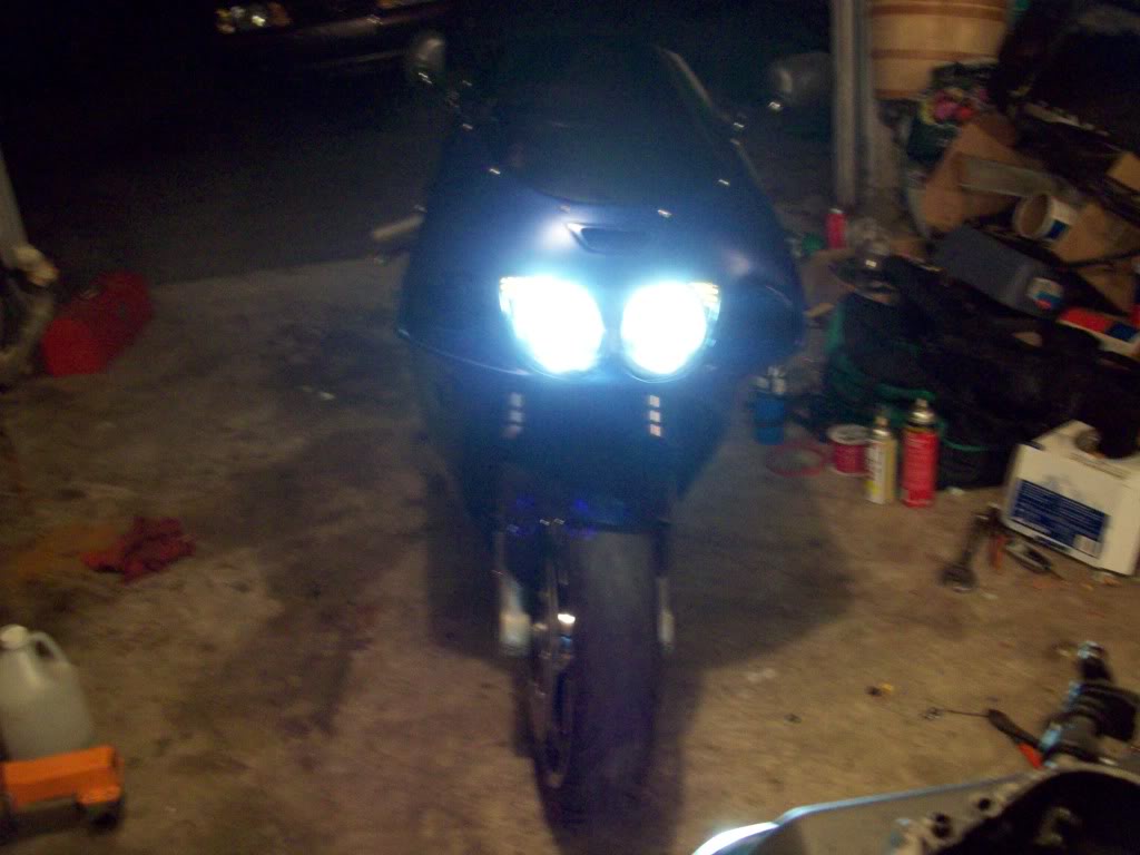

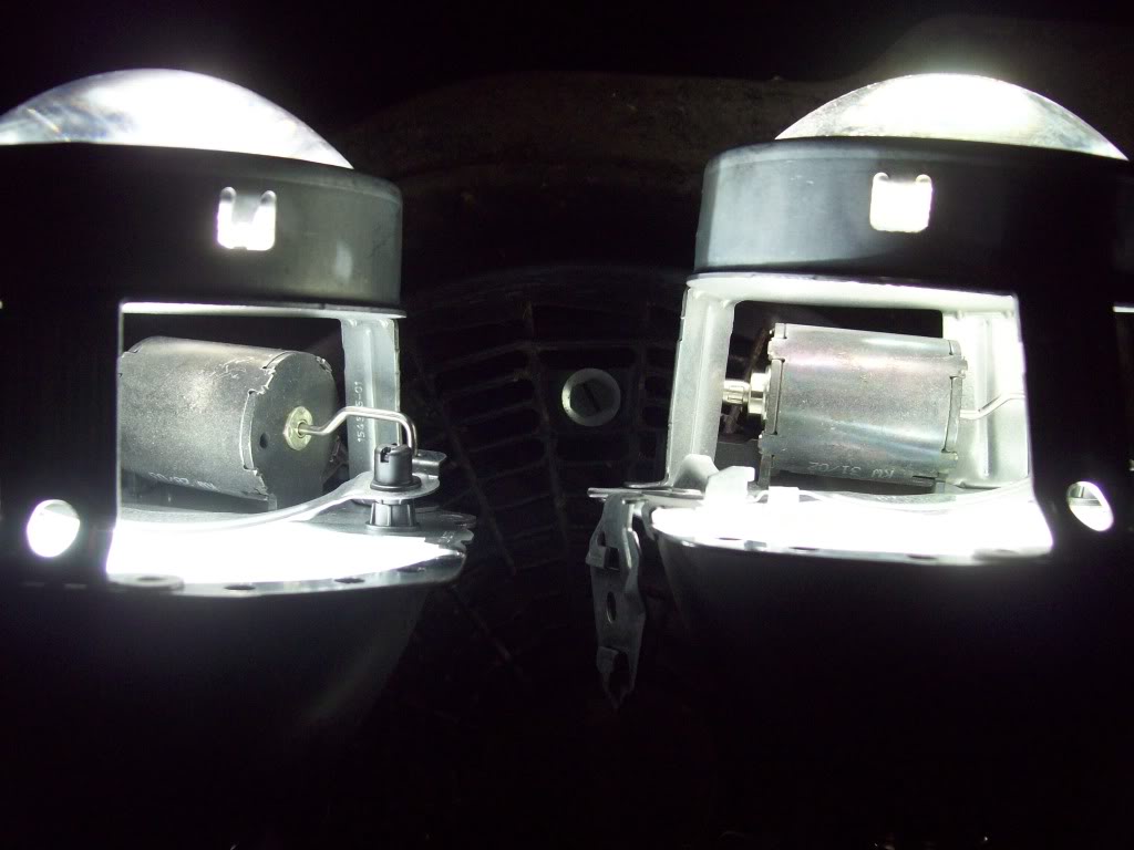

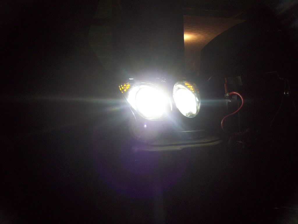

probably my favorite mod.. SL500 35 watt HID projectors.
they are so bright that i can light up street signs damn near 1/2 mile away.. fist 50' is like daylight.. on LOW beam. 200' on high beam is gorgeous.. 1/4 mile visibility. and they're set to b=not main passerbys on low beam.
i have not had ONE single person pull out in front of me (accidentally) because they didn't see me. not one. i've had a few ******** cut me off or intentionally pull in front of me.. when i flip the H beam on, they hate life.
lights are worth $1200 a piece.. bulbs are $120 a piece. (osram D2S)

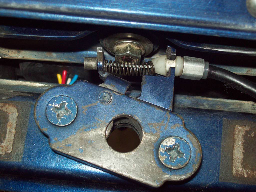

H beam solenoids

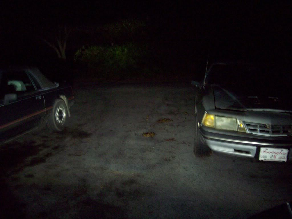

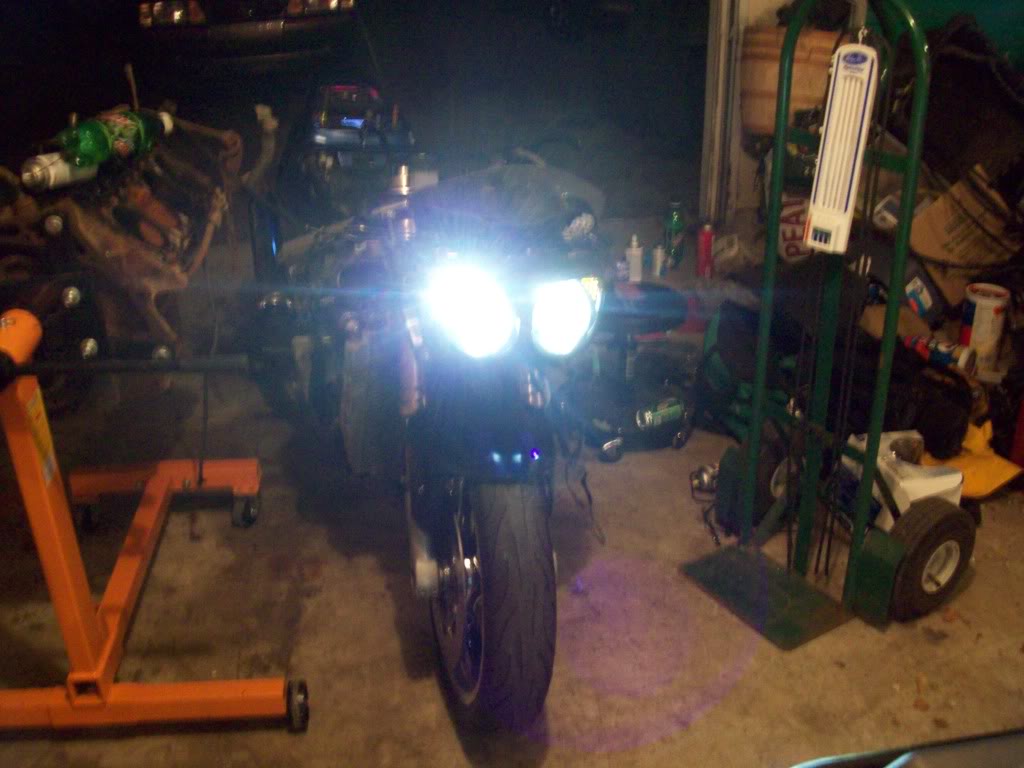

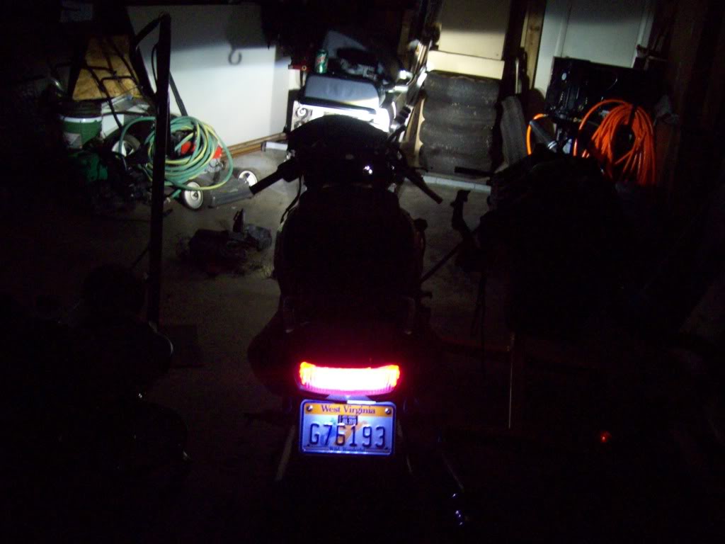

hot sex time.. from almost 50' away, low beam, before tweaking light aim.
like daylight.
a lil custom harness fab action..

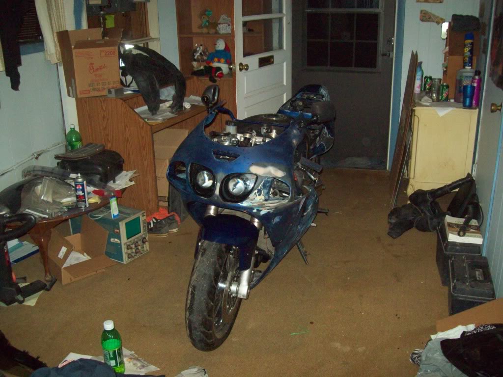

temp install before taking it all home and assembling in house.. literally.. in the house.. lol

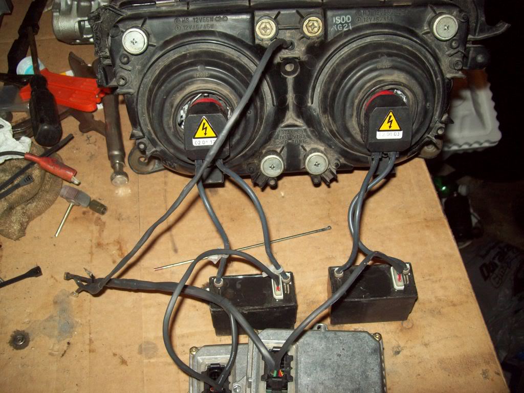

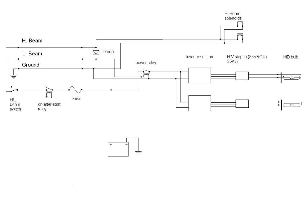

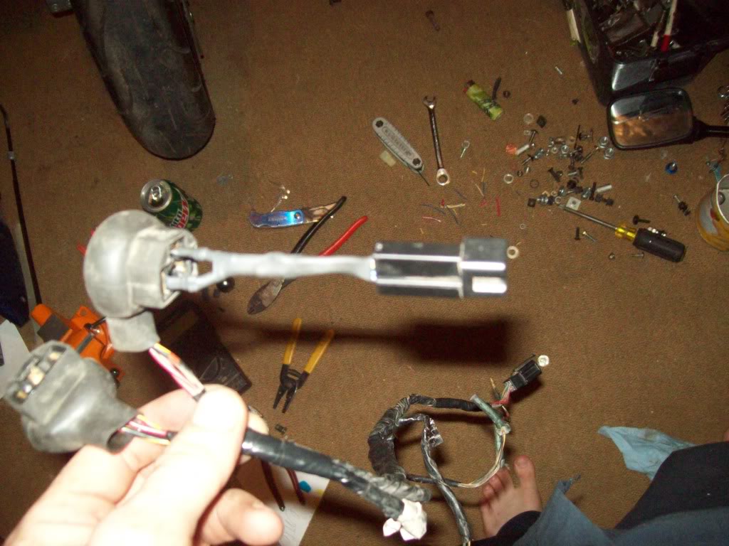

at the house.. playing withthe lighting setup.. had to build a sub harness. the inrush made the lights flicker.. any time you have flicker on HID it'll kill the bulbs and ballasts in a few minutes. as expensive as these things are, i take no chances.. ran 10ga. from the battery theu a relay and to the ballasts.. used the stock headlight low beam as a control voltage source. tied a diode in to keep the power relay on when on high beam but keep the h. beam solenoids closed when in low beam.. l/h is a flip-flop circuit. one is on, the other off.
diode
this is what i did.. behold the wicked MS paint skills and an electrical engineering degree.

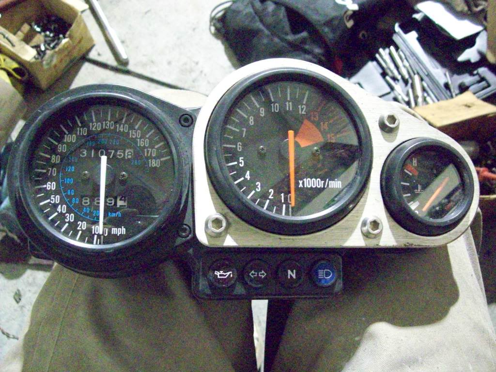

entire gauge/light assembly
a lil test fit action

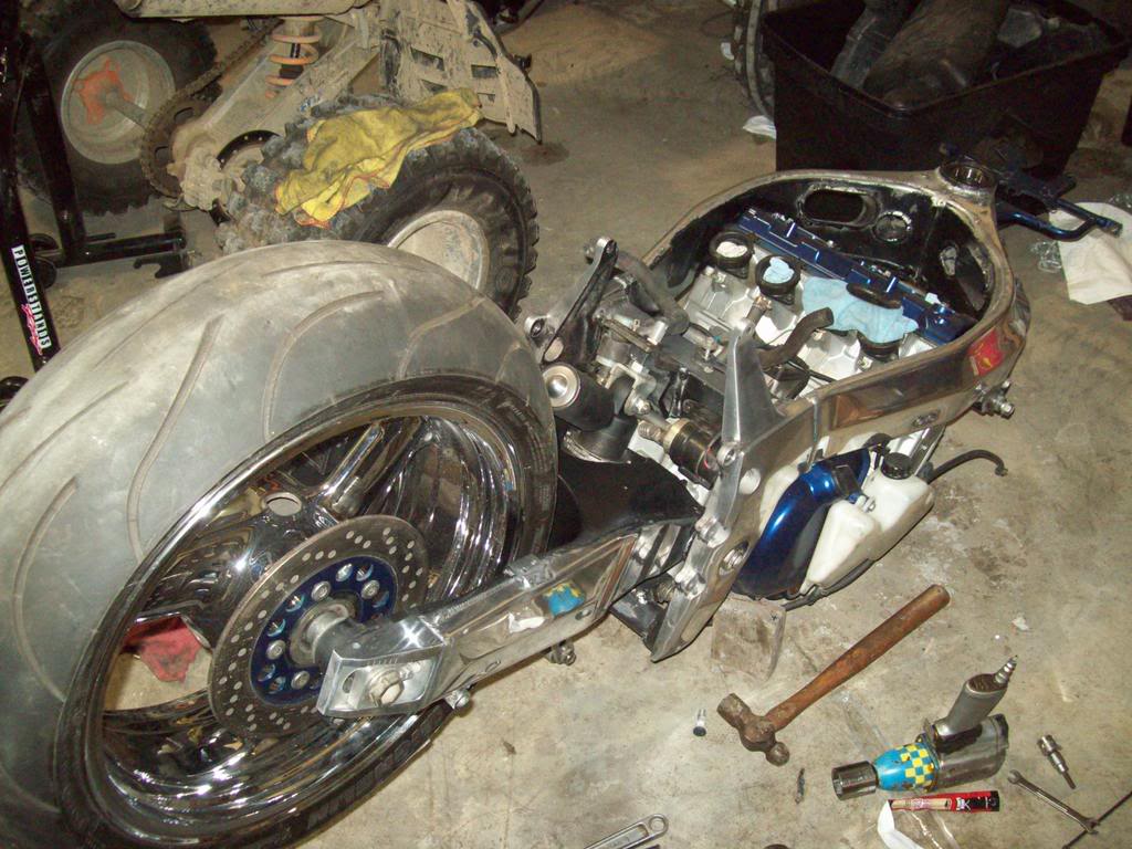

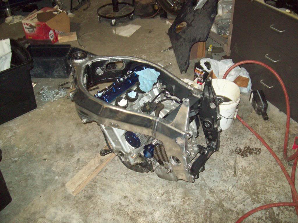

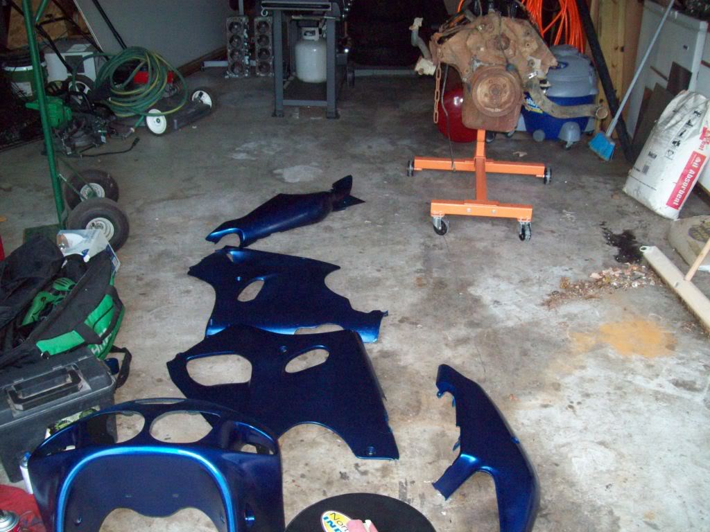

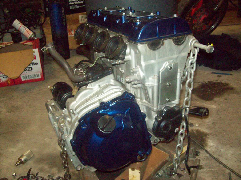

stripped nekkid for paint

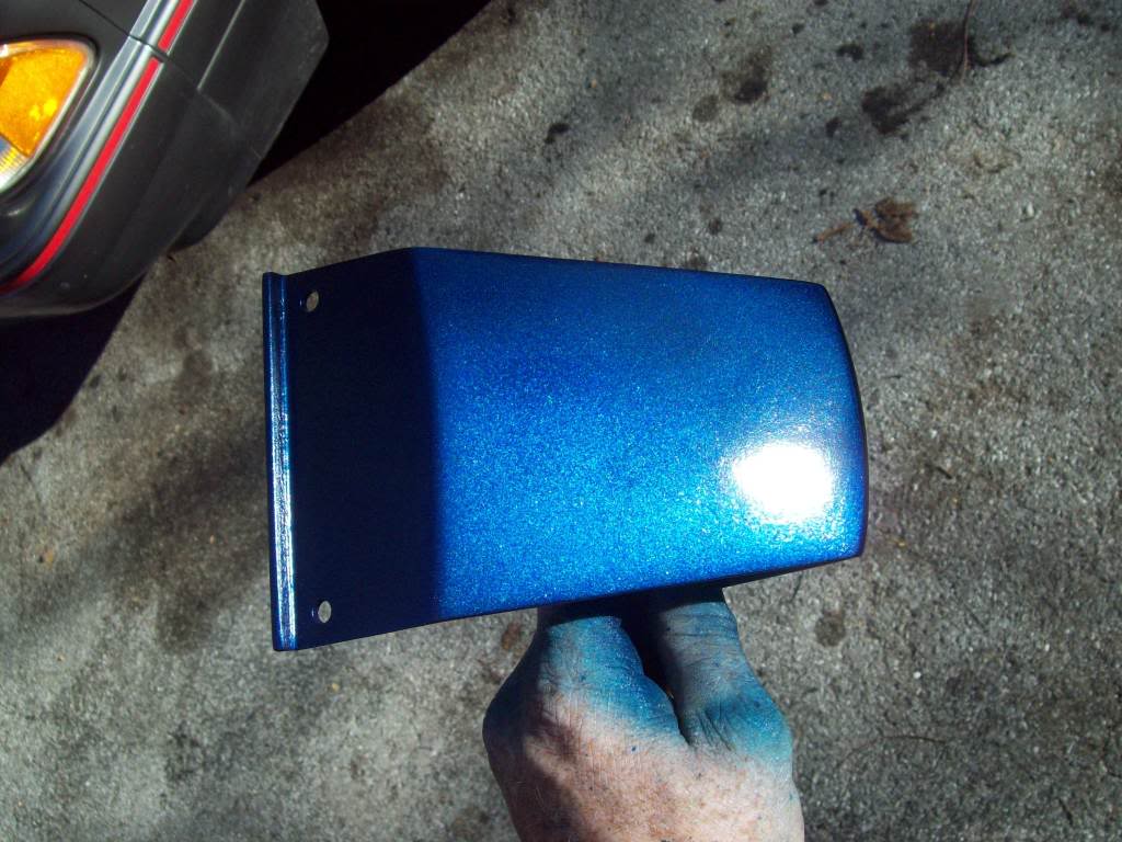

would ya believe it's spray-bomb? duplicolor DSM340 royal blue..( also known as FM340X)
the engine on the stand is a ford 460. was going to go in a project mustang that my pops and i had planned ( 520CI with an 8-71 blower) but he passed shortly after my build was done.. we will never get to build the car. my turbo bike will be a dedication to him.

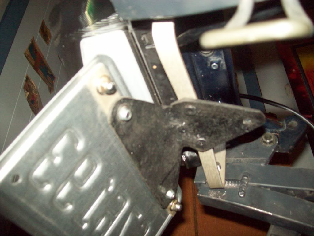

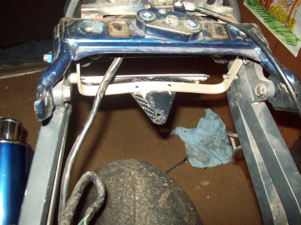

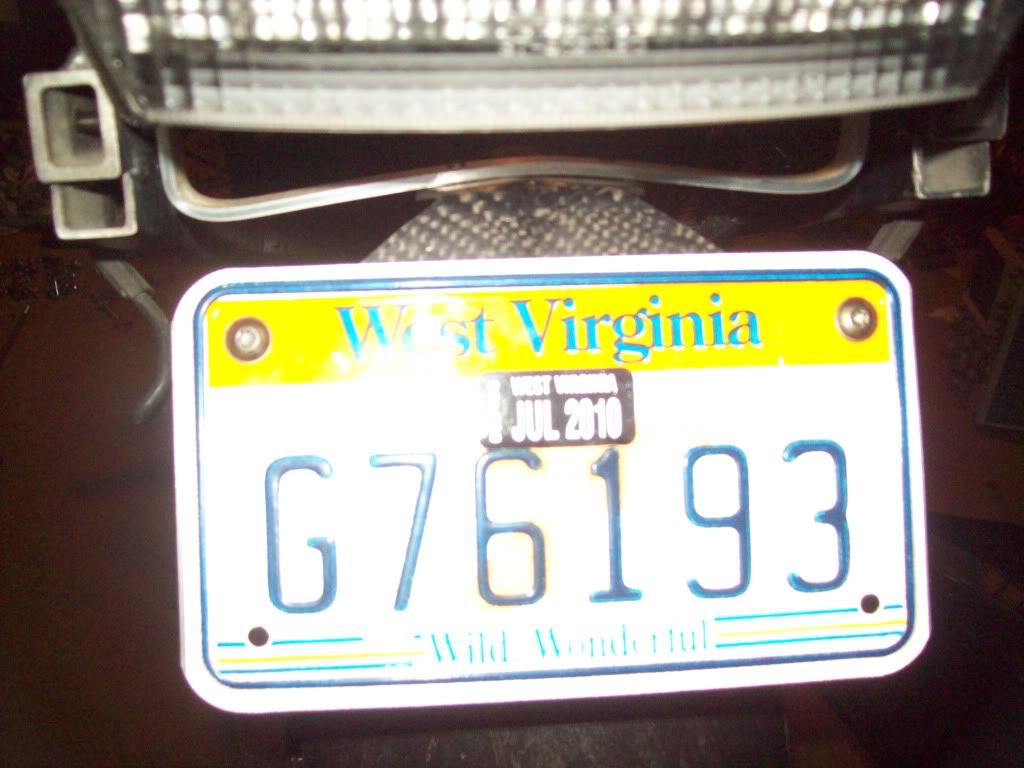

little CF tag bracket i scored off a busa i rebuilt for shows.. hand fabbed the aluminum piece holding it.

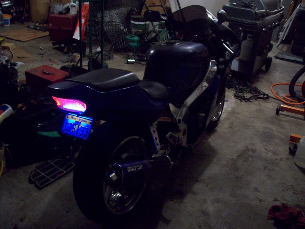

for the longest time, i rode without a current, registered tag.. thus why i'm no stranger to outrunning cops.. lol
well, this time, i'm legal eagle!!
looky!! legit baby!

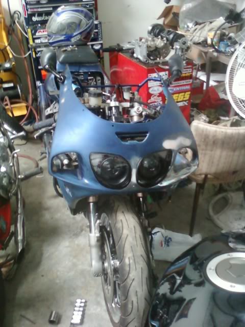

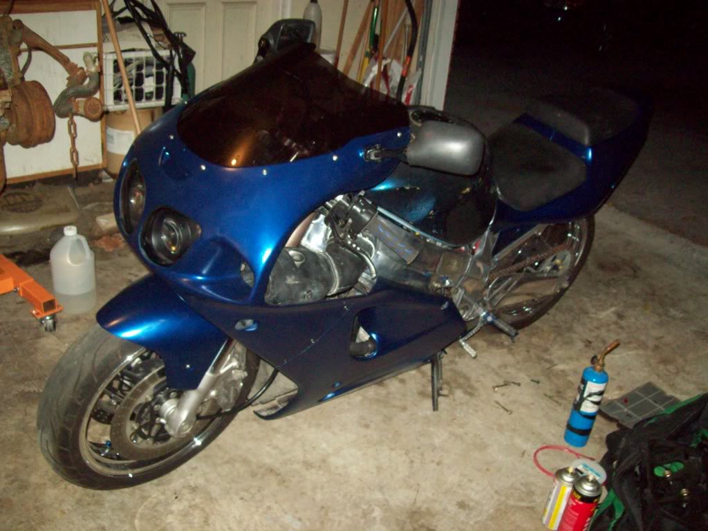

annndddd.. paint.. together.. running.. finally.
