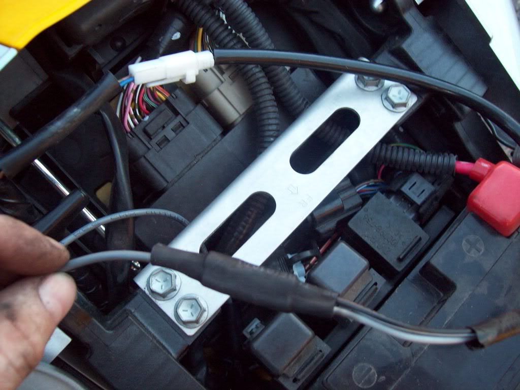

customer's gixxer i went above and beyond on. (i like heatshrink and solder..)
be-fo
wiring detail (yes.. meticulous. whadaya expenct from an electrical engineer?)

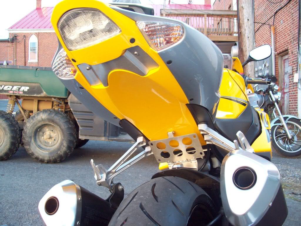

after YAY.. no more fender

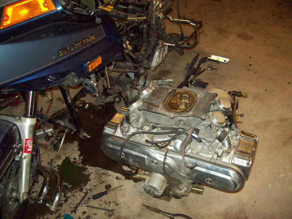

goldwing motor.. (14 hours of work total..) it needed a stator and cam belts

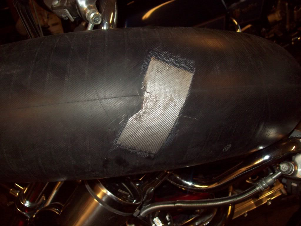

THIS is the kinda work we gotta put up with FROM THE DEALERSHIP!!!!! that is ductape. ..on a tube out of a V star. classic ghetto fix and pray.

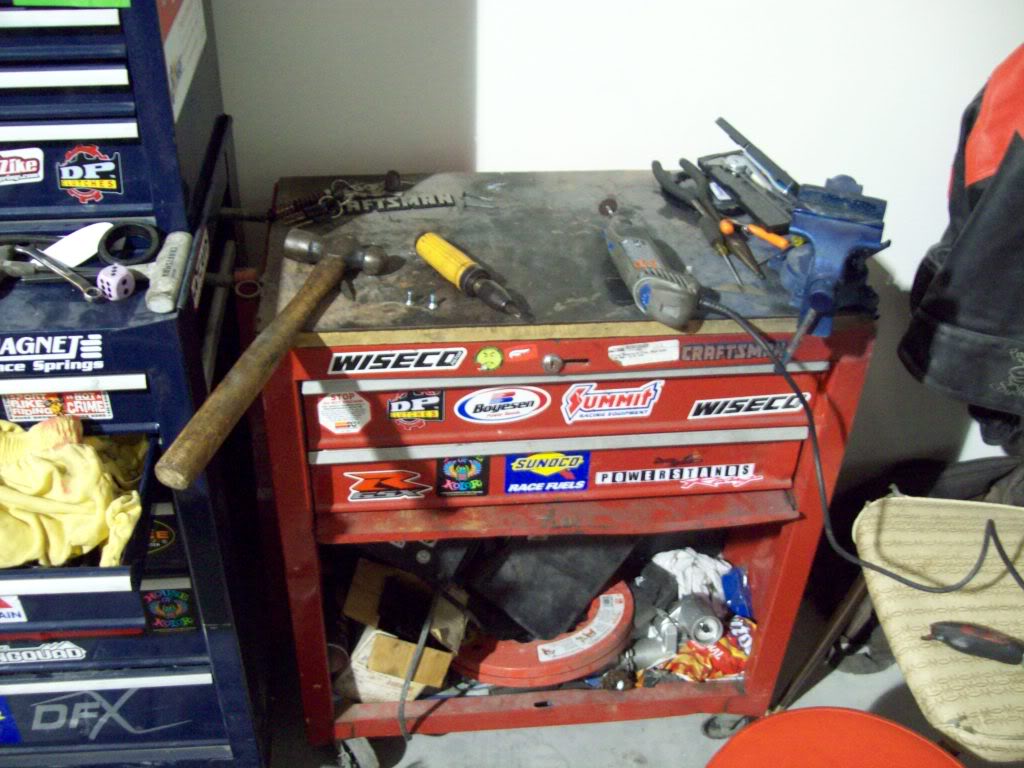

implements of destruction!! haha ( you KNOW when the dremels out, it's serious bizness..)

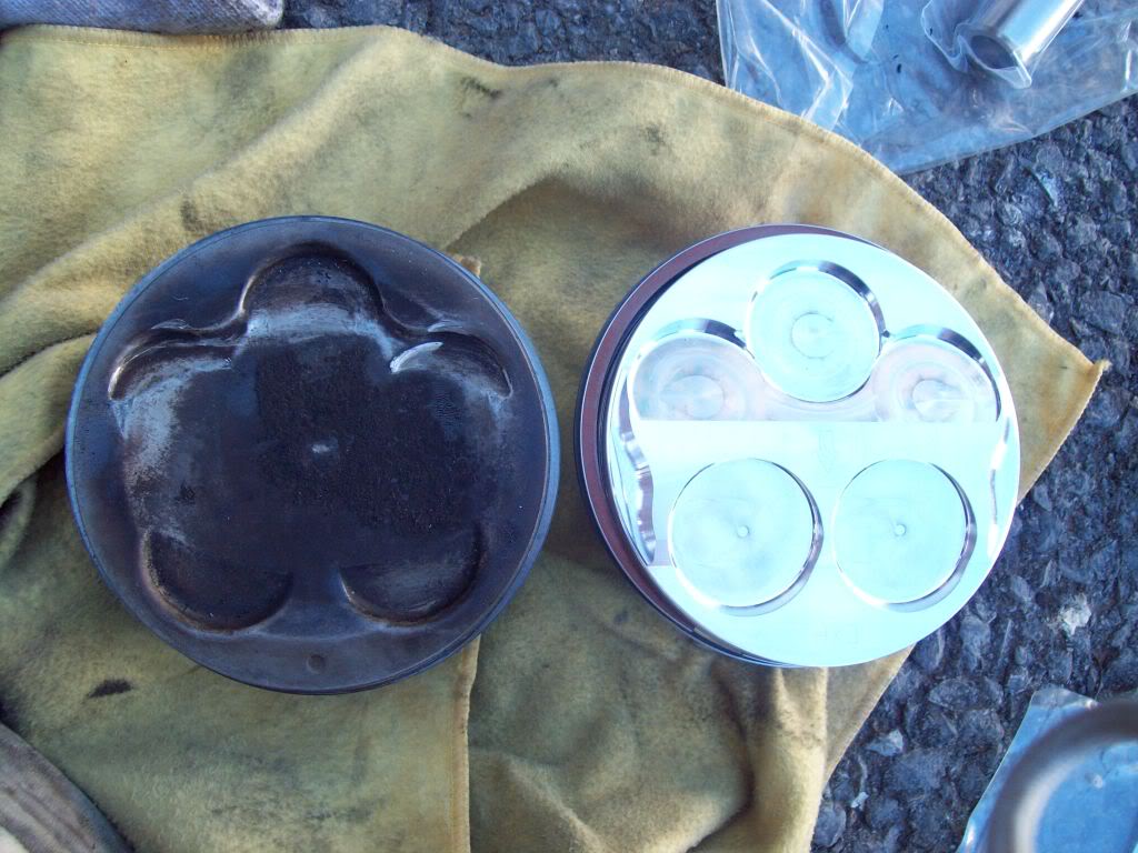

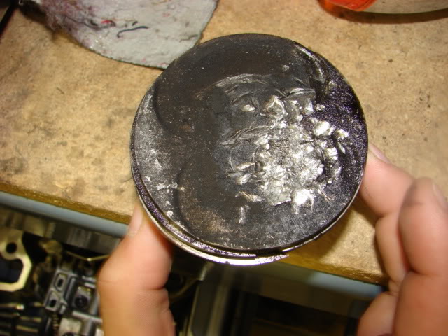

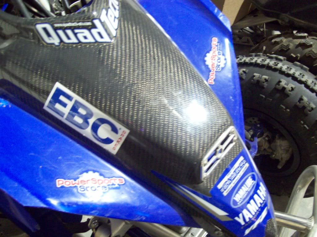

MMm cf. thers alot of money in this quad.. lol th labor i got for this kid alone is staggering. ( he kissed the valves off the piston)

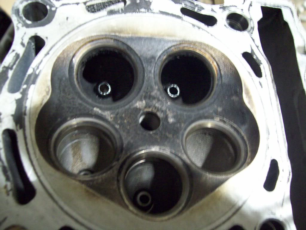

as you can see (the shiney spoyt on the black piston) he did a good job. theres faint marks from the other 4 valves. the piston, 5 valves 1 bucket and 1 shim were trashed.

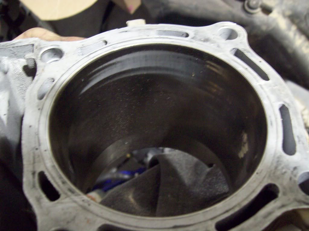

the nikasil plated bore that got trashed.

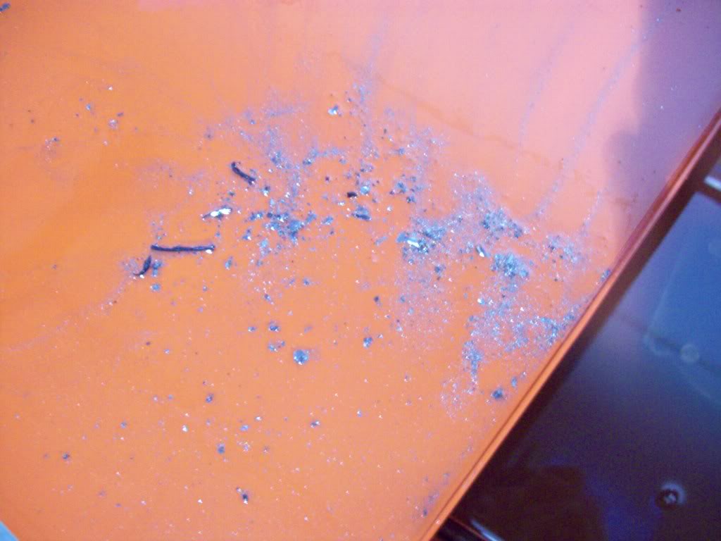

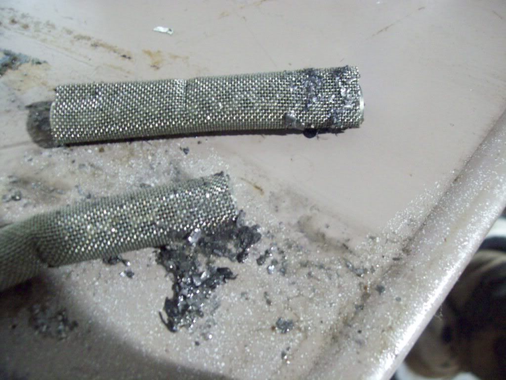

heres my fav, so far.. this kid ran this LT-R 450 without oil for a bit. ..oops
THAT would be metal shavings.. they used to be things like bearings and a cylinder bore.

another pile.. lol screens here

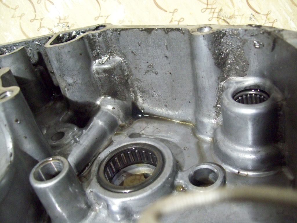

all the bearings are shot in this thing.. it's a total rebuild.

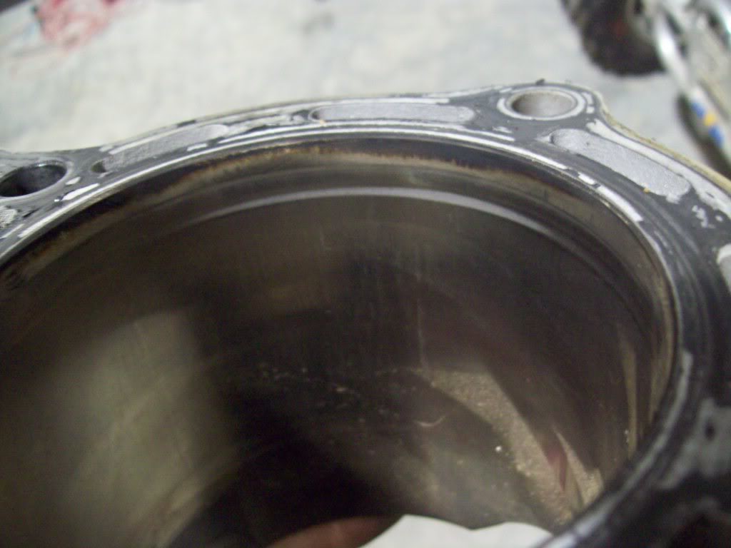

the wasted bore

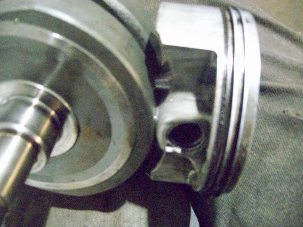

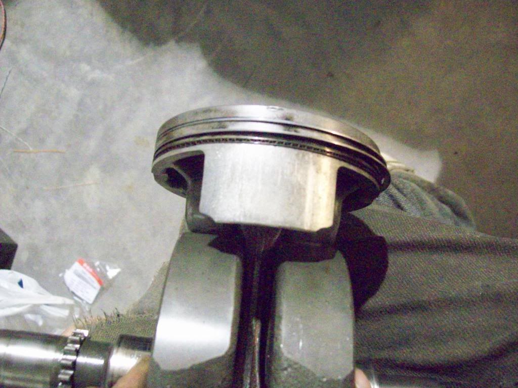

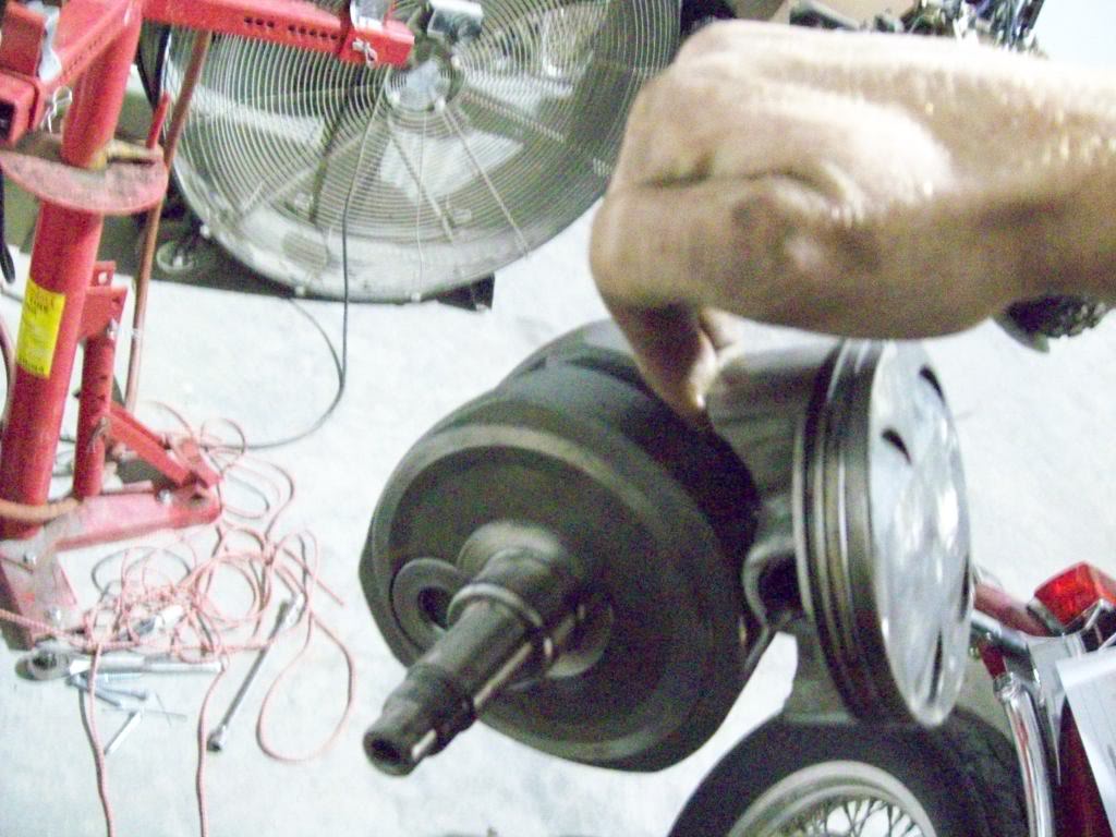

my fav.. this .. this should not be like that.. lol.. the rod bearings are completely welded solid.. the big end bearing collapsed allowing the piston skirt to contact the crank counterweight. thers NO gap (literally) between the piston and weight.. they're bonded together.
as you can see, i'm holding the piston.. usually, a rotating assembly would "unfold" when held like this.

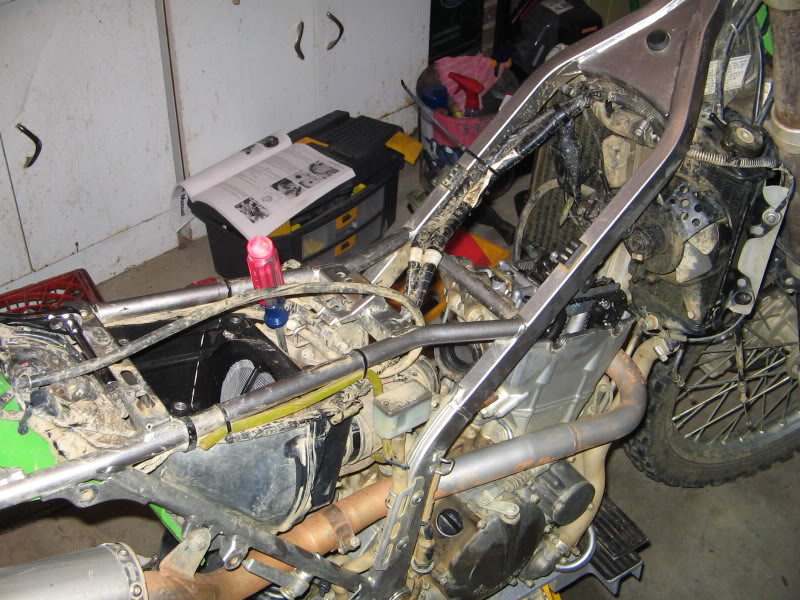

klx tore apart

hahaha, are you sure? No trail fix? dang if that be a true story.

yeah, ted. .that came to the shop after a dealership in virginia serviced that same tire.
