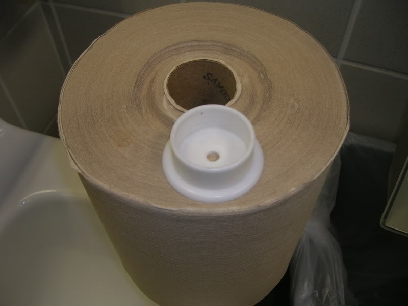

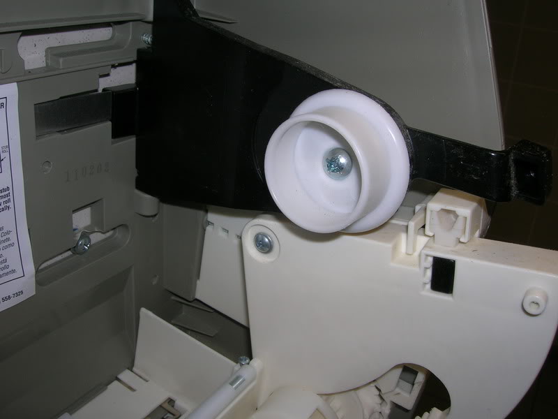

Yesterday I went down town with a roll of towels determined to finish this once and for all. And what did I discover? The little white plastic dowel holders for closets fit perfect. I only have to change out one side as you will see in the pictures and grind off a couple of tabs on the other side. So for about 75 cents for each dispenser and 3 minutes to do the work, I can now put in any 8 inch plain roll with no notches, or whatever. Not only will this allow me to buy them from anywhere but because it is not a special towel, its about half the price. So Georgia Pacific......BITE ME!!!!!

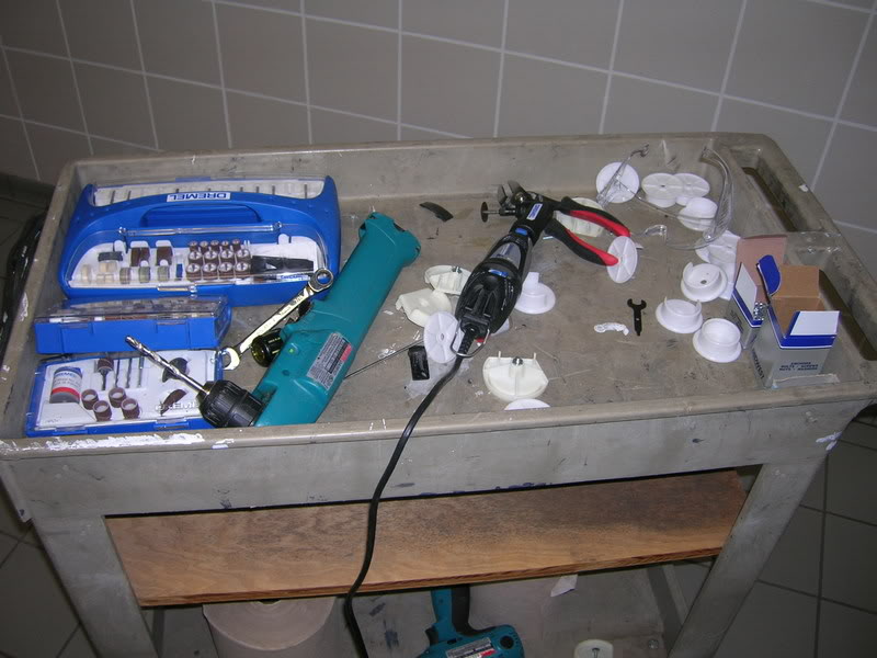

Cart all loaded up for the job.

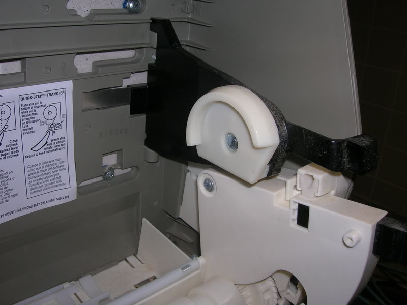

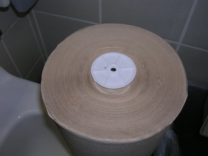

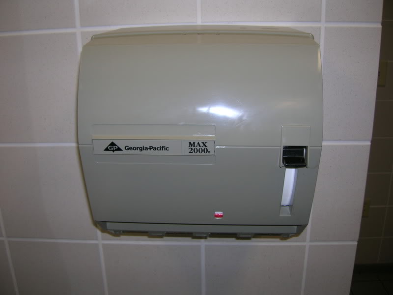

Basically all I used was a 1/4-20 screw, lock washer and nut on one side and ground off the other side's notch.
Georgia Pacific Max 2000

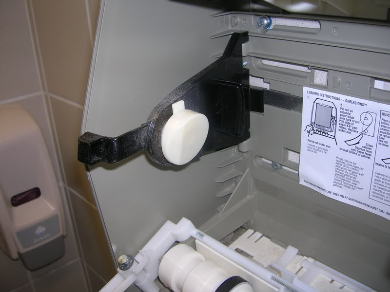

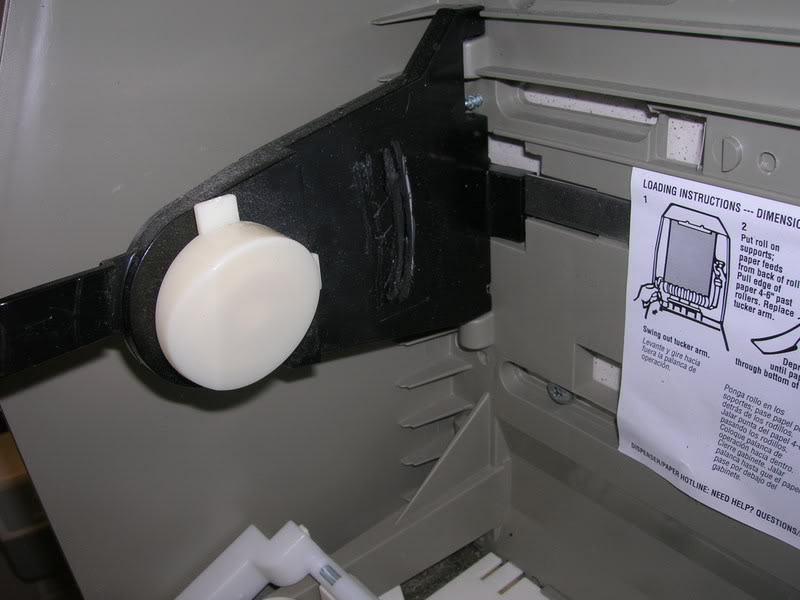

In this picture you can see the notch wheel on the right which I replace with the closet dowel holder.
That wheel goes into this:

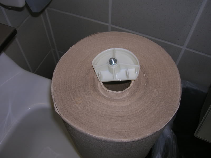

Here on the left side the holder is actually ok, but if you look close there are a couple of tabs that stick out.

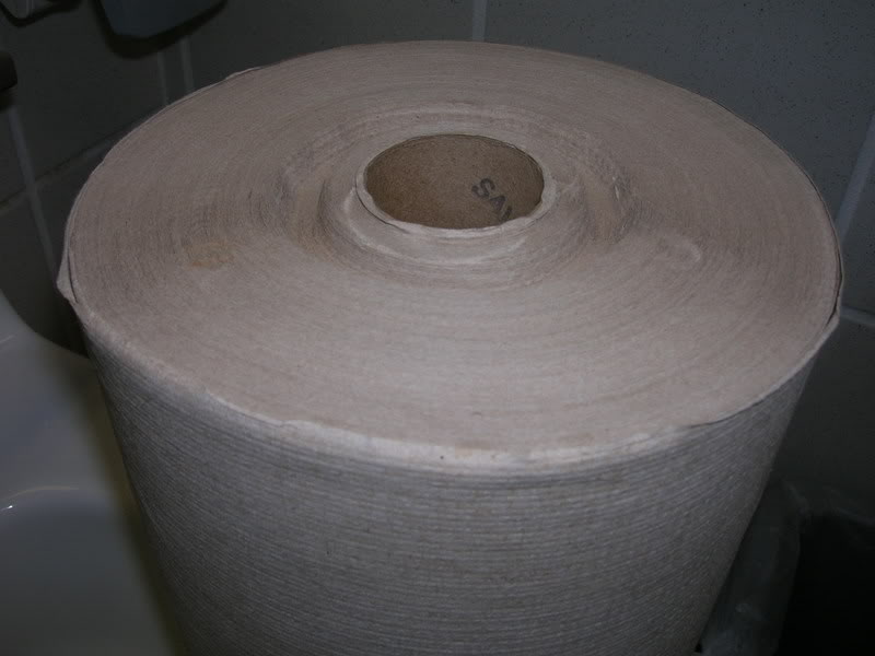

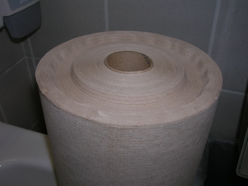

And they go into this notch on the paper towel.

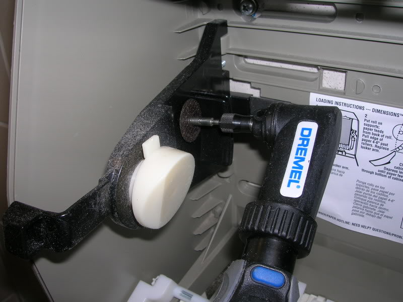

So a little grinding with the right angle dremel and boo yaa. Which takes all of 15 seconds.

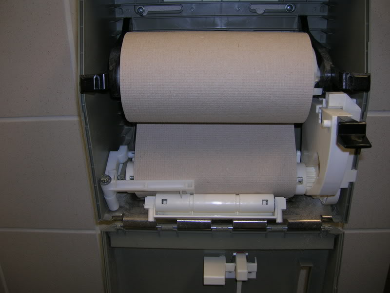

Here it is on the other side. I had to drill the holder and the place it mounted.
So for 75 cents each and 3 minutes of my time not only will I save half the money on these throughout the facility (30 dispensers) but now I can buy a standard roll from Grainger. Plus we don't pay for shipping with Grainger so I'm saving even more.
