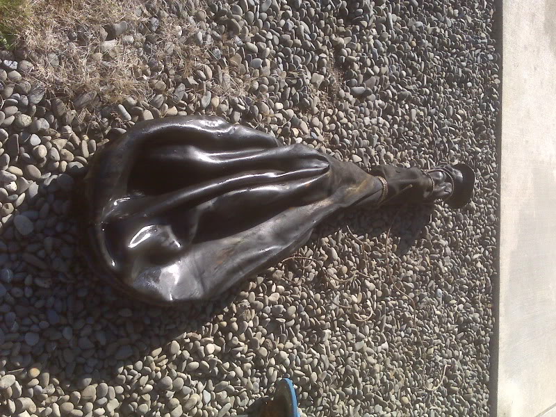

So about a week ago I noticed that our water pressure here at the facility was climbing and the pressure reducing valve wasn't working, I decided to replace it, but before I did that I isolated it from the system by a series of gate valves, and the pressure didn't change. So that told me that there was another problem. Well it turned out that our bladder type expansion tank was the culprit. I did some more testing and it turns out that the bladder got a hole in it after 14 years, and so the water in it and the air cushion around it decided to get mixed up and have a party.

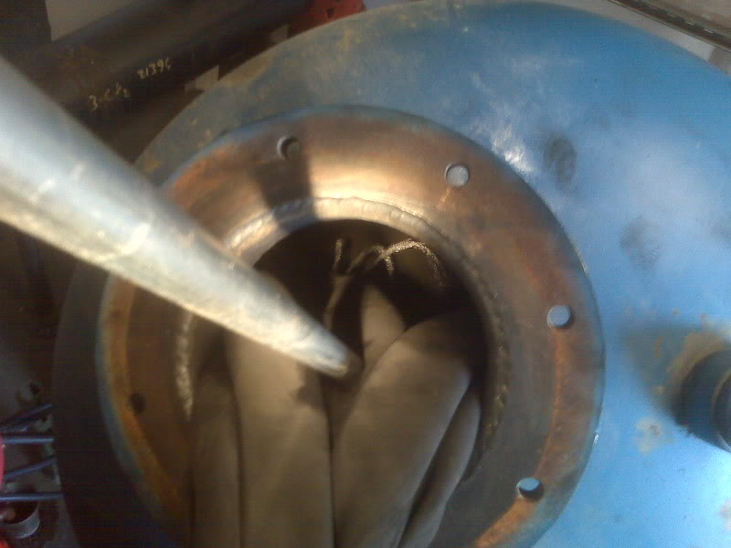

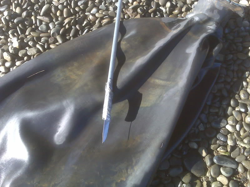

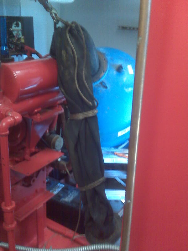

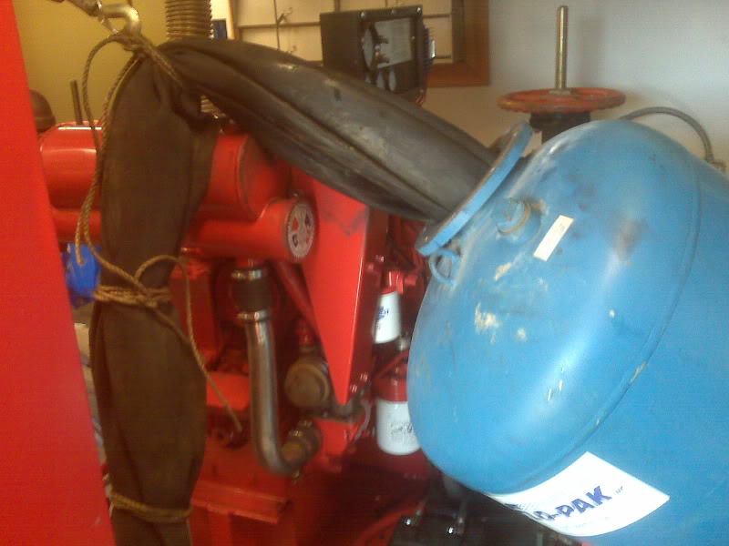

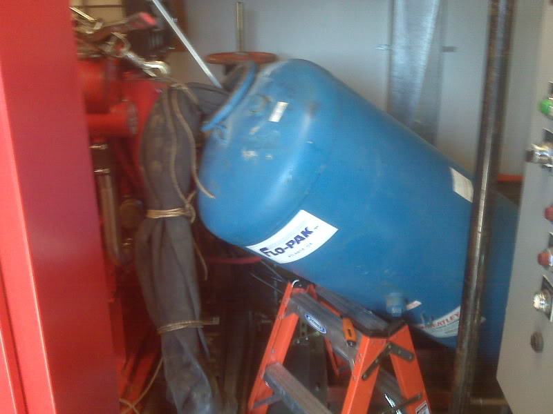

So anyway, I decided to be ahead of the game and I pulled the bladder, that sucker was heavy!, had to winch it out, and then when it got half way out, I realized that there was 10 gallons of water left in the bottom, so as you can see in the picture I fashioned a makeshift spear and poked down at the bottom and got the rest of the water to drain out.
It was a bear to get all the way out. sort of like trying to put a D cup into an A cup in reverse....or something like that.

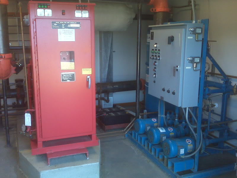

First of all, to set up my Monday morning, I have to show you a couple of pictures of the pump room. First is the firepump, which I had to lean down the tank towards to be able to pull the bladder.

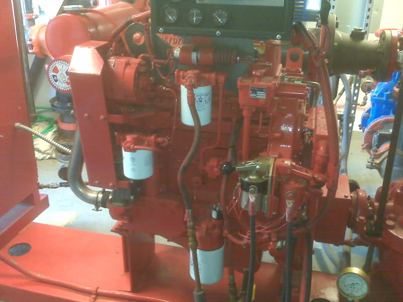

This is the Fire Pump Controller, of which sets up the rest of the story.

You see in that panel, is a mercury switch, and as I was winching out the bladder, apparantly I bumped it hard enough to make the mercury flow to the contacts, and that fire pump started up and was running at full rpm's in less than 2 seconds. Its on sort of a spring so that during a run its not vibrating all the relays and contacts. Well anyway after checking that I didn't crap myself, and that I had all my fingers, I ran outside to call the main office to inform them of what had happened.
All the horns and strobes were going off, and I had the secretary hit the signal silence in the fire panel, and we tried to call the monitoring company to head off the fire department dispatch....no luck there, and in a couple of minutes I heard the fire truck since we are only 2 miles from town. Fortunately I know all of the guys on the Fore Department and explained what had happened.

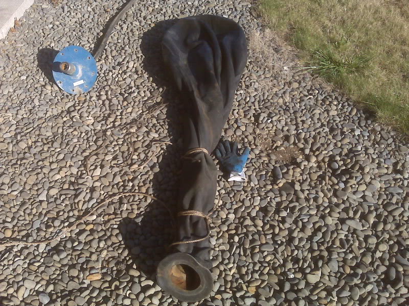

So anyway that was my Monday morning, and so I went back up to finish pulling the bladder out of the tank, here are the rest of the pics.

Getting the rest of the water out..

Home made spear..LOL
