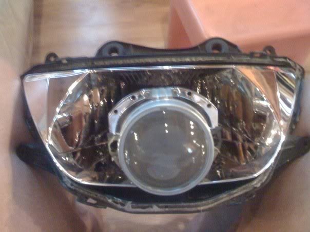

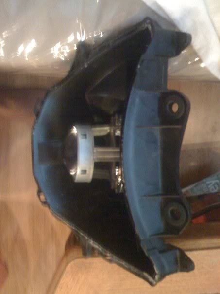

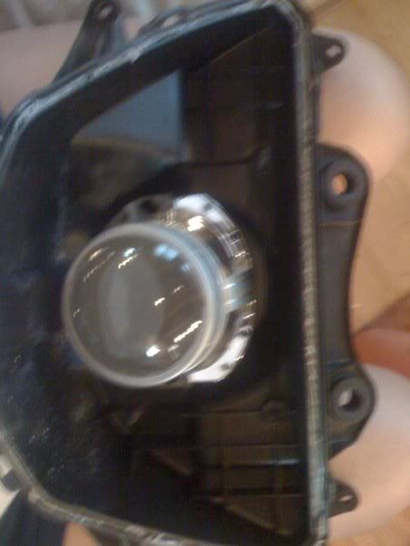

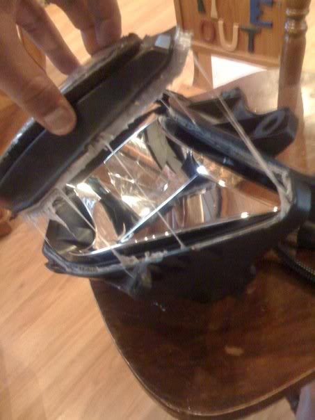

Progress so far...

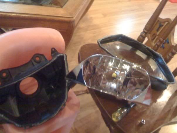

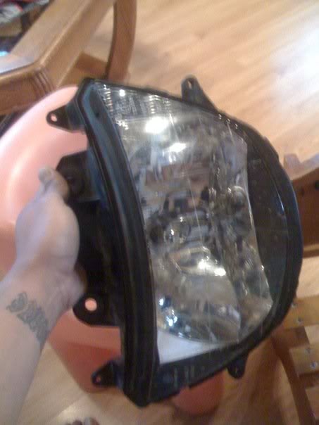

Now I just don't know if I should go without the reflector and put a shroud around the projector, or integrate it with the reflector even though it will be completely non-functional. If I use the reflector, I wont lose X & Y adjustment, but I might if I go without and don't come up with a good idea.

Progression...

She's done!
I will be installing it either tomorrow or weds.
