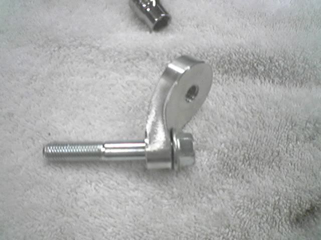

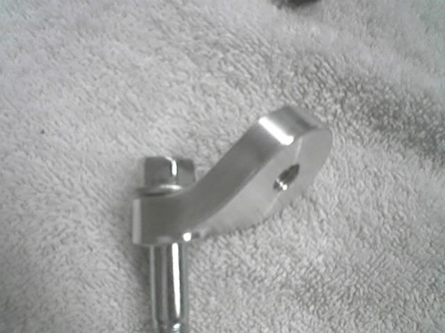

Hey so my frame slider is where your are littledevil, its attatched to the engine mount. I'd rather it be there that cut into my fareings, if thats what you guys mean. I can take a picture I guess later if you want. I havent replaced my puck and I dont plan on it anytime soon, even though I know I should or $20, I need to take it off and bend the mount back. But I dont know how to do that, I'm guessing I need a flame torch to heat it up to bend it back?. I just use the bike for school. BUt if you want a pic i can do it later.

here ya go
[IMG]local://upfiles/716/B33066EC5F6F4112A06E23CB4786BEA7.jpg[/IMG]
[IMG]local://upfiles/716/5983FD07FF7440F59C578F2C7B5EDC9C.jpg[/IMG]

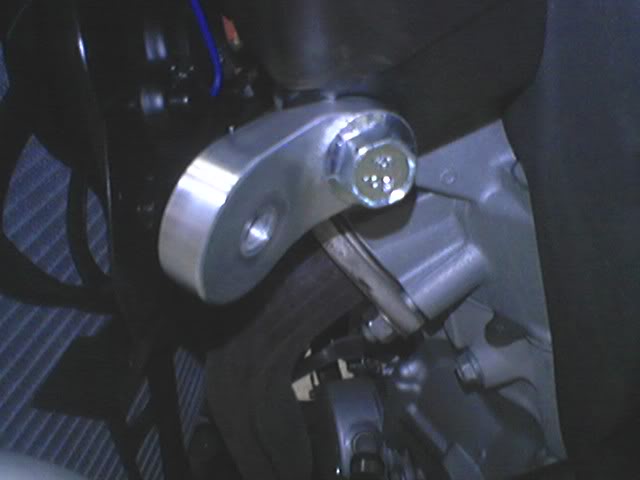

1 more, you can notice its bent
[IMG]local://upfiles/716/FF6D4FCFB229401398A23B8E50818015.jpg[/IMG]

Your sliders are in the place I should have had mine. If you look right above where yours are located, that hole in the fairing, that's where mine were, and see, it' cracked the fairing and the stupid bolt is still in the bike..lol
Your are in a good place Funkdock

Funkdock, Is the frame mount bent or just the slider spacer bolt? Also, if the frame mount is bent, just get it welded and redrilled instead of straightening it with a torch. It mar get too brittle and break. I am surprized that it bent the frame mount.

thats a good question. Now that i think about it and look at the picture again, I think that it is probably the engine mount bolt. If the engine mount was bent then it would be visible in the picture as well. Hmm...I really just planned on leaving it alone untill I get the time to get it fixed. Being that I only use it for school, I'm not overly worried. I know better safe then srry
