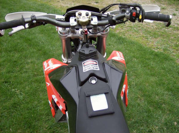

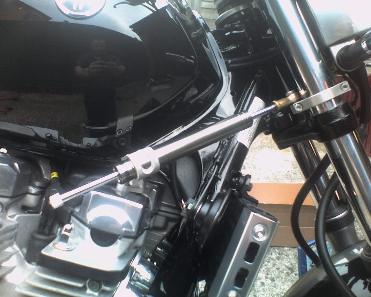

take for instance the hyper pro rsc. you can adjust it on the fly to whatever setting you like, but as your riding, the damper self adjusts to the conditions. a scoots rotary damper may be adjustable but its not active like the hyper pro. so, if you set it to stiff, it will stay stiff no matter what the conditions are. the big difference is this....
linear style

rotary style
