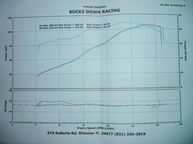

Don't mess with those buttons unless you know what you are doing... Those buttons configure your air fuel ratio. If you did mess with them get that bike to a dyno and have them do you a map. And no the PCIII does not have a rev limiter adjustment on it. Your bike should red line at around 14600 rpm.
