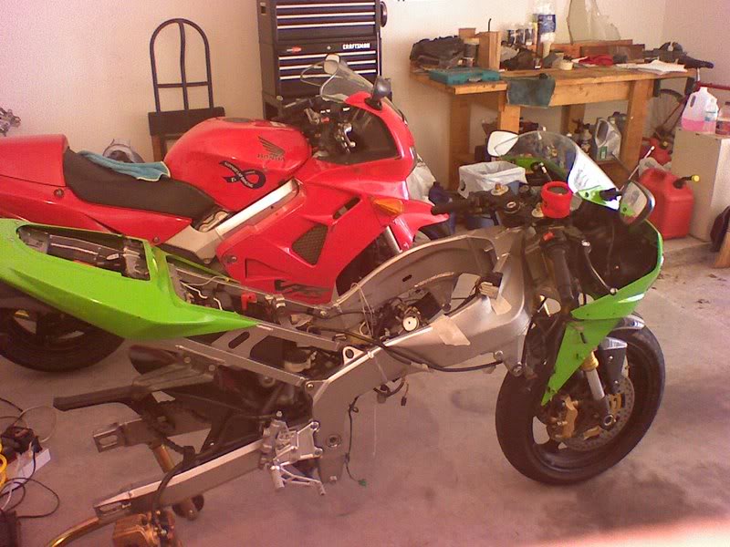

This thing never ends! A year ago I had a totaled racebike with a noisey top end and and bad transmission.

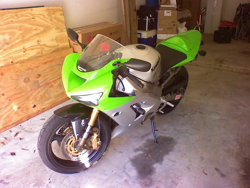

By the fall, I had a street bike with a perfect transmission and a still disturbingly noisey top end.

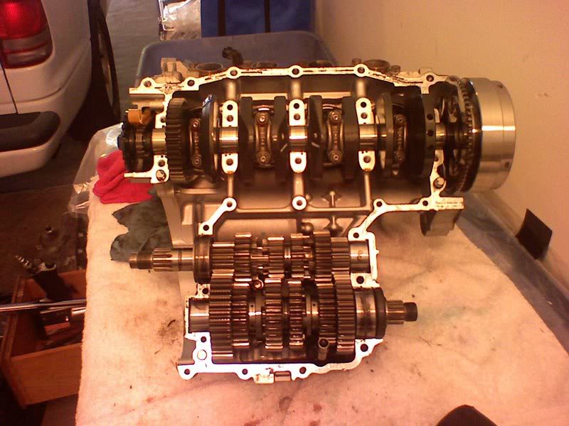

First project was to rebuild the trans with two new gears, a new shift fork, and the Factory Pro Shift Star.

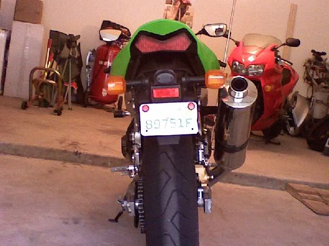

Then on to ebay for whatever plastics I could come up with. Silver sides to match the original tank, and some really too nice to pass up green pieces on the tail and nose. All in all, I ended up digging the two tone look. Lights and signals to make DOT happy, of course. For some reason I wanted to go all stock with the tail, including fender and signals. Everyone takes them off, gotta put them on to be unique!

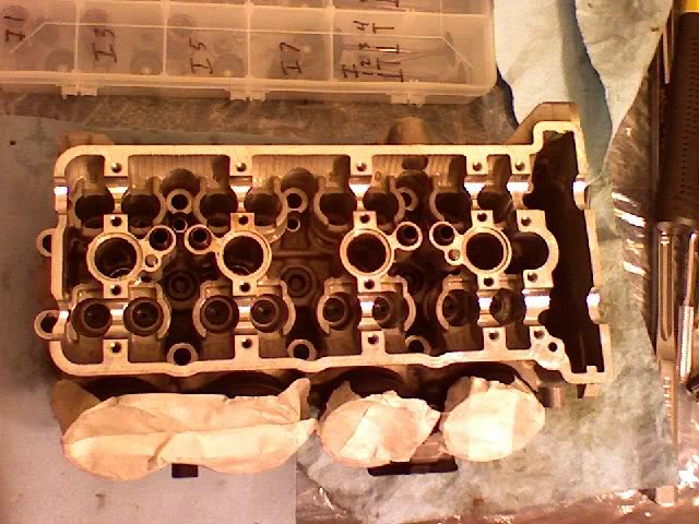

Got the head off, and valves out. Now what?!

I guess I can see what they think over at the shop. All the valves and keepers looked ok coming out.
Maybe re cut the valve seats, rebuild the head with some new parts, and maybe think about splitting the cases again to replace the chain.

Mechanic is saying after looking at the torn down head that should probably replace the valves. That was a shocker! Said may as well do the springs too. The valve keepers are too worn, and that is what is causing my ticking noise.
