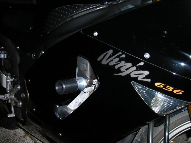

hoedogg is right. Inside the front wheel panels. Take off the panels and then take out the blinker, The flush mount goes right in and then reverse the process. Takes all of 15 minutes.
You have this style right?
