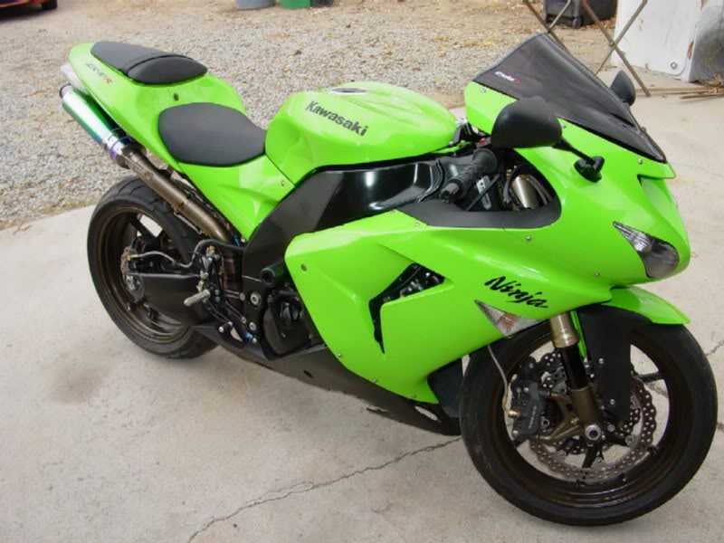

My heat shields are gone and I am trying out my experiement with the brake res. I do not notice any abnormal heat, but I do not ride with a passenger either.

where is the res drag??? can't even see it[:-]

i'd be a little worried about that hose running next to the exhaust pipe. wrap it up with its own heat shield and you should be gtg
Old Feb 5, 2008 | 10:41 PM
Default RE: heat sheild
The stock line is double layered from the factory. Yes it is close but not touching the exhaust. I used my peg feeler to cap the line, the threaded end isthen boltedclose to the battery/right side cover. This setup will not work with the stock rearsets though.

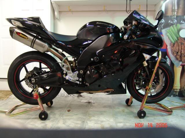

I ordered a prat from HRC Racing. I just looked up rear break reservoir eliminator on E-Bay and it came up. After getting it in I see it would be easy just to make your own. I think it really cleans up that area.
Old Apr 3, 2008 | 02:15 AM
yes, an easy enough fix if you were aware of what material the line will be made of, and where to attach it. Looks great Evildoer
