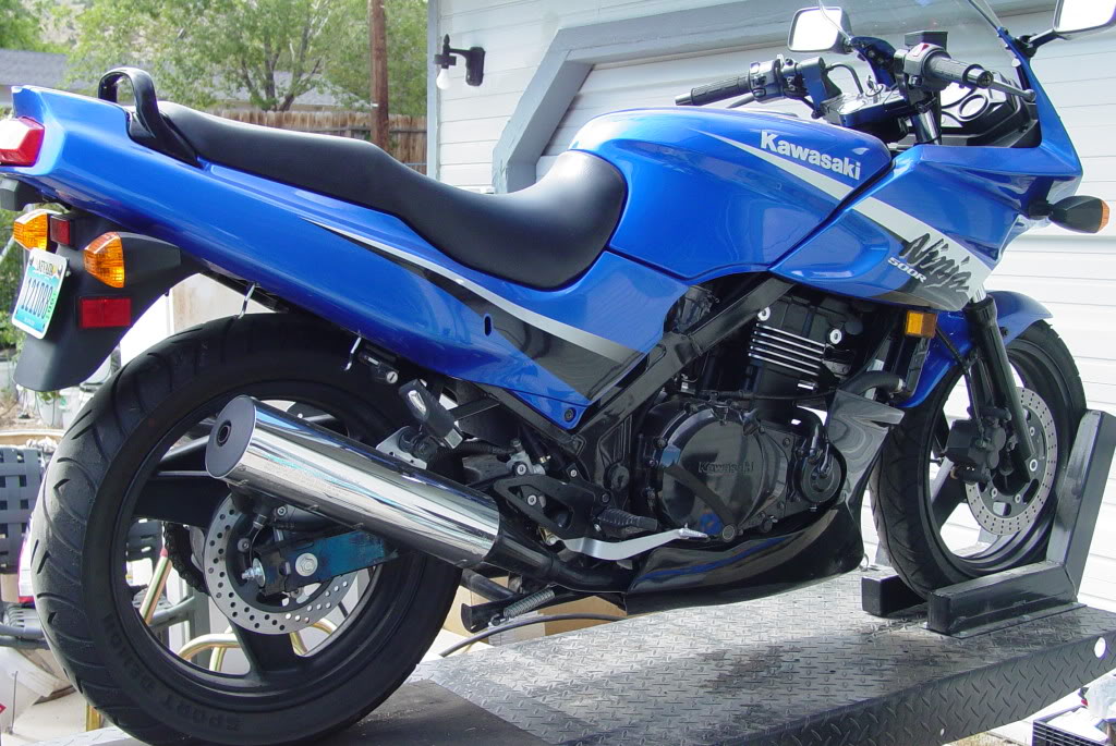

The 110 with 1000 road miles and lowered tire pressure for the last half day of track time.
A little bit of view of the rear tire. the 140 fits well, do not go any bigger though. this is all on stock suspension. As you can tell by the ground down side fairings and of the tire wear, suspension needs tuned for any aggressive riding. Here is a pic of the ride after the return ride back home and up on the lift for inspection. Not sure if the 140 rear was a cause of the first lap pushing or not. But once the tires warmed up, the other laps were actually not bad except for the suspension issues and my lack of experience on the this ride.
