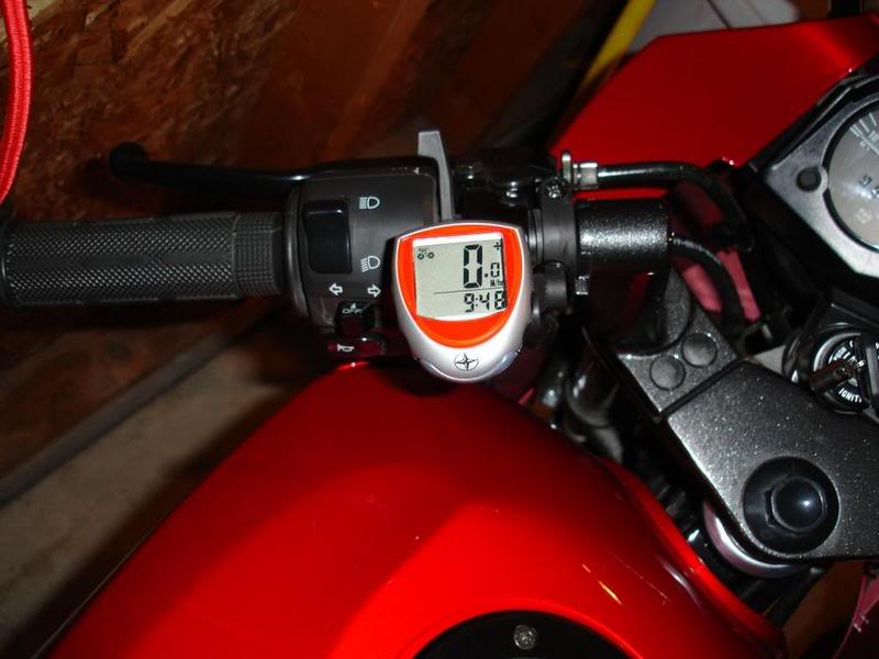

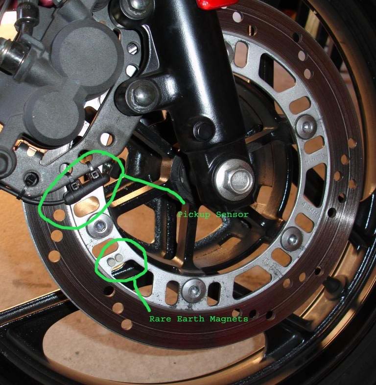

Here is an add on where I installed a cycle computer on my 250R. It is fairly easy to do, and out of it, you get to know your 'actual speed' (factory speedo off by 10%), as well as having a clock, and temperature gauge. The only tough part was finding a spot to mount the pickup sensor. On Ninja 250 riders club, they show this mod, only they glue the pickup sensor on the fork. I didn't want to put epoxy on my own fork, so I found a better spot to mount it. Everything else you would need to know can be found in these two articles: Method 1, Method 2
Here are pics to show how I mounted everything up:

The only problems I have found with the cycle computer I used is that the speed readings are delayed for about 1 second, and for some reason, over 60 MPH, the readings go haywire! I think that has to do more with the brand of computer I used. This one was pretty cheap, ($19) so maybe the better computers will work at the higher speeds.
