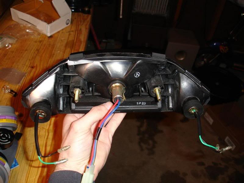

The clear alternatives lens kit was somewhere around $75, and came with the two side pod sockets, the turn signal bulbs, and of course the three clear lenses. The center brake/running light bulb socket on my 250R is factory original, and the bulb fits good and secure for me. The center brake light uses the 1157, 2057, 1034, 2357, and 2397 bulbs. All of these should have the same socket size. The only difference is in the wattage. If one of these bulbs are in your center tail light socket, and comes loose a lot, replace the socket. (And if I remember the setup correctly, that means replacing the whole tail light housing assembly.)

Looking back at this picture, the center socket probably does come out. Hopefully it isn't pressed into place, or else it may be a PITA to get out.

The clear alternatives lens kit comes with the pod sockets. Otherwise, if you want to eliminate the old stem style turn signals, go to Autozone or some other local parts store and buy an 1156 or 1157 bulb push in socket. I did this before receiving my lens kit, and the ones sold at Autozone seemed to be the best quality.
