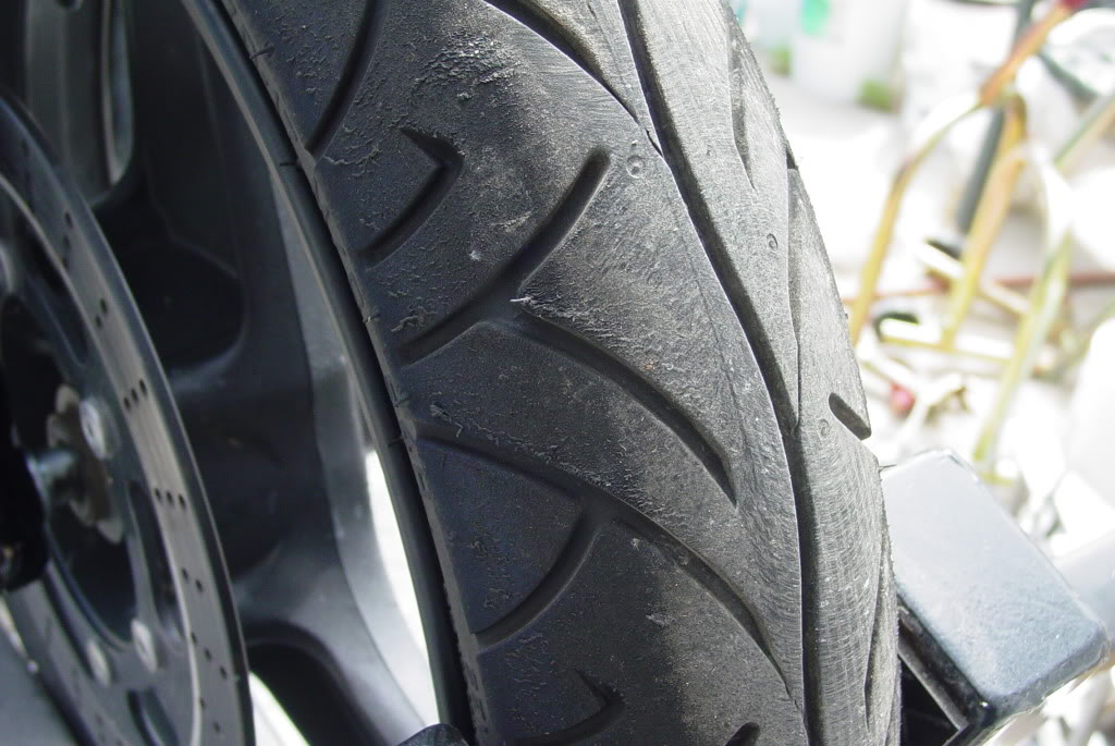

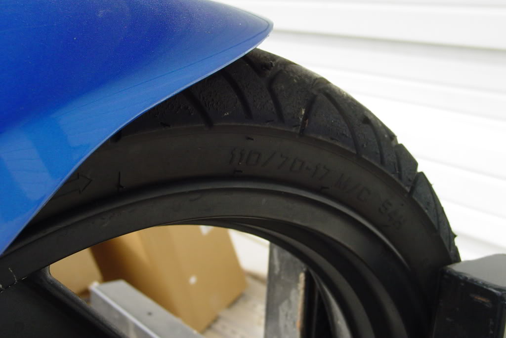

You may note that certain under sprung and dampened rides will cup the dunlop tires pretty fast. Most of the harleys and EX bikes will do that. If you can, set up your suspension as best as you can anyways. The sport demon wears pretty good and also offers pretty good traction once warmed up. I pulled a 1700 mile road trip on mine and a half day of track time with really no complaints. (I lowered the tire pressures to 26psig hot at the track and you can see from the wear that the suspension is not setup)
