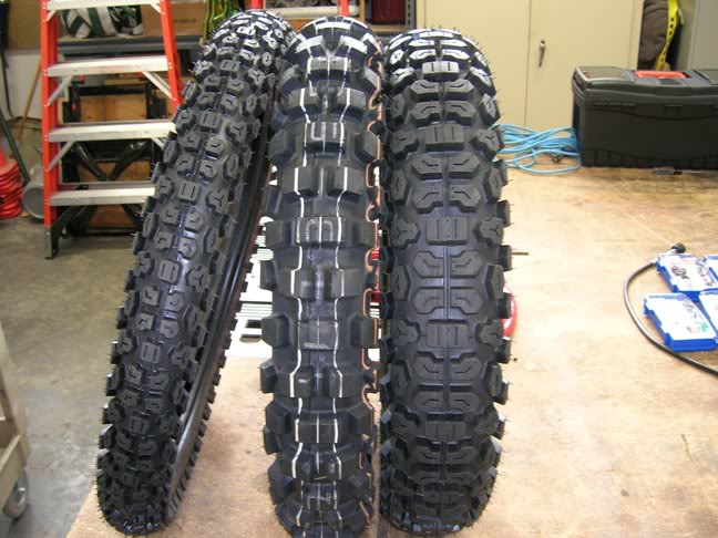

That Shinko tire will last a long time on the road, but mark my words, the first sign of mud or wet grass/moss on a single track or even loose gravel and you are done! I like Fuller_Malarkey's writeup, you really need to think about where you are riding. Personally I would rather wear out a tire a little faster on the blacktop than get stuck or drop a bike when you need a little off road traction. I had over 5000 miles on my Kenda K270 before I switched back to the Dunlop 606 and it still has about 50% tread left. I just found that I wanted a little more traction off road. besides for me and this goes back to what Fuller_Malarkey said, I looked at my situation and really I only have to go 5 miles or less to get on all of the gravel fire roads and trails where I live. So I guess most of my riding is off the blacktop.
The reason that I went back to the Dunlop was that with the more spaced out knobbies on the tire I found that with our type of gravel it allowed the tire to absorb the rocks instead of trying to float on top and get a little squirrely. The Kenda has a lot more and smaller blocks that allow for longer wear on the road, the 606 has less and taller blocks that give you good grip. I would put those two tires in my top list.
The mileage on both tires before it was time to replace was 5000 on the Kenda and 3000 on the dunlop. Nobody though can really decide what tire you need. We can steer you in the right direction with ideas on how to pick one but ultimately, look at where you ride, what you ride on and pick accordingly.
Here is a picture of when I first got the Kenda and the 606, compared side by side to each other. Good luck on whatever you do.
