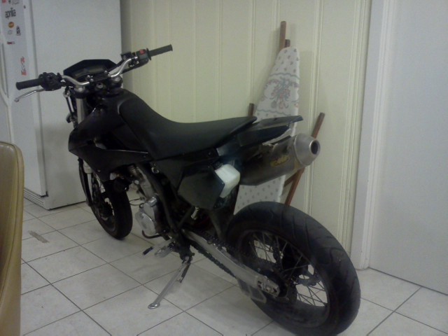

New member here, just picked my 09 up about 3 weeks ago with 0.3 miles and have 1500 or so miles on it now. I do alot of highway riding so I picked up a 14t counter sprocket and an FMF powercore4 muffler. I have some new ideas for the bike but i'm trying to do things slowly so I don't interest in this project. I chopped the tail up last night and I think it came out good. I'll be posting all kinds of updates here over the next few months. I ordered a sumo fender for it today, I want taller seat foam and handle bars/hand guards next week, remove the airbox and move the battery/overflow tank under the seat and finish my slim fiberglass KTM style side panels over the next 2 weeks, FMF header after that, and then a 351cc kit and hose kit when i'm out of things to do. I like making my own stuff, luckily this bike has tons of improvements to be made!

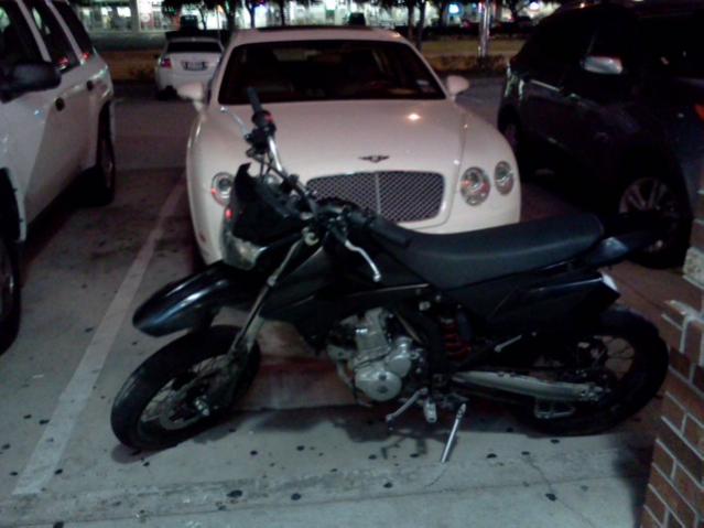

I think I cut close to 8 inches off the subframe and reused to stock quick disconnect for the tail and license plate lights. Saved a few pounds off the back, the license plate is tucked away but still clearly visible

I figured more people would be interested in the tail section.. it looks a million times better without that tumor on the back

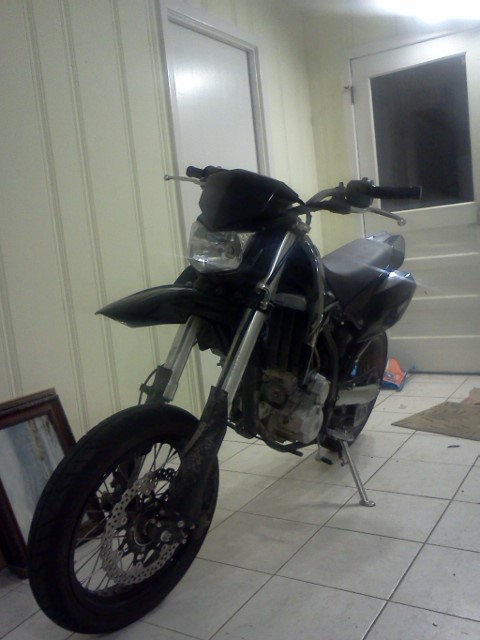

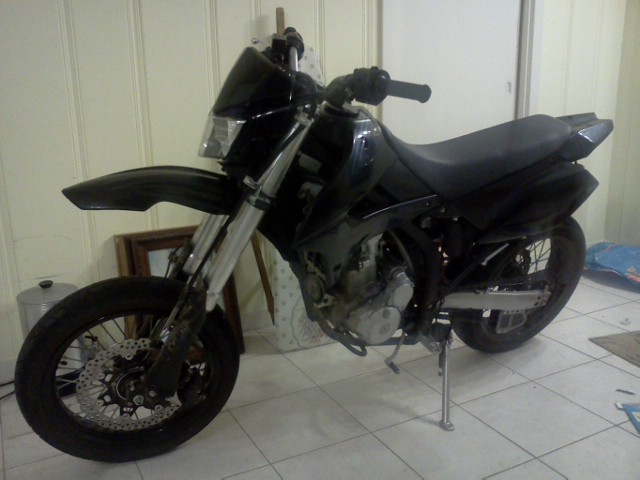

You mean a different front or rear fender? I like the rear now, its short and aggressive looking. Plus it sorta made the back tire appear a little wider or something. If i'm running through rain the least of my worries will be a wet backside haha
For the front I installed a Cycra SM fender, looks nice and just BARELY clears the frame, not enough of a problem to worry about cutting it. It may touch the frame while i'm riding down the freeway but sitting still it's about 1/2 cm from it.
Terrible picture I took tonight, I need a real camera

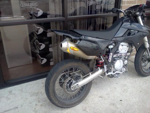

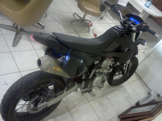

Here's a couple better lit pictures from my kitchen. I need to purchase a real camera, it's on my list of things to do this week.

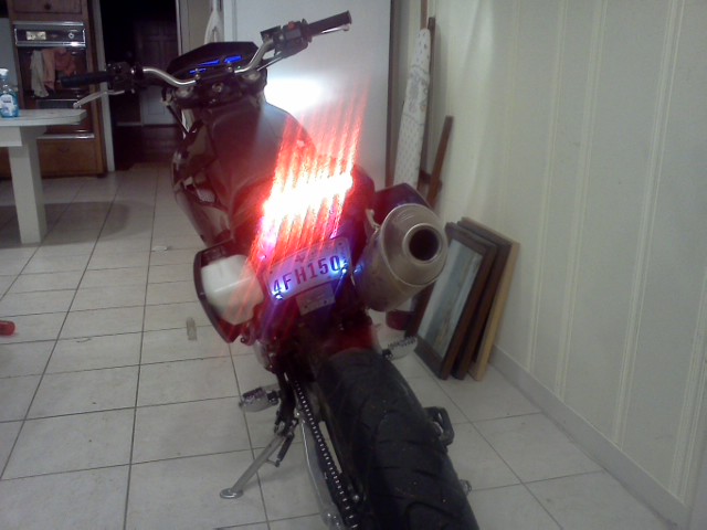

Here's the tail on, I couldn't find a good way to snap a pic of just how bright those license plate lights are. They shine upwards and the whole underside of the bike has a bit of a white glow
