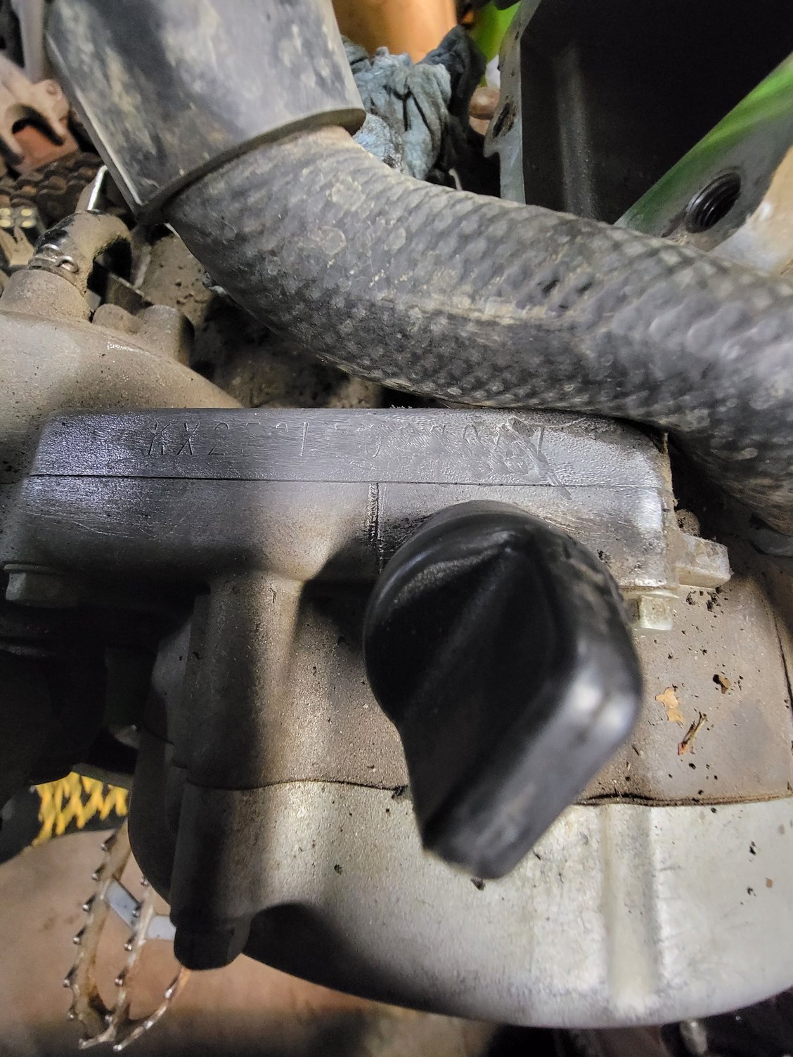

I checked my reeds and they were broken. I would like to purchase replacements but not I'm not sure what engine I have. It looks like someone scratched out the VIN on the engine. My speculation is a PO moved items from a '02 to my '01 frame. If not all, atleast some and now I don't know what is what. Luckily it looks like these years are pretty interchangable, but i also ready and 2002 has some YEAR SPECIFIC parts.

Engine Vin

Contact the seller concerning the engine.
Sounds like you are figuring it out. It will take a little time for sure.
