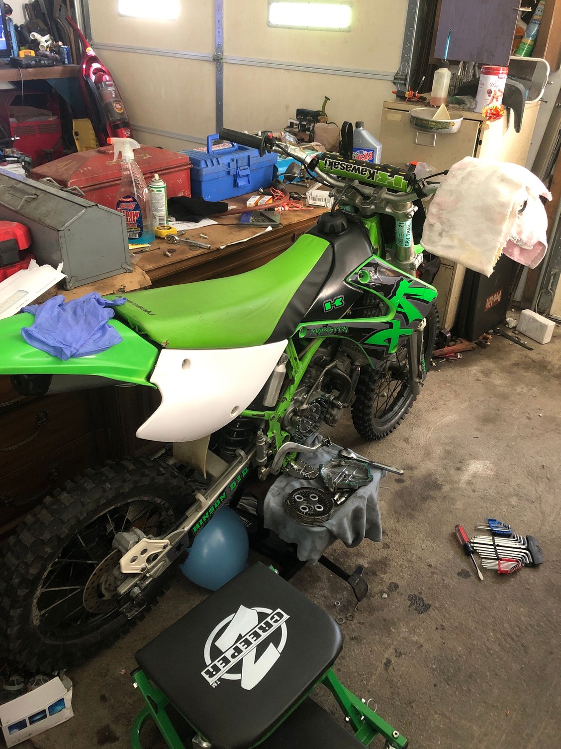

I have a 2001 kx85 im having clutch troubles ive bought two clutch cables both had too much slack in the cable a motion pro and oem I tried adding some washers helped a bit but still could not get the clutch to engage what so ever i pulled the clutch cover and clutch pack. baskets fine just ordered clutch plates steel plates springs all looked fine but replaced them
anyways as well as the clutch arm release lever as that showed signs of wear and I ordered a couple shims for the clutch release rod because i saw a video of someone saying it would move back the position of the clutch arm release lever hoping that will help with the slack in the clutch cable anyone have any experience with this or any knowledge of the clutch thank you
