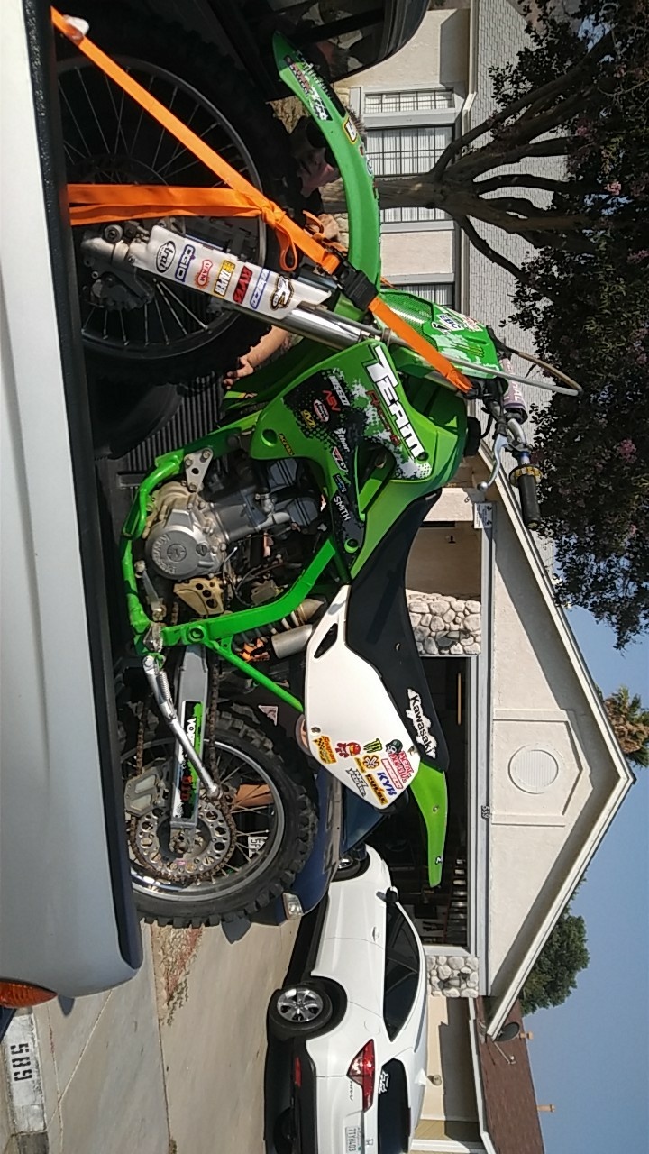

Hey guys my KLX 300 has no headlight or rear brake light. Im thinking about installing a small light bar on front of it where a headlight would be. My only concern is where would i wire the light bar to? Usually i would think to a battery but the klx dont come with batterys but they do have head lights. So would i wire it to the stator or magneto? Will that have enough power to light up a small LED light bar? Need help!
