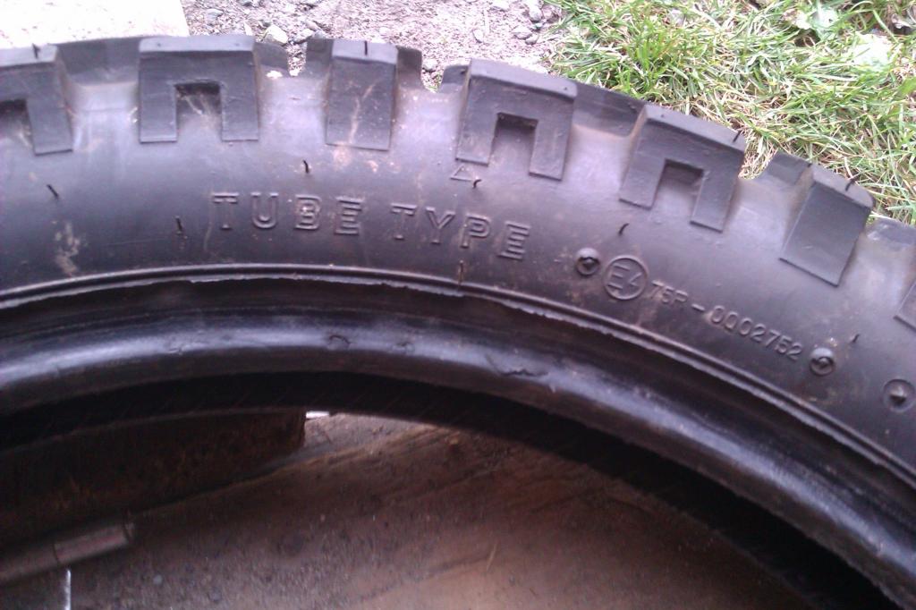

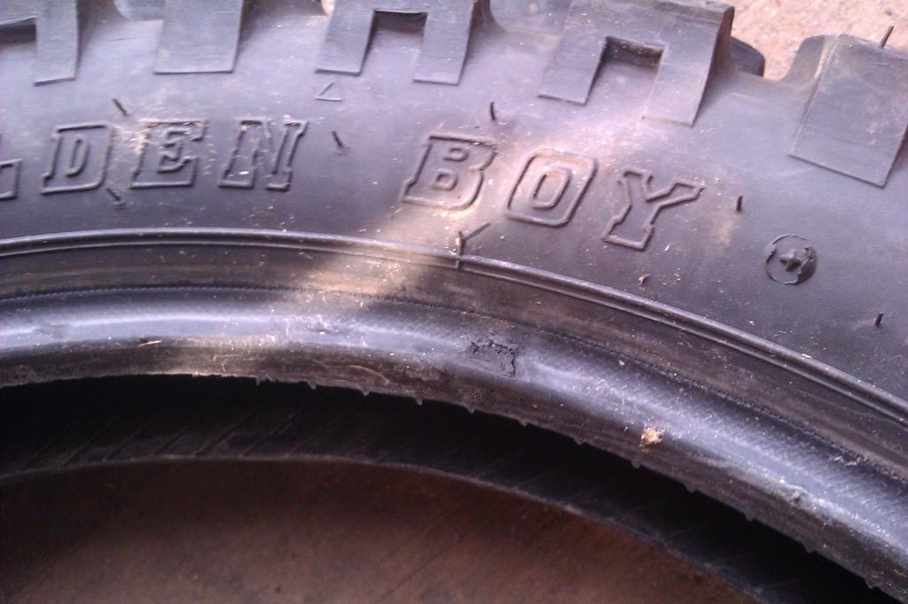

I got a used tire that would fit on the back rim of the bike. There are some small nicks on the bead resulting from poor mounting technique I guess. They don't seem too bad. My plan was to "repair" them using rubber cement or something similar.
Do you think it would still be a safe tire to use once repaired?

Assuming the structural beads under the rubber are not damaged, I would use it. You are running tubes and the little KLX won't be generating severe forces on the tire.

No need to repair them. Use as-is.

Once there is air in the tube it will lock that bead onto the rim. No problema.
