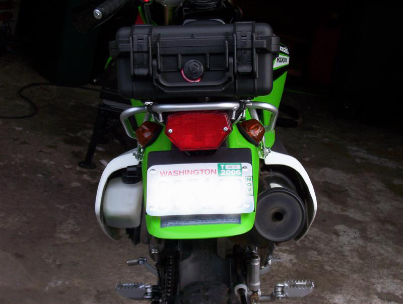

My guess is the bulb needs changed, its a dual filament lamp, I have had issues with bulbs. But on a related note, check out what a few of us have done with the tail section. Here's my bike, and a link to where you can get the replacement light. If you want, pick up a orange or red 12v light tester. Give it a good ground, and check both wires to the tail light. One should be hot with the key and the other one should be hot when applying either of the brakes. I had to edit my post, I forgot to welcome you to the site and the bike. Remember that you should take things at your own pace, don't try to copy what other people do, but rather get familiar with the bike, and then experiment and have fun. Stay safe.
http://www.motorcycle-superstore.com...661&Division=6
