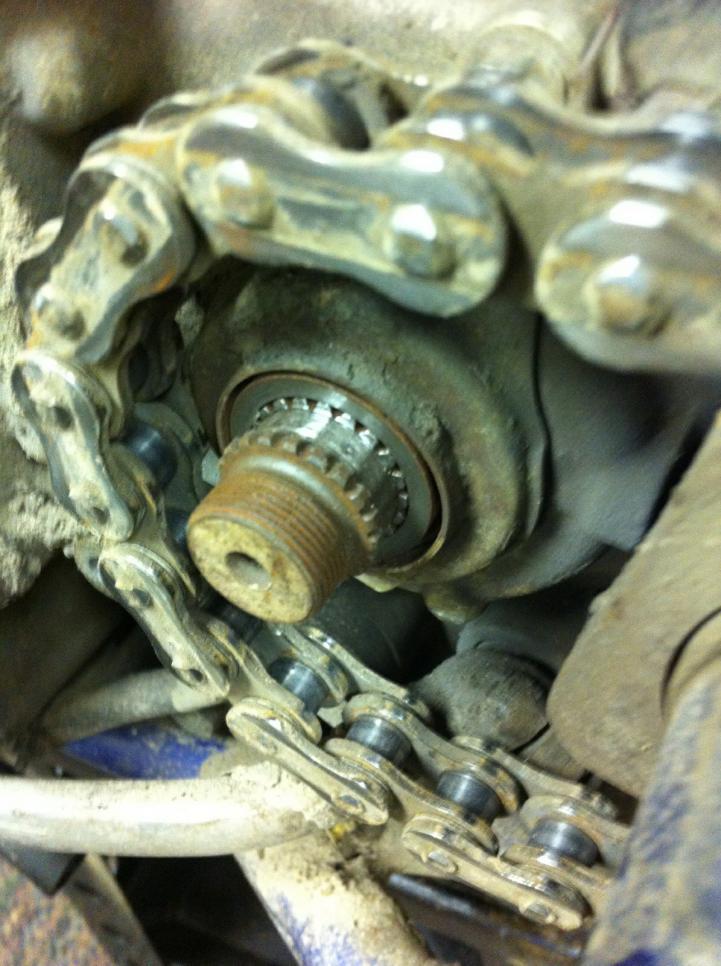

Well a little bit about that
My B/F had a WR250F and it did not also have a cush hub
what happened to his was the gear stripped the output shaft
so he welded the gear onto the output shaft not even 200 miles later he blow apart his transmission
i believe that the KLX must have some kind of cush system intergraded in the transmission its self
other wise we would be seeing the same results as my B/F's bike

Leaving all other bikes and situations out of the discussion...how many blown hubs and drivetrains have we seen reported here and elsewhere on the KLX250R, KLX300R, KLX250S, or KLX250SF?
Zippets, I'll contend that you BF's problems weren't a result of the lack of a cush hub.

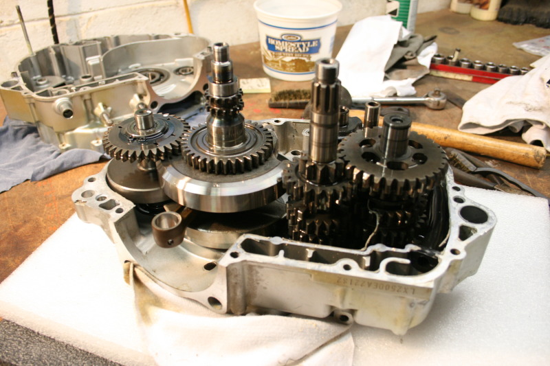

Old Mar 25, 2014 | 09:32 PM
No cush anywhere in the transmission. Solid gear to gear, metal to metal, power transmission all the way to the rear wheel. I know this because i had every last bit of my engine apart last winter after I cracked one of the cases. I even bought a used transmission gear set off eBay beforehand, just in case I found a trans issue once I got into the engine.
Dan
