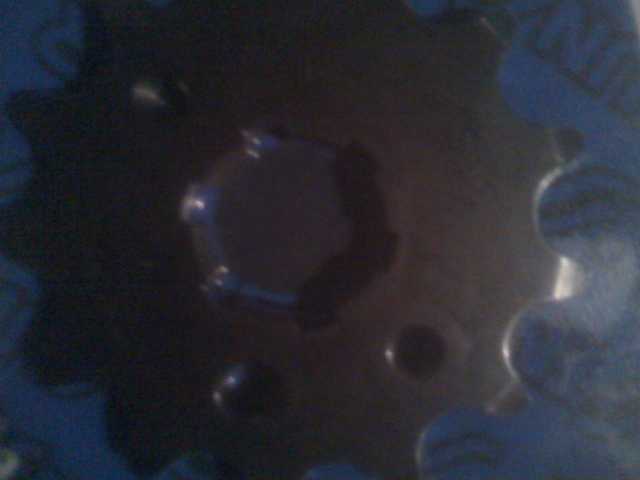

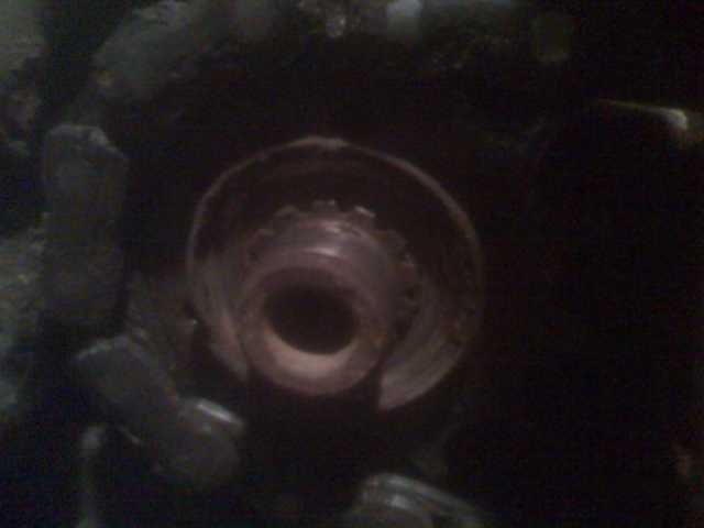

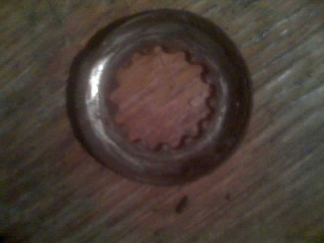

ok well i decided to go from a 14 tooth to a 13 tooth sprcket on my 2003 klx 300r so i ordered the sproket up to the dealer the one that came was made to fit a compleatly different output shaft then what my bike has, the funny thing is that on the package the new sproket came in my bike was listed... so im posting up a few ficks and im wondering what kind of bike i should order for to get a 13 tooth sprocket to fit my bike my bike has an output shaft with 13 splines on the shaft where as the sprocket that came was made for an output shaft with 6 splines.

Looks like you've got a KLX250 with a 300 kit on it. Ge ta sprocket for the 250.

do you have a klx300r or a klx250s with a 300 cyclinder? the front spocket is not interchangable between the two bikes. If you really have a klx300r then that 650 sprocket will not work.....sayin.
