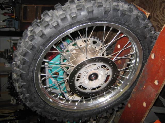

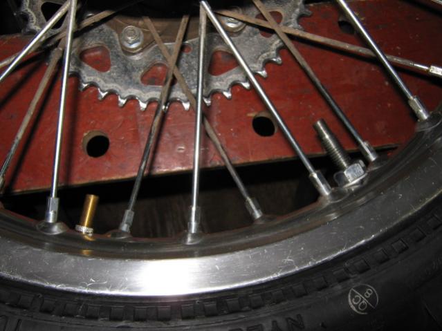

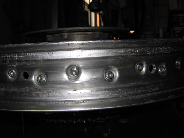

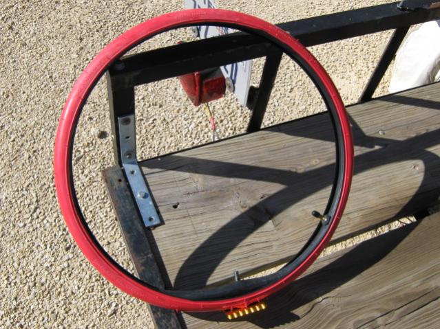

Anybody know what the heck a message with a "security token violation" is when you try to start a new post? I started a post to report on installing that Nuetech Tubliss setup on my KLX today, but I keep getting that message. Big waste of time.
I got the whole setup done without any real drama. Just need to go ride it now. It was a lot easier than I though it would be.
Attached Thumbnails Who has rim locks on their KLX?-img_0080.jpg   Who has rim locks on their KLX?-img_0083.jpg   Who has rim locks on their KLX?-img_0084.jpg   Who has rim locks on their KLX?-img_0085.jpg   Who has rim locks on their KLX?-img_0086.jpg
