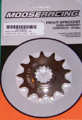

2009
700+ feet a.s.l.
250cc
09 DJ kit. 128 main jet, stock pilot, a/f out 2.5 turns
Twin Air filter
snorkel removed
Two Bros. M-7 slip on w/ stock header
smog stuff removed
93 octane gas
13 tooth counter sprocket
runs good... probably going to try the DJ 132 main real soon. i still think its a little lean w/ the 128.
