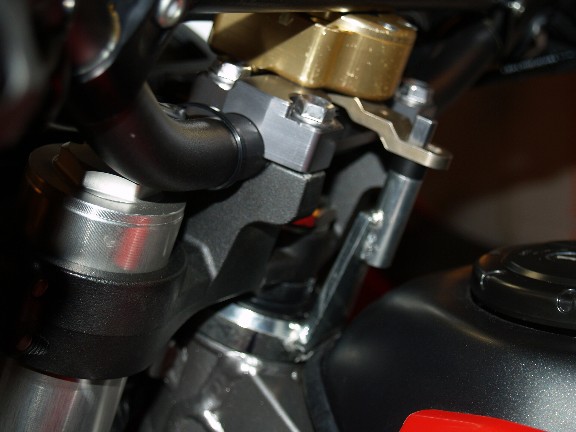

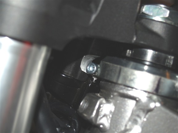

Scottsperformance dot com lists them for the 09 klx250s. But.... the kit is not bolt on as the top triple clamp casting for the key mechanism needs to be clearanced for the bolt on post. If the bolt on post clamp/allen head were clocked at 8:00 instead of 12:00 it would be a true bolt on kit. Clearancing took abit of refitting to make sure there wasn't any interference, but wasn't a biggie.

i was just about to make the purchase then saw your pics and got worried that i would not be able to install myself.

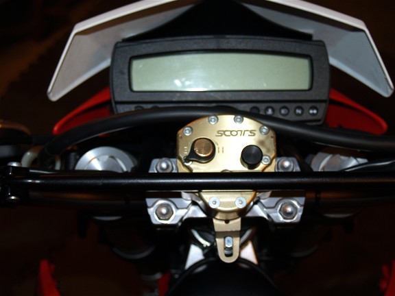

also, i have a bar pad that has come in handy many times, i guess you cant possibly use one with this stablizer?
The renthal bars came with a spiffy cross bar pad. I thought about trimming out the part where the stabilizer is, but then it would have to cut into the neato cover. I dunno I still might do it... it could be easily done. But then the easy access to the adjuster **** would be gone & I stiffen it up when hitting the freeway.
If I were going to modify another triple clamp for the recess, I'd use a 4.5" x .25" grinding disc while fitting it to the frame/bolt on post. It would alittle more precise. I used a grinding bit in a 90 degree angle air tool b/c it was what I had at home, and the bit was atouch to wide. All it took was about an hour.
If you want pro tapers/1 1/8" bars a brp or scotts upper triple clamp might be able to be used but you probably will loose the keyed ignition mounting part. They don't make a upper bar clamp/stabilizer mount when you use fat bar adapters with the stock upper triple clamp - I asked around.
