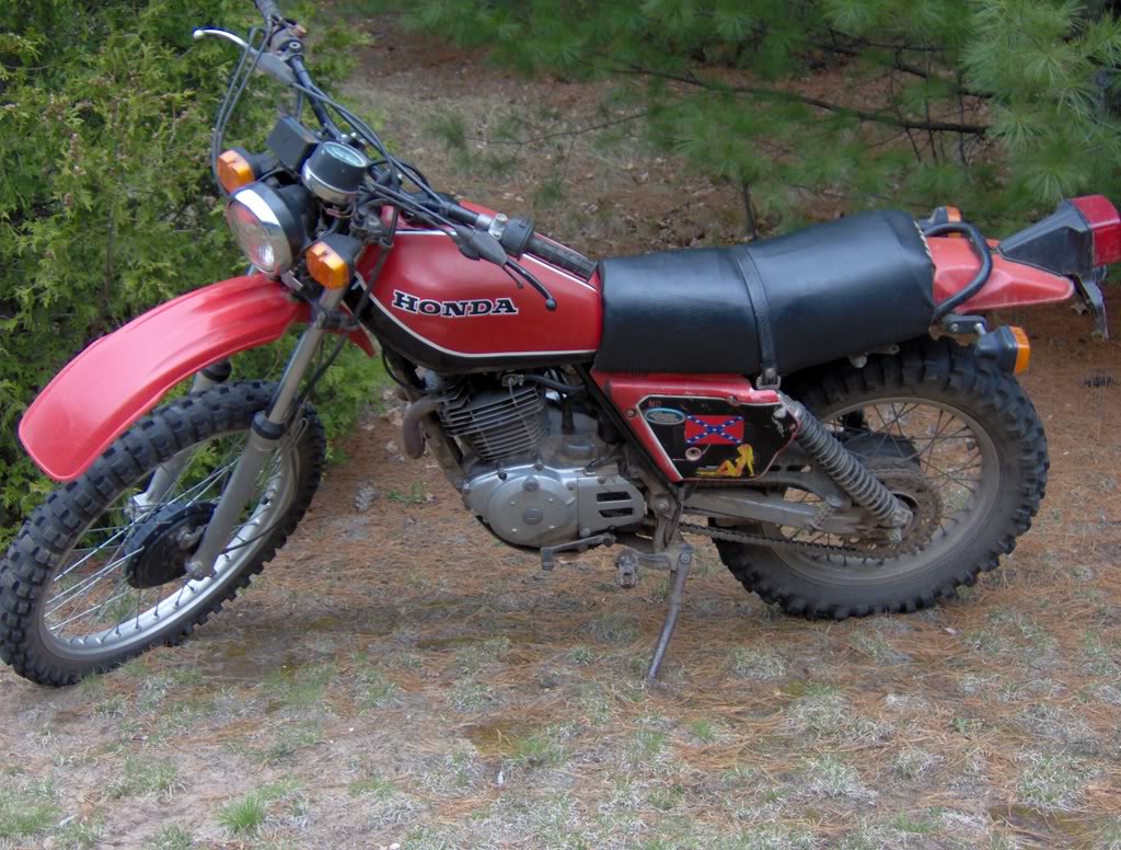

IIRC, it used a 6v electrical system and the battery would run down after only a day or so if not ridden so every time I went to start it up, my 5'4" 145# *** would have to push this 310+# bike up a rather large hill, coast down and attempt to bump start it 3+ times before it would start...
Most days, by the time I got it started I was too tired to ride it, LOL
To this day I will never own a Honda, based entirely on that PTSD inducing bike.
