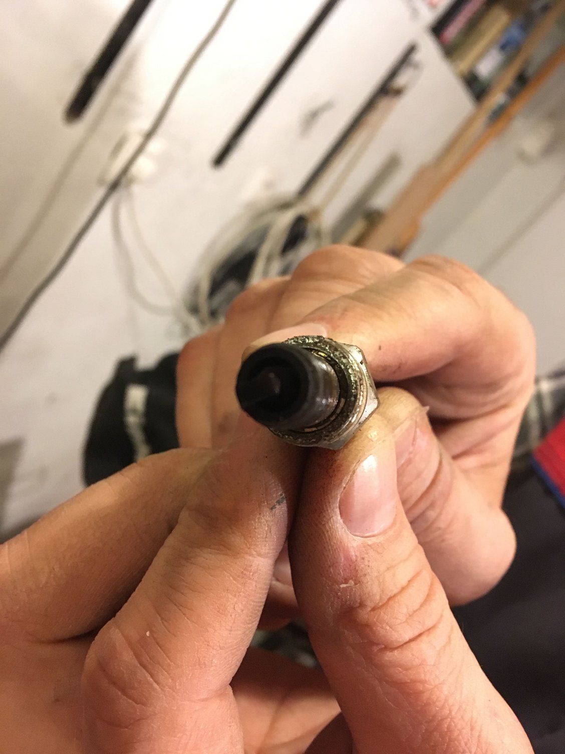

I've recently bought a 2009 KLX250S EFI bike. It is in pretty good shape with 33.000 kilometers, but it has some problems.
- It starts really difficultly, I assume that a bike with EFI should right turn up with a flick of the button. But sometimes I have to hold a button for 5-6 seconds, sometimes it doesn't even starts for the first try. It has the stock air filter which was really dirty when I bought it. I washed since then, but I'm gonna a new one soon. I checked the spark plug and to me it seems to be too dark, so I have the feeling that it doesn't get enough air.
- The bike makes a kind of rattling noise between 4000 - 6000 rpm especially during deceleration. After some research I think it could be the automatic chain tensioner, but not sure. Haven't checked the valve clearances, but gonna soon.

that plug is wayyyy to black, looks really rich to me

I think the same, but with EFI I can’t do anything elso then changing the air filter.
Am I right?

I'd wait to check the valves to see how those look. My plug was heading this direction but both exhaust valves were out of spec by a tiny bit open. After the valves changed and a new plug it starts soooo much easier

The rattle is likely the automatic cam chain tensioner. I don't recommend removing and reinstalling, or trying to force an adjustment. Get the manual one from Krieger and follow his instructions for installation and adjustment.
Check, and if necessary, adjust valves and replace that plug.
