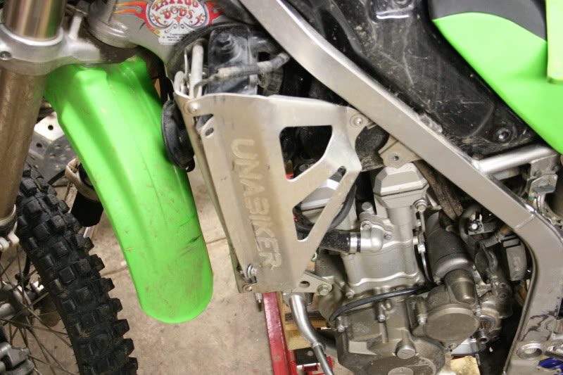

I also highly recommend them. Those radiators are very expensive. I had a couple good get-offs back in November but didn't notice any damage until I started doing some maintenance recently. The unibiker guard on the left side was caved in a bit. I straightened it out easily with some pliers. I'm pretty sure if I hadn't been running the unibiker guards, I would have been shopping for a new radiator, or seeing if I could get mine repaired. Back a ways Nobrakes , here on KF, just about impaled his radiator with a small tree. He was very glad he had the guards on that day.
Dan

Got the Unibiker braces today and installed them, I had to test fit first for clearence on the left one but no problems just loosen it tweek and retighten. Install was 35 minutes and was strait forward as the instructions were ok and his manufacturing process is improved from the old days and fit and finish were nearly spot on. I didn't snap any pics as the install was too easy and could be done without the instructions if necessary. Also picked up a butt plug for the muffler to keep water out when washing it, a fork support for when I haul it so I don't crunch the forks and some of those Padded disks that go on the grips, I don't know why but I like them.
