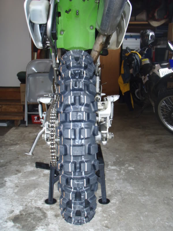

Dunlop D606 120/90-18 rear and Dunlop D908F 90/90-21 front. Best compromise by far.

606 baby!
i just put this on my bike, hoping the front doesnt wash out in the sandy stuff and doesnt cup like the 606. last rear was a tm2, but i wore that out so quick i had this a month later.
