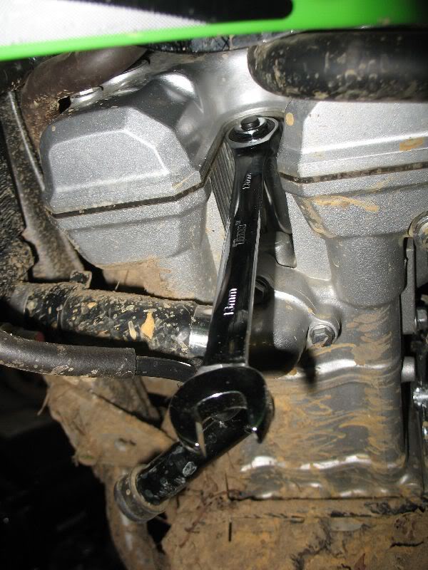

One tool that I added over Christmas was the best solution I've found to removing the KLX sparkplug. It's a combination of a 13mm GearWrench look-a-like from Northern Tool, a 3/8" drive socket adapter, and a 5/8" deep well socket. It fits inside the opening in the engine head and has a fine tooth ratchet that allows reasonable ratcheting action. Works really slick...here's some pics:
[IMG][/IMG]
[IMG][/IMG]
[IMG][/IMG]

Good idea about removing the plug but I haven't had a plug problem on a 4 stroke for many years now. I don't even carry a spare plug on the KLX. (I'm not suggesting that is wise though. ) But that does make it easier with the Clarke tank as the Clarke tank makes plug removal with the stock tool very tight. And I have all that stuff already. My plug socket has a hex head so I don't need the adaptor.

Thats the same solution I came up with. My adapter was from craftsman but I dont know if they still sell them.
