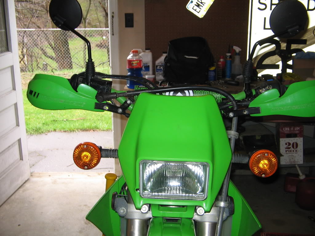

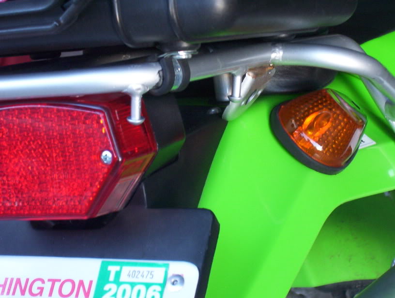

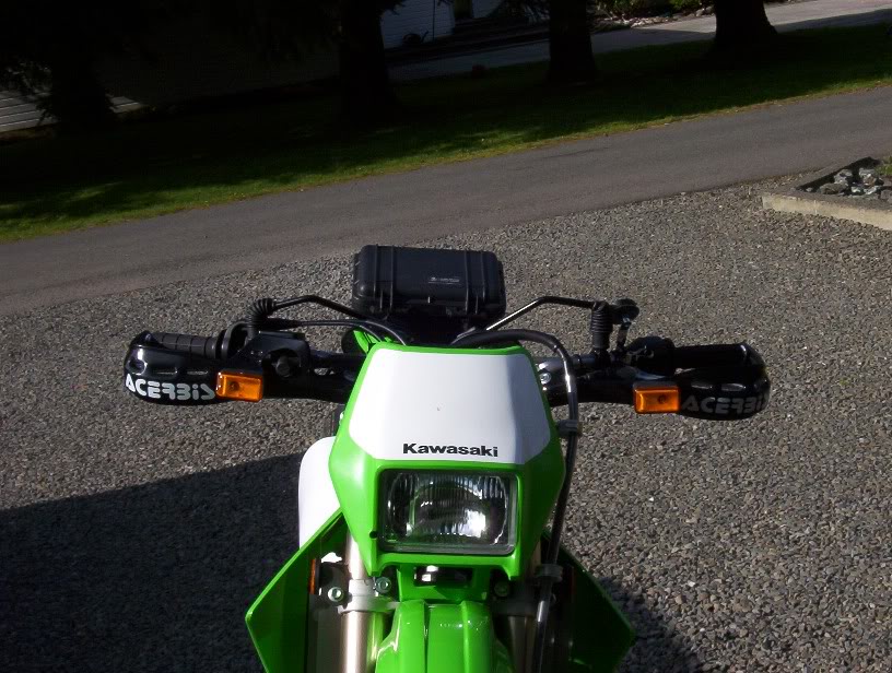

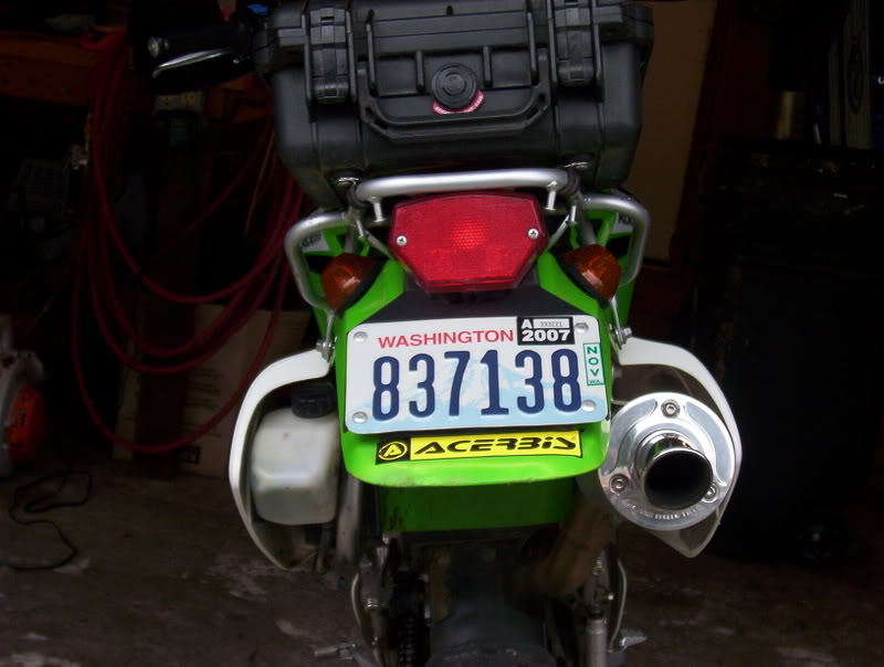

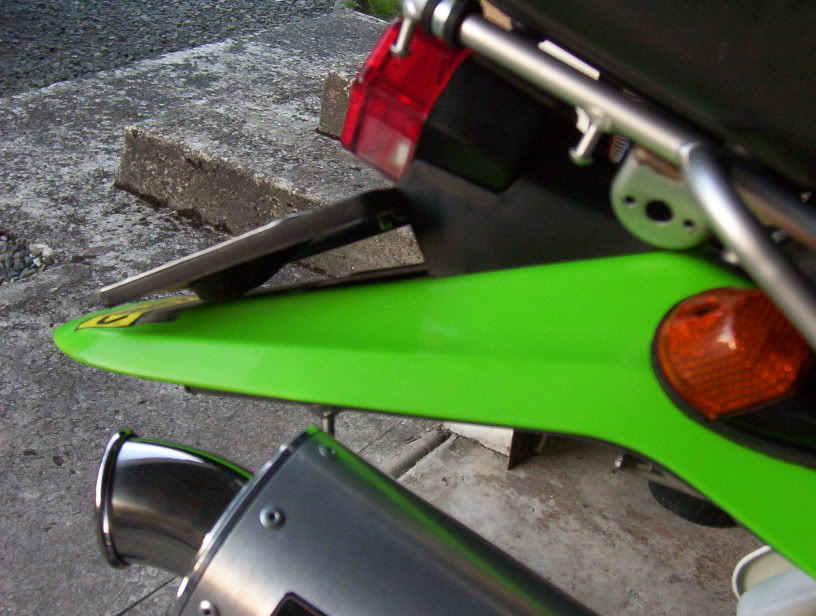

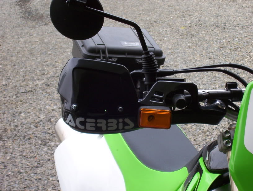

Acerbis dual sport rally hand guards with the built in blinkers. 13-48 gears, flush mounted rear turns. Here are a few pics. Of course I have yet to drop my bike, but I know the day is coming.

You got rid of that low hanging plate holder right?

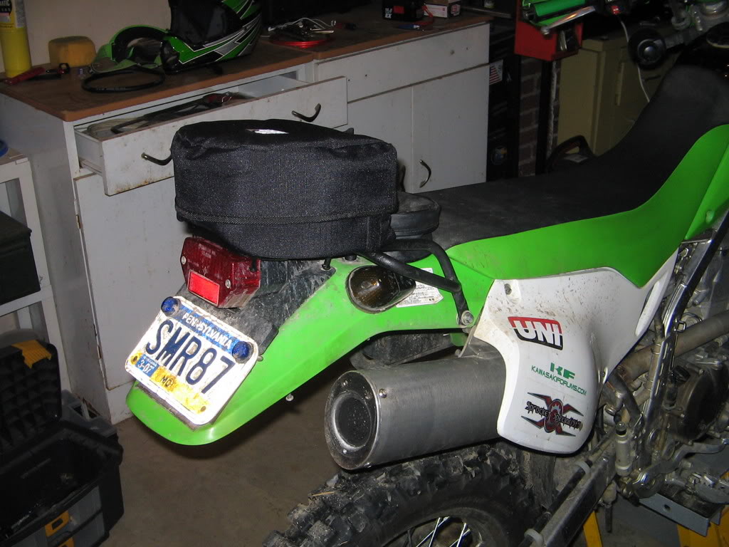

Moose handle bars and handguards
moose fender bag, acerbis light and flush mount signals
