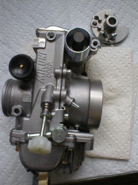

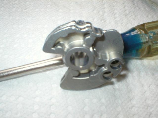

kawboy, the TM36-68 is about as plug-and-play as you can get. Grinding or cutting off that part of the throttle wheel for bigger gas tanks isn't hard to do at all. That wheel rides on a shaft, and you can remove it to have full access to cutting/grinding that return cable part of the throttle wheel. I removed the wheel on my TM36 and chocked it up in a vise with wooden teeth. Between a dremel tool and my bench grinder, I removed the necessary material easily.
On how big a carb you can run on the KLX, I think you can run the 36 even on a 250S with no issue as long as the airbox and exhaust are modded like most of us do. With a 300cc or bigger cylinder, I think it's a no-brainer on performance enhancement. I absolutely love this carb on my 250S with a 300 cylinder. Power delivery was improved all the way through the powerband. It responds and accelerates so much better, and even WFO throttle screams. It also lugs down better at low rpm than the CV, which surprised me. And...fuel mileage was not affected and maybe even enhanced a bit.

Yes, I used the stock pull cable and removed the return cable. I just plugged the open return hole in the throttle housing with a rubber plug. I had enough pull cable housing slack to use the stock cable in the stock position. However, I found that by flipping the throttle housing 180 degrees to where the cable exits from the bottom, it yields more slack and keeps the cable on an even lower profile to perhaps help with branch snagging. This method would allow you to use the stock cable on higher bars and/or risers, though I don't know just how far you could go with this slack. My Acerbis tank requires that you have some decent cable/housing slack.
